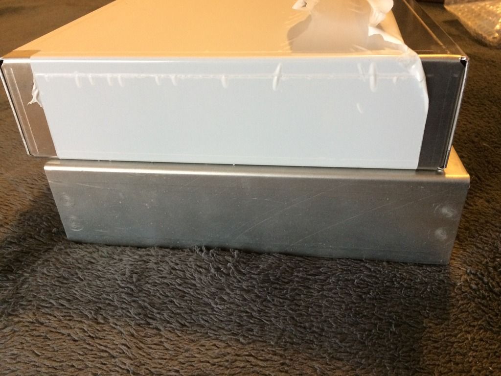

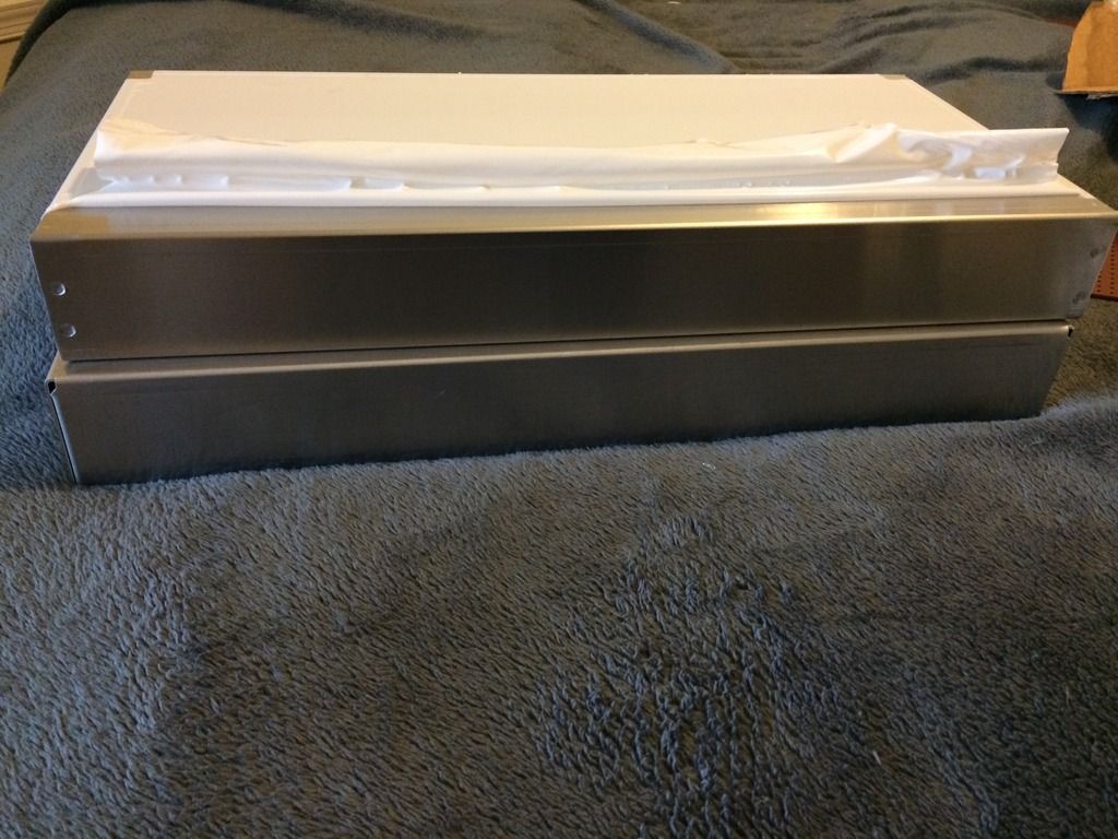

Post by RockinRocket » Thu Jul 27, 2017 1:20 am
I received the Bud replica chassis from Rj and they are very close to the original Bud chassis Ken used in appearance and spot on in thickness. The only real discrepancy I see are the corner folds and welds are one the wrong side. Also the inside of the chassis has a lot more scratches than Buds chassis. Out side is scratch free like Buds but still has the fold marks like Bud.
Heres some comparison photos. Replicas with plastic on them.
RJ Guitars
Posts: 2623
Joined: Tue Nov 14, 2006 3:49 am
Location: White Rock, New Mexico
Re: New Price -- Original Specification Trainwreck Chassis
Post by RJ Guitars » Fri Jul 28, 2017 2:54 am
Thank you RockinRocket for the direct comparison of an original. I am looking forward to the first completed amp from these boxes... will the chassis itself influence the sound that comes out of it??
I do like the plastic coating on the boxes. I seem to have terrible luck with machine shops scratching up the outside surfaces during processing so this helps to keep things looking nice.
