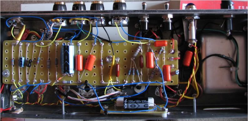

Hi guys,
I was hesitant to even post this here because by comparison to most of you guys builds it does not begin to compare.
After seeing Rawnsters Big Bottle Rocket and RJ's I had to give it a try.
But this was a "build an amp from what you have on hand" type build.
I did have to buy the choke from AES and a handful of caps and resistors.
But I had the circuit board, eyelets, etc.
It has the Rocket front end and PI.

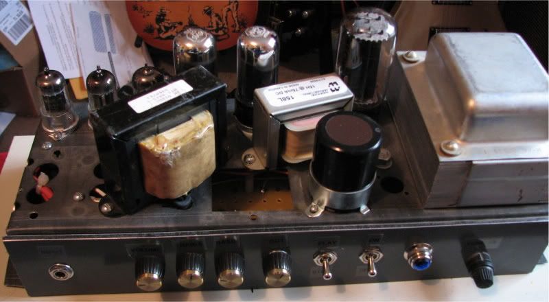

This was a late 50's Hammond organ amp that I gutted and originally I built a 5E3 type amp in it. It has a nice set of Sylvania 6V6GT's and RCA 5U4 rect.
Later it became more of a Plexi type circuit.
This time around it has a Rocket preamp and PI.
This chassis used to be 21" long, but using tin snips and a hand brake I shortened it to 14". In hindsight I should have made it longer........
I had to add a 12AX7 so the tubes are very close.

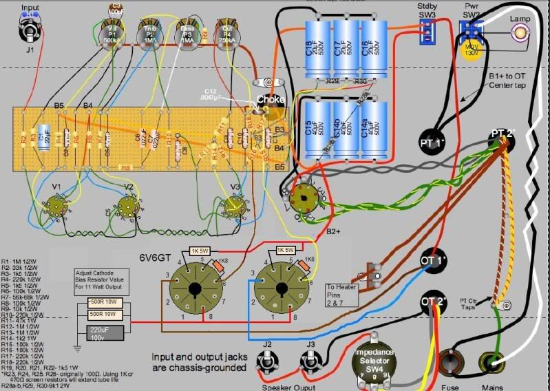

Anyway, the power supply is quite a bit different using a 5U4 and a JJ cap can, the B5+ filter cap is on the board because there wasn't any room elsewhere.
It is very tight in there and it was like working in a sardine can. :lol:
It took me a while to get the preamp voltages down to Rocket spec, at first it didn't sound good at all. Sputtering, motorboating, etc.
But once I got the voltages close it became a different amp.
I am loving it, quite a departure from my D'lite or the Marshall I have.
Even with the close proximity of the parts, tubes and inductors, this amp is pretty darn quiet and only hums when I have a single coil guitar plugged in and the volume is turned up high.
This is a steel chassis so I tried to tie all of the preamp grounds to the same point near the input.
Of course the power supply section in this amp is different from the Fischer Rocket. No stack of caps and the dropping string is different because of the PT.
The OT is the stock D'Lite OT with the 8K primaries wired to the 6V6's.
Eventually I think I will build a proper Rocket with reverb inside and nice new aluminum chassis. :D

That looks like the Lowery organ amp chassis I have my 6v6 Rocket in. Tight fit. I have a can cap mounted on top. I have it in a 1-12" combo.

Thanks for the layout you modified as well.

Something else I was wondering about, it seems that with this amp, even though I have 1K screen resistors and the choke between the plate and screen nodes, that the screen voltage is hardly lower than the plates on the 6V6's.
Is that common with 6V6 or is it just the way the Rocket power supply works?
Thanks, Tom

Structo. I'm liking my Rocket this time with a pair Sylvania 6v6s I bought from Mr. Kilgore. "greasy" is how he described them. I tried it once before with JJs but these sound much better. I've had that same experience with the screens being one volt below, above, or the same as the plates when using KT66s.
