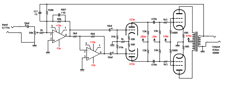

Got hold of an old eastern European poweramp named Audio Elektronica Grand 300. The back says 300W into 4ohms, can't confirm this. The output tubes are eight 6P44S and the double triode is a 6N6P. Its working except for one output tube and they are not very well matched either. I have new ones coming. Drew up schematics of it (May have some errors apart from the unknown components):
[IMG:799:300]http://i94.photobucket.com/albums/l96/s ... 0Schem.gif[/img]
[IMG:800:520]http://i94.photobucket.com/albums/l96/s ... d300PS.gif[/img]
The 6P44S should be close or identical to EL500/504. Anyone have any experience using them in audio circuits? Is 575v on the plates safe? How hot can i bias them?

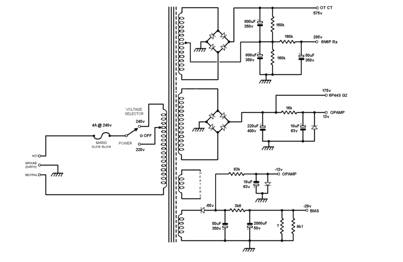

The first filter caps in the B+ rail is a total of 400uF and the second filter in the bias supply is 2000uF... pretty hefty?! Any disadvantages with this? It's going to be used as a bass amp.
I will build a preamp for it. What kind of stage would you guys put as the last stage in the pre-amp?
Thank you!

Russians seem to be fond of tetrodes. I can't find any datasheet for 6P44S, but this link suggests they are similar to a 6P45S

Thank you! Unfortunately the datasheets are only for their designed use not audio circuits (I think, can't read russian). I guess I'll have to trust the designer of the amp that 575v is safe. And I'll bias them pretty cool first just to be safe. An EL504 is rated at 24W max anode and screen dissipation. I measured the screens and they draw almost nothing in idle. So maybe 15W or even less to start with. They are biased between 8-14W now.
So any comments on the filtering? They date from 83-90 so I'm going to do a recap. I can find 680uF caps for relatively cheap. I'm not used to this high filtering though? And the bias cap of 2000uF, is that what I should get?? What do you think?

Oh yes, forgot to ask. Looking at the PS the centertap of the HT winding is connected between the two reservoir caps and the bridge rectifier is referenced to ground. Can someone explain this?

That's a voltage doubler.Hellhammer wrote:Oh yes, forgot to ask. Looking at the PS the centertap of the HT winding is connected between the two reservoir caps and the bridge rectifier is referenced to ground. Can someone explain this?
It seems the Marshall Majors were constructed the same way:
http://www.drtube.com/schematics/marshall/200w.gif
- Posts: 14057
Re: Grand 300
Actually, not. It's a full-wave bridge (in the case of the Major, two bridges in parallel to share the current). The center tap of the HT is cleverly used to make sure that the voltage is split equally between the series-connected reservoir caps.DonMoose wrote:That's a voltage doubler.Hellhammer wrote:Oh yes, forgot to ask. Looking at the PS the centertap of the HT winding is connected between the two reservoir caps and the bridge rectifier is referenced to ground. Can someone explain this? It seems the Marshall Majors were constructed the same way: http://www.drtube.com/schematics/marshall/200w.gif

Yes I can see how that would work. The bleeder resistors should already divide the voltage equally though?martin manning wrote:Actually, not. It's a full-wave bridge (in the case of the Major, two bridges in parallel to share the current). The center tap of the HT is cleverly used to make sure that the voltage is split equally between the series-connected reservoir caps.
Any thought on the filtering? Should I go with close to original values?
