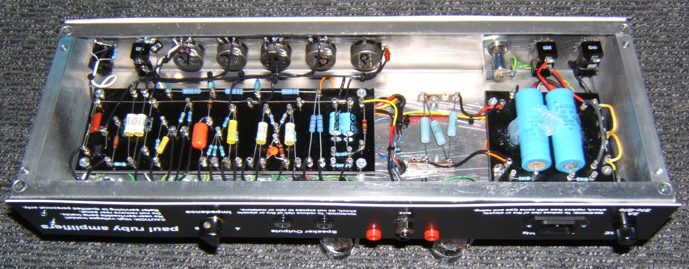

FYI... I've used 1k 10W in some builds, which are fine, but they run very hot and need plenty of air space around them. On this particular build, I used three series 330ohm 5W each to get air space:
http://www.paulamps.com/MartaGuts.jpg
I originally had a 1k 10W on the black turret board and it got hot enough to blister the board! No way could I leave that sitting next to the filter caps. You can tell from the wiring that the terminal strips were a later add and you can see the wire jumpers up to the power supply board.
A 25W resistor will run cooler and last longer but still will be putting out just as much heat (power dissipation is the same) so you still need some air space around it.
