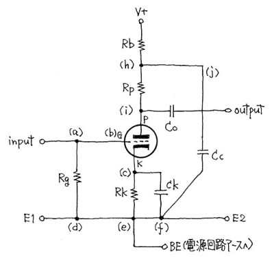

Circuit paths not shown in the schematic:
Suppose a one stage amplification circuit as shown below (plate follower, cathode biased). Normally, we are in the habit of thinking that the input signal that goes into the grid is amplified by the triode and shows up at the plate. (diagram 1)
If we want to consider the grounding, this is obviously not enough. If we go further, we end up w/diagram 2.
The signal applied to the input travels the path of:
(input)-(a)-(Rg)-(d)-(E1).
The voltage across Rg is applied across (b)-(f), however since the presence of Ck puts (f) and (c) at the same potential in terms of AC, the input signal voltage is applied between (b)-(c). So the signal current path travels along (input)-(a)-(Rg)-(d)-(E1).
As you should be aware, when the signal voltage is applied between (b)-(c) IOW between G-K, the plate current changes as the input voltage changes. The DC component of the current flowing through the plate travels the path of:
(B+)-(h)-(Rp)-(i)-P(triode)K-(c)-(Rk)-(e)-(BE)
When there is no signal present, this is the only current path that flows through the plate.
However, when an AC signal is applied between G-K, this AC component tries to travel the path of
(B+)-(h)-(Rp)-(i)-P(triode)K-(c)-(Rk)-(e)-(BE), but since Rk is shorted AC-wise by Ck, the AC component tries to travel through Ck and not Rk. Also, since (h)-(g)is shorted by Cc, the AC component does not travel towards B+ but through (h)-(j)-(Cc)-(g)-(f), so therefore the AC component of the plate current forms a loop of:
(i)-(Rp)-(h)-(j)-(Cc)-(g)-(f)-(Ck)-(c)
Since the input voltage amplified as the output AC current develops a voltage across Rp, the loop to tap into to obtain the AC voltage is:
(i)-(Co)-(output)-(E2)-(g)-(f)-(Ck)-(c)
To summarize:
-the input signal voltage loop: (input)-(a)-(Rg)-(d)-(E1)
-the DC component of the plate current: (B+)-(h)-(Rp)-(i)-P(triode)K-(c)-(Rk)-(e)-(BE)
-the AC component of the plate current: (i)-(Rp)-(h)-(j)-(Cc)-(g)-(f)-(Ck)-(c)
-the output signal voltage loop: (i)-(Co)-(output)-(E2)-(g)-(f)-(Ck)-(c)
The key is to wire the grounds such that these four loops don't interfere with each other as much as possible. When the grounding is incorrect, the loops end up interfering w/ea. other leading to the impression that grounding is complicated. Now let's redraw the circuit as follows.(figure3)
Notice that in the diagram(fig.3) no current flows between (d)-(e) and (e)-(f). This is the true nature of ground. No currents flow in the ground, or you could say that the builder should not allow currents to flow in the ground (by mis-wiring, or incorrect grounding).

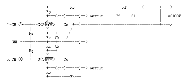

Stereo circuits and grounding
Let's look at fig.3 from part 1. Fig.3 is in monoaural configuration.
What should be done when the circuit is a stereo configured circuit? Should the grounds be separate for left and right, or should they be shared? The first problem the builder encounters is how best to ground near the input circuit. Take a look at fig.5 below.
Say an amp output was connected to a stereo configured input stage using the circuit shown in fig.3 for the left and right sides. The previous amp's output has separate L-CH and R-CH outputs, so when connecting these outputs to our input stage (using the fig.3 in stereo circuit) the grounds are split into two before reaching the input stage. The separate ground paths are (a)-(b)-(c) and (a)-(d)-(c).
So we encounter a very incongruous situation. What was previously a single ground has now been split into two. In part 1, it was written that a signal has a send and a return. Now, is the L-CH return path (c)-(b)-(a)? Yes, but this isn't the only path you see is it? The L-CH signal return also travels through (c)-(d)-(a). Likewise for the R-CH signal. Weird, isn't it?
This is a problem inherent to unbalanced circuits, and however incongruous it feels, one can only do but tolerate this condition. To correct this condition (where the left and right channel share the ground), the circuit would have to be made into a balanced circuit so the signal send and return and ground can be separated--that is the only way to correct the condition where both left and right signal return paths are mixed together through a shared ground. In an unbalanced circuit the left and right channels must share a common ground. Therefore, (the return paths for the left and right signal outputs) must be tied together at (c). (However, the situation differs significantly for a mono configured amp.)
Furthermore, the parts of the ground line (a)-(b)-(c)-(d) form a physical loop. If (in a situation such as this) the magnetic flux lines from the power transformer intersect with this loop, the loop (since it is a loop) acts as a coil and this can result in hum induction from the ground line itself (through induction). (The hum induced here is proportional to the loop area.) Therefore, the two cables must be kept as close to each other as possible. They can pick up hum (have hum induced on them) just by physically separating them and making a loop. The primary principle is not to create a loop with the ground line. If this cannot be avoided, try to keep the loop as small as possible.

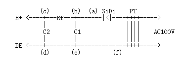

The return circuits for the power supply:

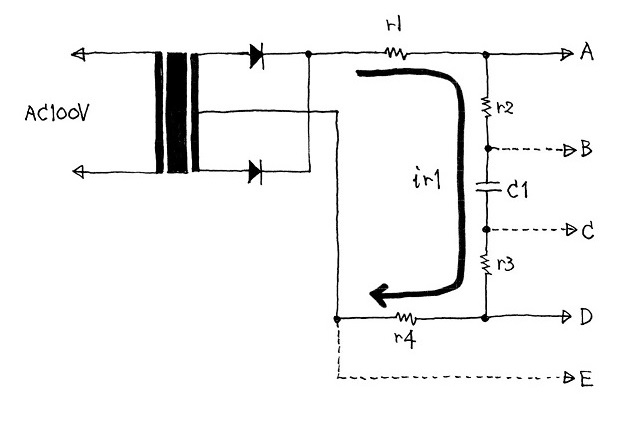

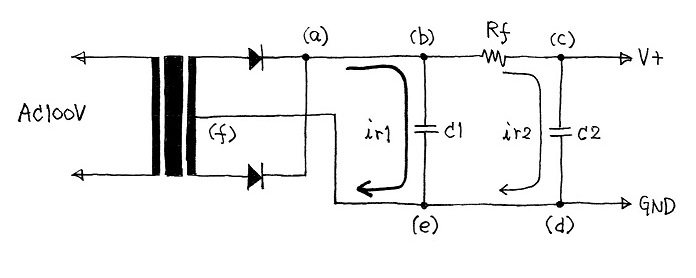

Now let's think about the send and return path for the currents in the power supply. Take a look at fig.6.
The AC coming from the power transformer goes through a rectification circuit (in this case a half-wave rectifier using one diode) into C1 which is part of the first ripple filter. C1 experiences a significantly large amount of ripple current. This ripple current travels through the loop of:
(a)-(b)-(C1)-(e)-(f)
Next, it travels through ripple filter Rf and C2. The residual ripple that was left after going through C1 is bypassed to ground here, so C2 also experiences a large amount of ripple current. This ripple current path travels through:
(b)-(c)-(C2)-(d)-(e)

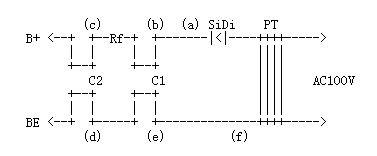

In order to effect ripple removal most efficiently from this two stage ripple removing circuit, how should things be wired? C1 and C2 serve to remove ripple by shorting the AC ripple to ground. And since resistance exists in wiring (although it is very small), a voltage drop takes place between (C1)-(e) and (e)-(f). Therefore, re-drawing fig.6 into fig.7 and wiring as shown in fig.7 makes for the most effective ripple removal.
The portions of the capacitor leads closest to the body is the place where there is the least ripple. As one moves further and further away from this point due to the resistance of the leads, one will find more ripple. There is in fact a difference even along the points of the same lead. Copper wiring used for building amps typically has a resistance of 30 to 150 milliohms per meter. Therefore, that makes for approximately 3 to 15 milliohms for a 10cm length of wiring, and if 100 milliamps of ripple current travels through this line, an AC voltage drop of 0.3 millivolts to 1.5 millivolts takes place. In a ripple filter circuit, although (d),(e),and (f) may appear to be at the same potential, they are in fact not at the same potential.
In fig.7, the immediate ends of C2 experiences the least ripple, so that is the point where the power should be supplied to the amplifier circuits. The ground points further upstream of (d),(e),and (f) are being made unstable by the ripple voltage, and are therefore not suitable to be considered reference points. The correct points from which to supply the power to the rest of the circuit are (B+) and (BE). Looked at in this way, one can see how problematic it can be to star all ground points to a power supply capacitor ground. Such a practice is a vestige of the radio era, where a single multi-cap sufficed for the entire circuit, and is not suitable for a modern high fidelity stereo amp.
Summary:
The previous points are summarized as follows in fig.8.
1) The points where both channels' Rks (cathode Rs) and Ccs (de-coupling caps) are grounded should be shared and be made short and w/thick wiring.
2) Individual Ccs should be used for each channel. Do not use a single Cc for both channels.
3) At the point of C2, residual ripple should be well removed.
4) Do not use the ground line from C2 towards the PT for ground points
These are the main considerations. These basic ideas should help prevent hum due to incorrect grounding as well as decrease L/R ch. crosstalk and help to improve other amp specs as well.
As can be seen, deciding how to place grounds and run them can be quite complicated, so the method of placing a main bus line in the center of the circuit is often used. However, even if a super thick low resistance buss is used, if the order of grounds are incorrect, or if a large amount of residual ripple is flowing at a particular ground point, or a ground loop is created, there can still be problems with this method.
Also, a single star grounding method, which tries to do away with getting the order for the ground points correct by bringing all ground points to a single point exists, but it is not physically possible to place all grounds in one spot. If all ground points are placed in one location, this means that very large ripple current points and highly sensitive ground points all share the same location. Some ground points are better placed at one point, but some should not be.
The bus grounding method, and the star grounding method are just different styles of ground placement. Far more important is to understand the mechanisms involved in grounding. When the mechanisms are understood, one does not have to blindly follow a buss or star configuration.
Summary:
