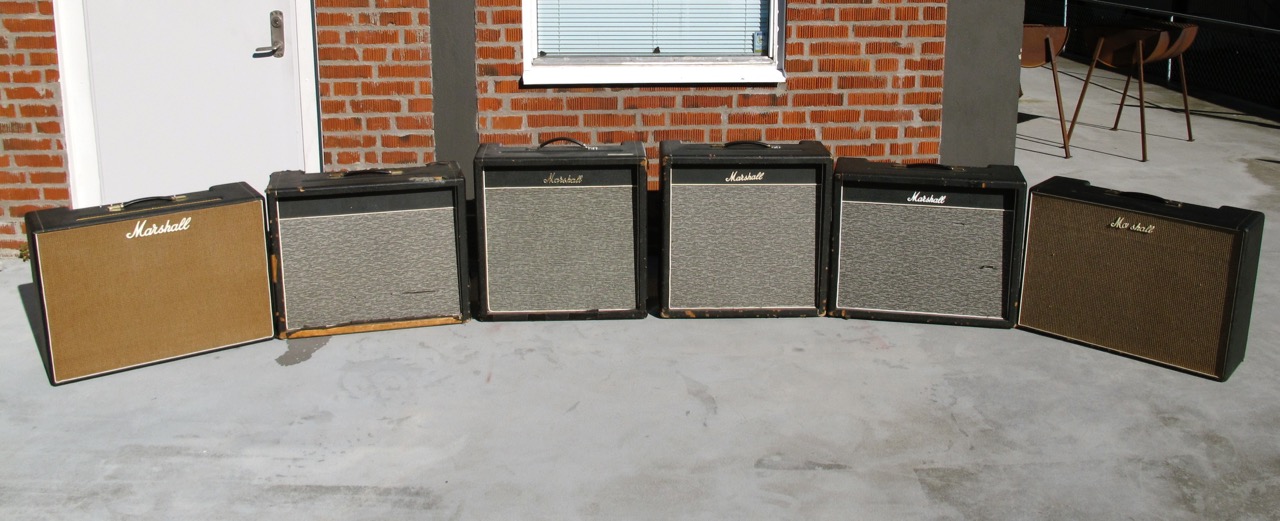

Looking for Marshall 1961 combo cabinet dimensions/plans.
Hey all,
Planning on building a 4x10 bluesbreaker combo for my rebuilt chassis. Anyone own a 1961 and can take measurements? Or have built a replica combo cab?
They’re the square cabs in the middle of the picture below.
Thanks kindly!
