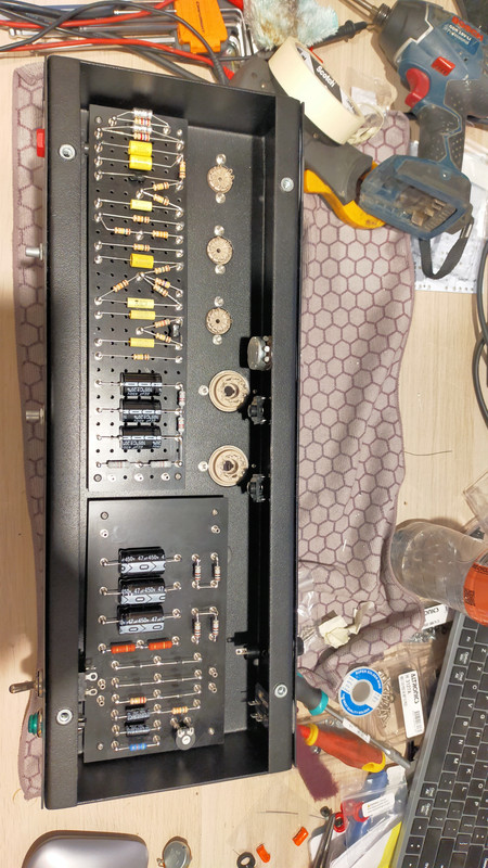

It's been a while since I built anything but thought I'd throw another amp together for fun. Express style build with a few choice tweaks. Forgot how much fun this is.

Looks great! Super clean.

Trying to use up parts I have lying around so there are a few changes. I'm using an Antek toroidal PT so I'll get 285-0-285 which is close enough. I have a 3k4 Plexi OT which I can either use properly or mismatch the output impedance to get close to the original primary impedance spec.
Only thing I don't have and can't find locally is the 1k 25w resistor. Seems a bit overkill based on my rough calculations but I'm not paying $30 shipping on a $3 part to get it to Australia. Lol.
