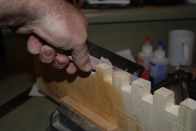

I love the look of finger joints - I hate the uncertainty of fitting wood together to a complete 'grounded' joint. Currently working on a white oak 2x10 that utterly defeated me last night in two different attempts to glue and beat the joint to together. A bonfire was REAL tempting - while much naughty wordage was mumbled. Disassembled and glue wiped away I fled the shop in defeat. I thus contemplated my wood working navel for the rest of the evening.
Modifying finger joints has been a trial and error - mostly error - as alignment of the file/sandpaper stick/milling machine was critical to joint happiness. The marginal results required slivers of wood [oh how I hate those fiddly bits and slices] or lately the opportunistic [some call it lazy] application of epoxy - still not a solution I was willing to accept.
So here I am in my madness yet again tempting the wood joint gods to smote me. They did.
Sanding seemed to be the best method to remove minute amounts of wood in a controlled fashion. I tried hot gluing sandpaper [150 grit] to two sides of a piece of wood. It would just press fit into the joint requiring a rocking motion to seat into the cut. I noticed two things - the sanding stick cut it's way into the slot and the tight fit kept the stick aligned. Promising until I ran out of glue sticks. No stores open this late at night so I had to wait. Can you believe that Lowe's had the gall to not open their doors to me until 8AM!
Wandering about as I usually do I noticed they did not have the glue sticks in the glue aisle. They did have contact cement - a better solution as the glue thickness could be better controlled. They also had 1/2" pipe clamps. I have a pile of the quick grip style of clamps and they just didn't have the clamping horsepower I required to bend those ornery joints to my will. Like a fool I bought 2. I later went back and bought two more.
I cemented sand paper to two pieces of wood and with the aid of a 1/4" iron bar and some more sand paper shims joint dressing was in full swing. At this point two joints are sanded, glued and mashed flat. Are they perfect? No but they will require much less fixing - always a good thing.
For some my navel gazing revelation is old news but it is worth sharing. If you have wood working tricks/tips please share them - I know I need lots of tricks.

I use a table saw [no router - yet] and built a jig that cuts 3/4" fingers consistently. What I have found is most solid woods migrate when material is removed. I use highly figured planks 7-11" wide that are rarely flat or square and thus need additional 'help' to play nice in the joint area. Finger joints for me are a decorative features - not a structural necessity.
The ability to remove .002-.003" additional material accurately from the sides of fingers allows me to hand seat the wood to at least 80% - have never been a fan of bashing with a mallet.

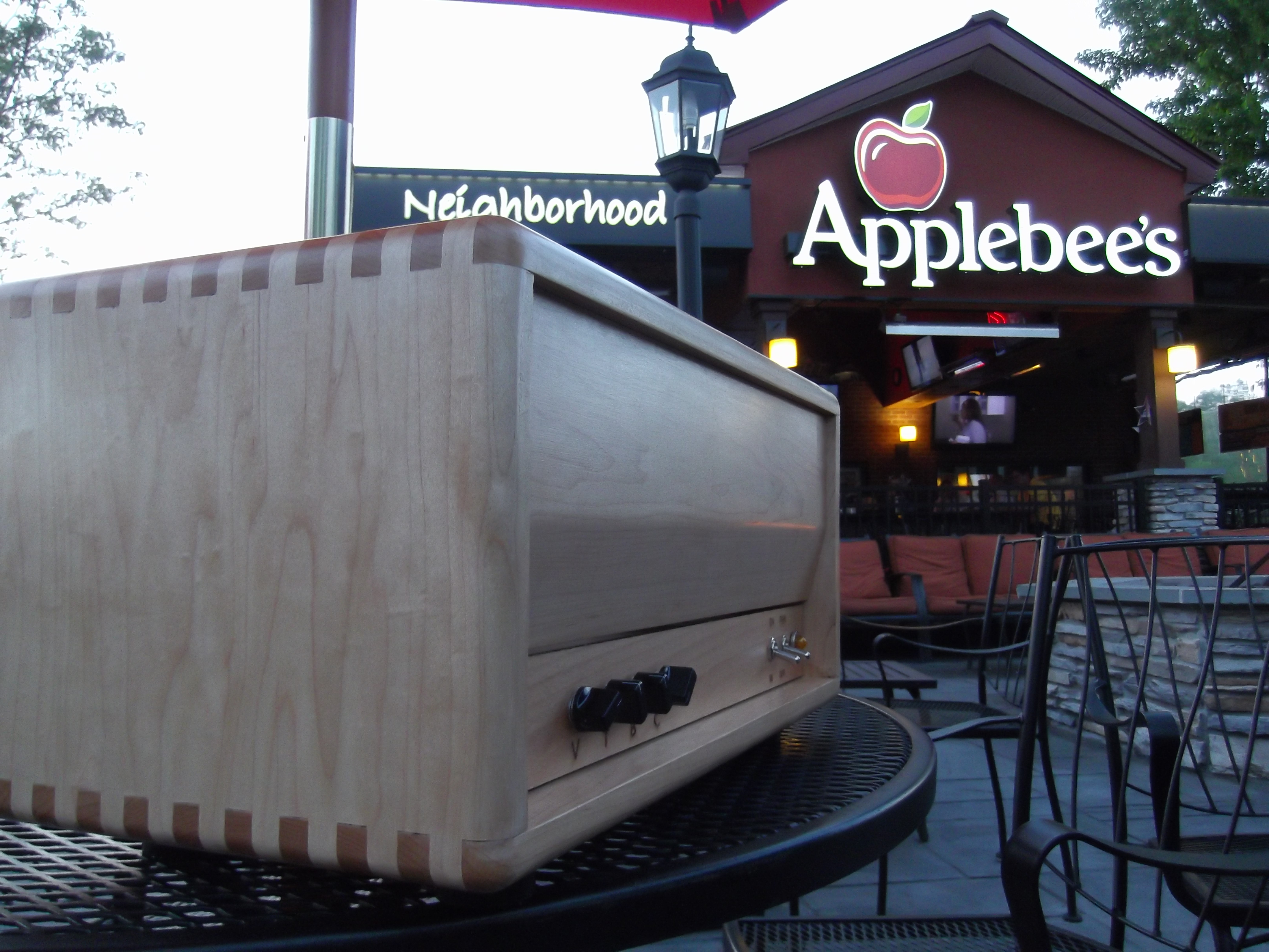

Thank you for all the great replies and information. Have you experienced that some woods are more joint-able than others?
Here is one of this weekend's joints fresh from glue up.

Finger joint
Maple- used porter-cable jig- did have to use a hammer to put joints together.
