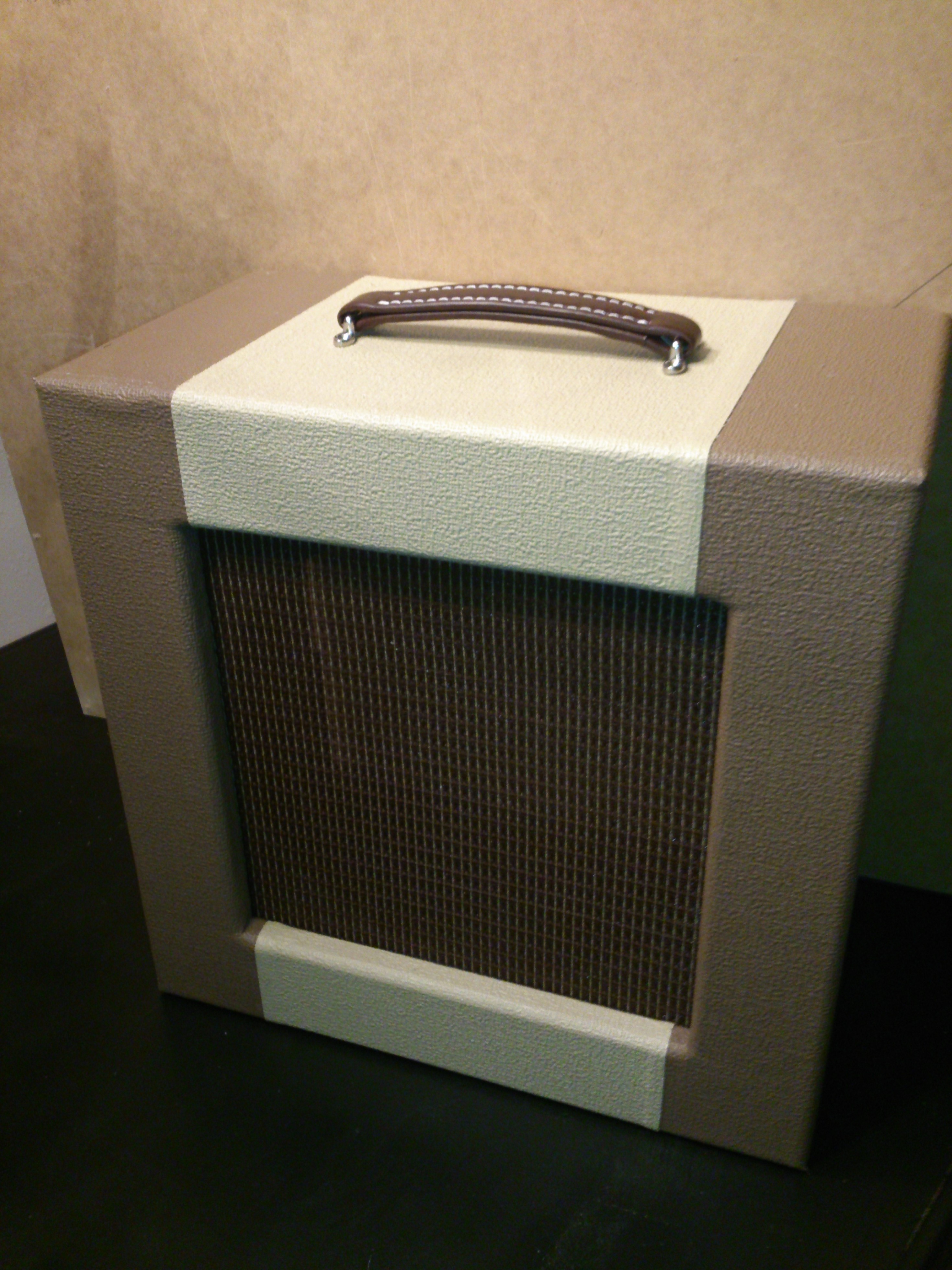

BTW I have no idea what I'm doing, this was a first attempt at two colors, and it came out pretty sweet, so go for it.
Note: I wouldn't use Weldwood spirit solvent based laminated adhesive here, or any glue that could soften the tolex and cause creep. You can hide corners under bumpers but not butted seems like this.

I found a bucket of vinyl floor adhesive at work. I've used it before installing flooring. In some of the videos I've seen on you tube it appears only the tolex has adhesive applied to it as opposed to the traditional methods of contact cement and that is how I've previously used this. I'm going to try a back panel today. I've had trouble removing vinyl flooring with a walk behind floor scraper when this stuff was used so it has good stickhesiveness!
Oh, yeah, it's water based to boot.

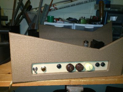

Well I've managed to get the top and bottom back panels done so I thought I'd post an update with a picture. I'm going for a vintage kind of vibe. I really enjoy the challenge of this kind of stuff. The adhesive I'm using is a vinyl flooring adhesive from a company called Karndean. I just apply it to the back of the tolex and let it skim. I've used it on flooring before just using a 1/16" trowel to apply to the subfloor and those floors don't move. I did find I need a pretty thick coat on the tolex. It is water base so clean up is minimal. Thanks again everyone who has helped guide me here. I'll post more pics when I get this thing done. :D

Looking really good. The style sort of reminds me of a George Jetson radio.

That looks cool Elk.
Love the retro-ness! :D

Well here it is in all its glory, LOL. I can see myself doing more of this. I just learned a ton of stuff on this one.
