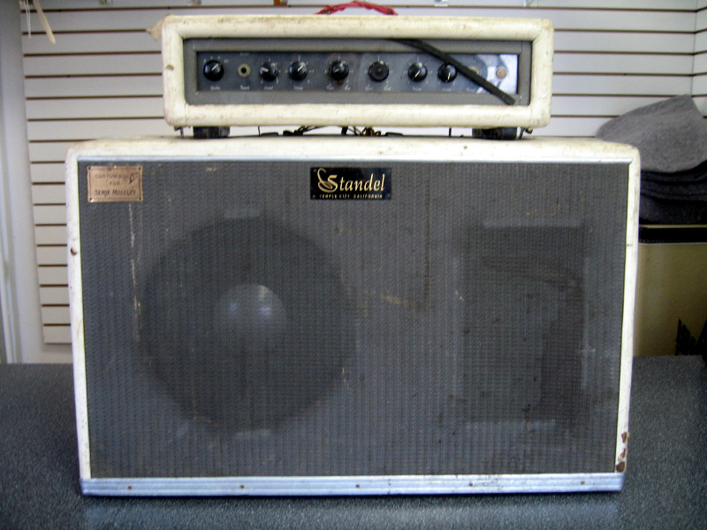

Standel made a cabinet based on a similar idea back in the late 1950's - early 1960's.
