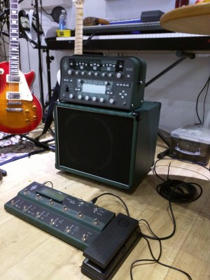

I've got one and I'm still not 100% sure about it in the studio( Mic'd) , I prefer the dumble style ported cab generally.
I've been using it with my Kemper with a little class D power amp.
I need to try it on bass I think.
It is a very compact design indeed.
