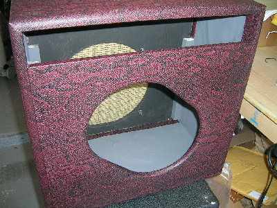

hello everyone I'm Simone
to coat with a round area tolex how can you make?
Re: Amplified Nation Tolex Tutorial
Not certain I understand your question. But I think the answer is, make small cuts in the tolex, and use a hair dryer to help form the material around the curves.
i've try but ...
this is my last job .
little cut tolex with under a piece of the same tolex , but reaaly i see the cuts
Looks like you may also have some air bubbles under the tolex.
You can use a roller when installing or later stick a pin in the bubble to release the air.
There is an art to this stuff.
thanks structu !
take a lookto the hole
in the upper side , there are the cut
there is a best method for toxeling cover rounded holes ?

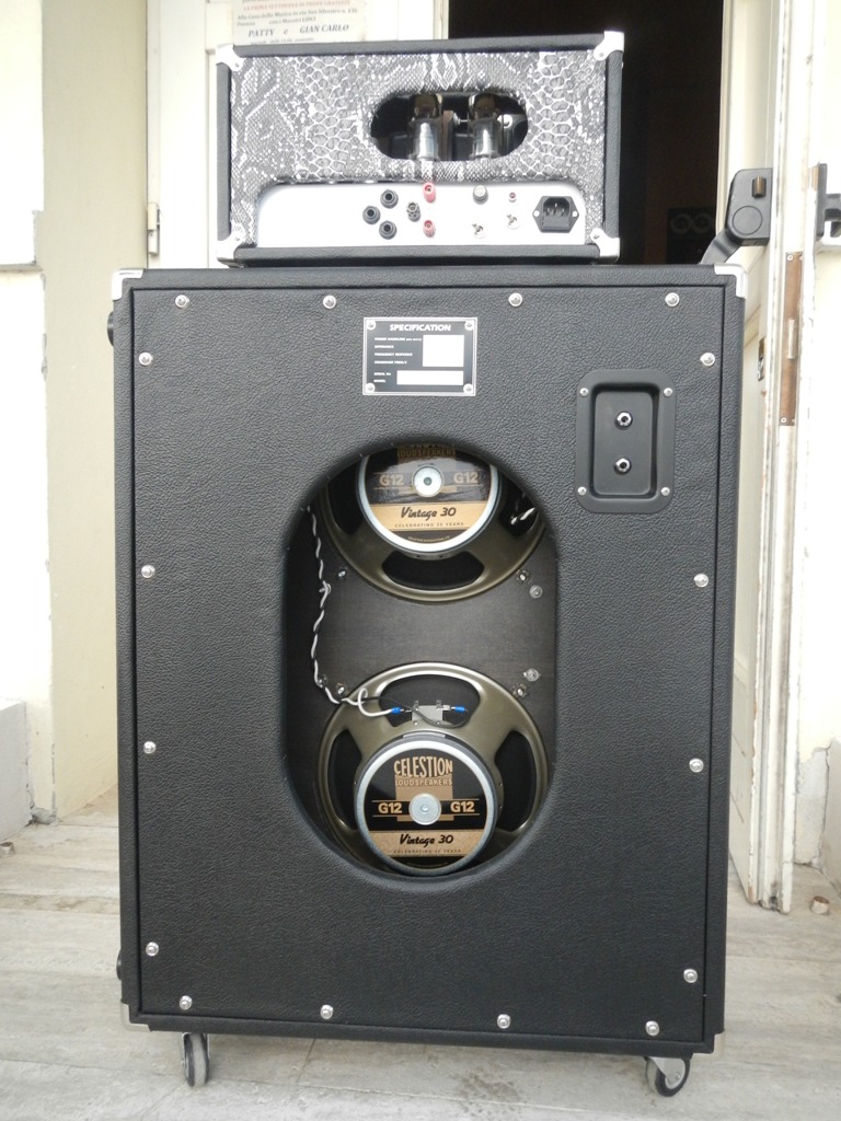

Nice video.
I too would like to see someone do an oval cutout. I have a TRM 3D cab coming soon.

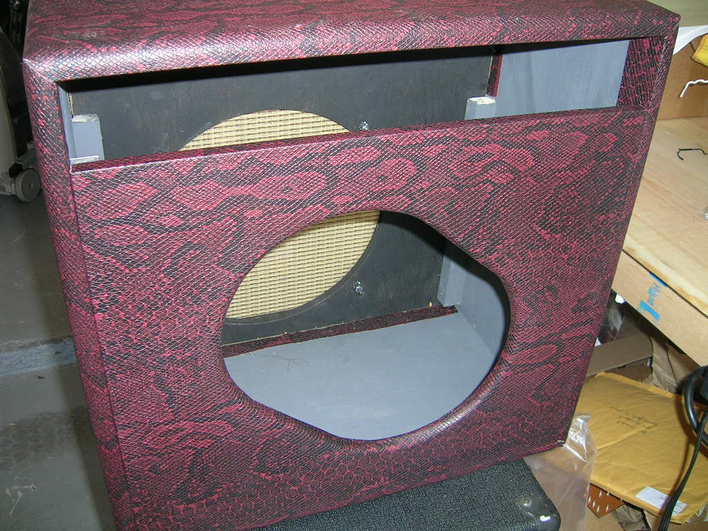

I think it helps to use thinner wood, here is one I did, seemed to be able to hide (most) of the flaws! Now if I could just get the corners round!
