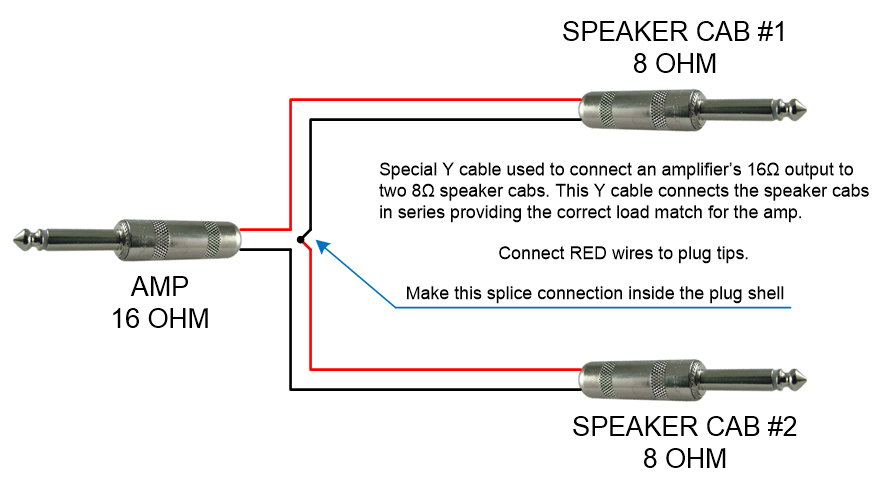

I have a simple Y cable that will connect an amp to two cabs connected in series. Might give you some ideas.

professormudd
- Posts: 405
- Joined: Thu Jul 16, 2020 6:53 pm
- Location: Southern California
Re: Seeking wiring advice for series out from a cabinet with speakers wired in parallel
That is pretty cool. Thanks.

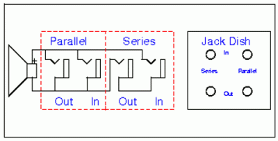

I have most of my cabinets modified with a jack plate containing four cliff jacks wired to allow me to connect cabinets in series or parallel using standard speaker cables. This is the lable I laminate and attach next to the jack plate:
It is important that the jacks are either cliff type (non-conductive) or insulated from each other in some other way.
On my 4x12 cabinets, I wire them up as 2 2x12s in one box and have two of these plates on each cab. That way I can run them with two amps as a pair of 2 2x12s or a standard 4x12 with one amp. It is a little funky. But the only thing I need to bring along is standard speaker cables. The funky adapters are built right into my cabs
Mike
P.S. To run in series amp -> series in -> series out ----- [to second cab] --> parallel in.
Mike
professormudd
- Posts: 405
That was exactly what I was looking for. Thank you.
