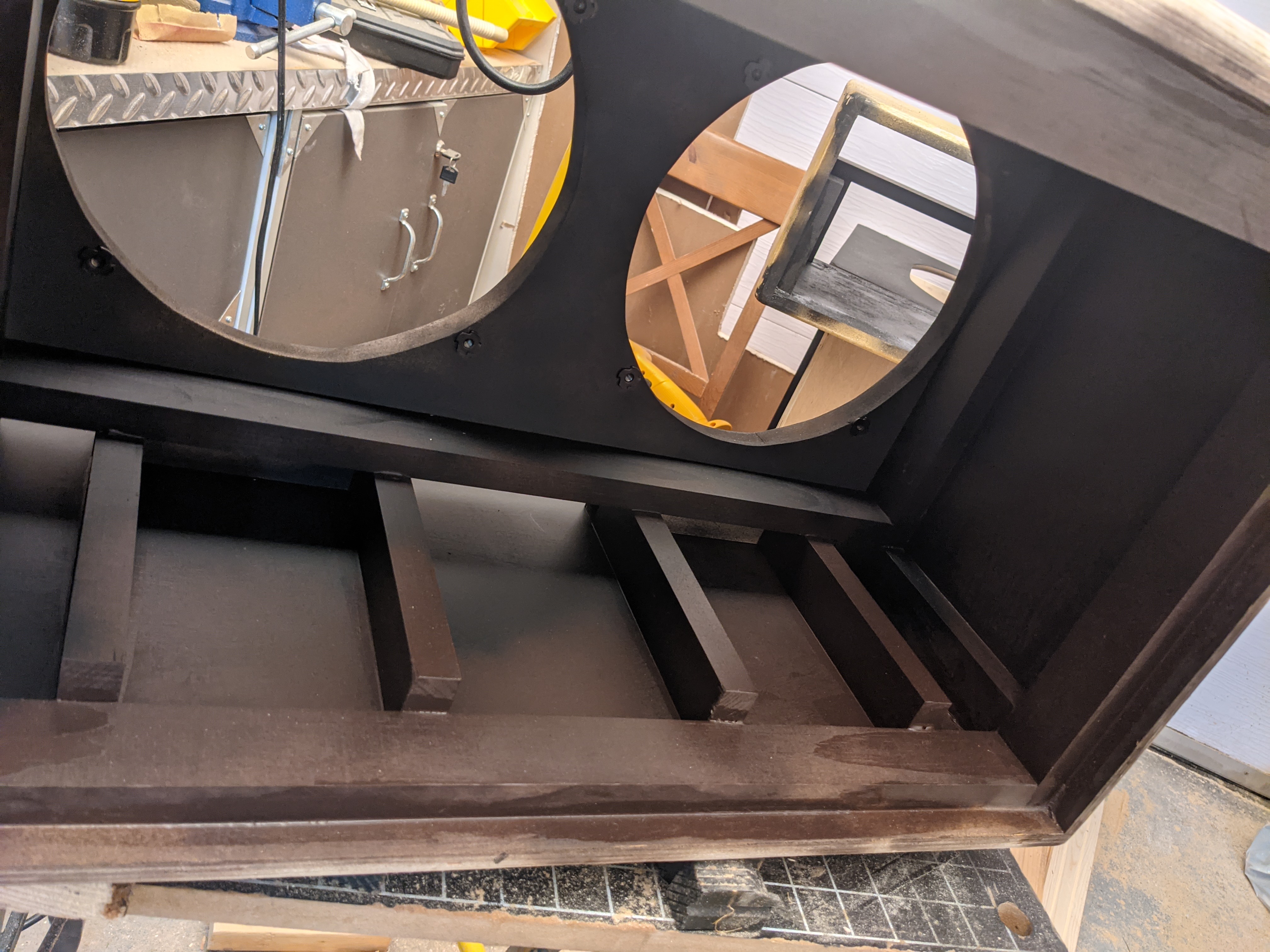

I have been busy the last two weeks completing a 2x10 sealed/ported cab with the EVM, and it is worth the work!
Color is seafoam green, but with the electric light, turns blue ;(
Made a mistake though : I did not keep enough space on the sides to build a grill cloth. So I may have to cope with a light metal grill. It is quite heavy, but the clarity is quite astonishing. Everything feels smooth and not harsh, but defined, even when pushing presence control to the max. Great speakers for sure!
I have almost completed a 1x12 for another EVM L so I will be able to A/B these.

What a beast!
Only 4 bolts per speaker?
Can't you just bolt the speakers from the inside and thus manage enough room for a grilcloth frame?
Of course you'll loose some inside volume but this lost might not be that much significant... if ever possible?

Haha @ChopSauce, I love your attention to details.
In the original Boogie Thiele cab, the EVM 12L had only four wood screws! I thought using using four good bolts should be good enough since they squeeze the speaker against the pannel.
Yes it is a beast probably 55-60 pounds (speakers are 20 pounds each...).
Good advice, I could tuck the speakers on the inside and then I would get enough space for a wood framed grill cloth. To be honest I don't know how important the ported thing is, because on the paper it seems to act on the knee of the low frequencies. Which as a guitar player don't care much.

fred.violleau wrote: ↑Tue Dec 29, 2020 3:24 am I have been busy the last two weeks completing a 2x10 sealed/ported cab with the EVM, and it is worth the work!
Happy Holidays!
Fred.
Fantastic Fred,
I made the same mistake on the first one I Built :D I did what @Chopsauce said and mounted them from the rear and made a frame for the grill cloth.
