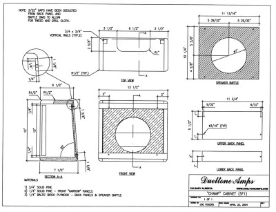

Hi All
I am new to the forum and happy to be part of it.
I have been building so far loads of Bluesbreaker style guitar cabinet trying to reproduce as much as I could to the original.
I have successfully succeeded on this by building single or 2x style cabinet or combo hosting 18 watts amp.
Now I want to build the little monster, the fender champ 5F1 I got the wood, the accessories the handle, and everything is needed including grillcloth and tweed.
Questions
I am looking for a project steps construction I could look at, I have some doubts on how the front panel baffle is made I want to make it as close as possible to the original.
Any videos or projects that can guide me are appreciated online to be honest I couldn’t really find what i was looking for.
I have already built a sample just the 4 lateral sides
If you need a photo I can attach it,

Posts: 14058
Re: How to build a Fender Champ 5F1 style CABINET
Mojojtm wrote: Tue Dec 21, 2021 8:52 pmI asked how to build a Fender Champ guitar cabinet
Fender Champ cabinet plans from the web:
Champ cab (5F1) DuelTone.pdf
(137.01 KiB) Downloaded 1188 times
Mojojtm
Posts: 73
Joined: Wed Dec 15, 2021 6:09 pm
Location: Hoofddorp, Netherlands
Post by Mojojtm »
Thanks a lot that helps

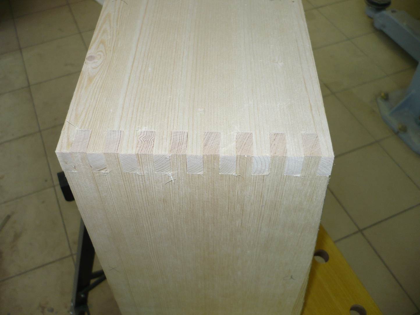

Mikante
Posts: 209
Joined: Fri Oct 29, 2021 7:07 pm
Location: Italy
Post by Mikante »

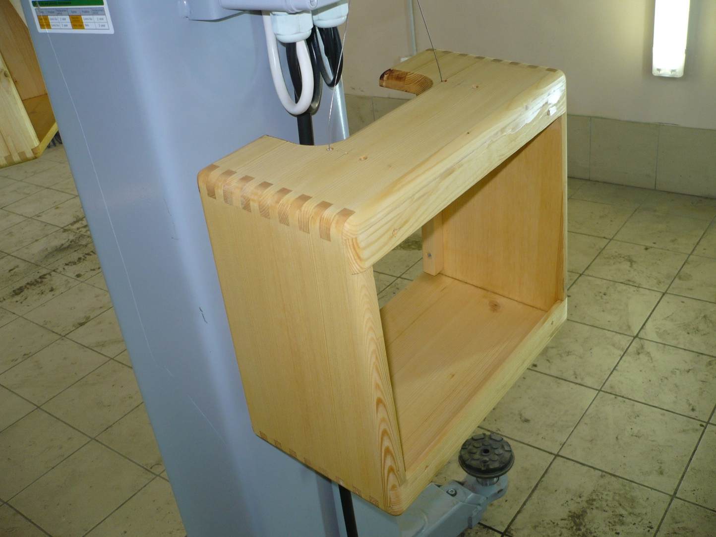

Hello, i m building the same cabinet, just larger enough to host a 10 inch speaker.
I wouldn’t care about the finger joint, a simple dado/rebate on each side, some vinylic glue and clamps.
You ll get the same result and there is no benefit in terms of vibration going for the finger joint which is in my opinion purely aesthetic and probably a better choice only if you decide not to use the classic tweed tolex to cover the cabinet.
But this is just my advice on the construction method that you might want to take into account.
The plans that Martin provided you are what you were looking for.
I would add a couple of screews in the middle to have a better connection between the cabinet and the baffle.
I d like to see your work in the process of making it.

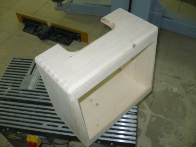

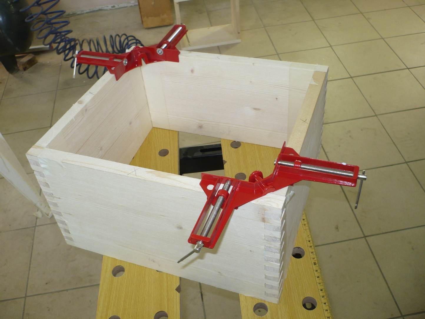

alkuz1961
Posts: 179
Joined: Sat Mar 03, 2012 3:32 am
Post by alkuz1961 »

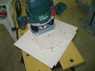

I remembered that a long time ago I also collected Champ, and I still have photos of the build, step by step. I think it might be useful to someone...
alkuz1961
Posts: 179
Post by alkuz1961 »
continuation

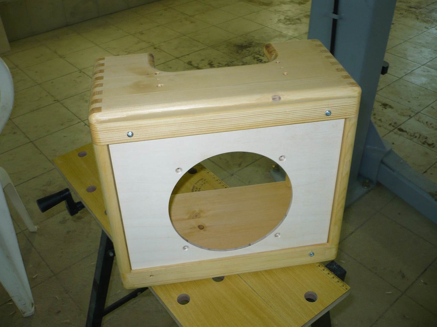

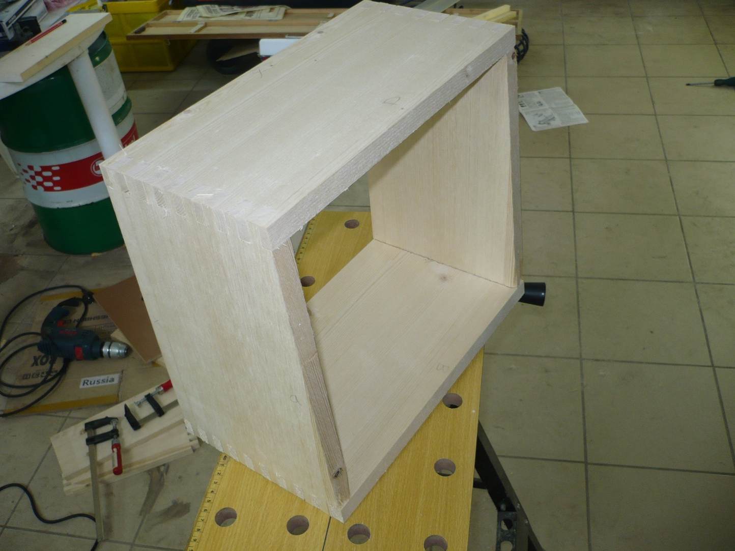

alkuz1961
Posts: 179
Post by alkuz1961 »
and a little more
alkuz1961
Posts: 179
Post by alkuz1961 »
It's almost over )))
