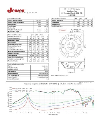

I want to build a 1x12 cab for my jensen jet tornado 100, i d like to use the tl806 plan but i know that a ported cab must be carefully planned.
There is a program to calculate the cabinet volume and vent area, this one
http://www.linearteam.org/
I don t have a pc and i was wondering if any of you already used this program.
Here the speaker specs

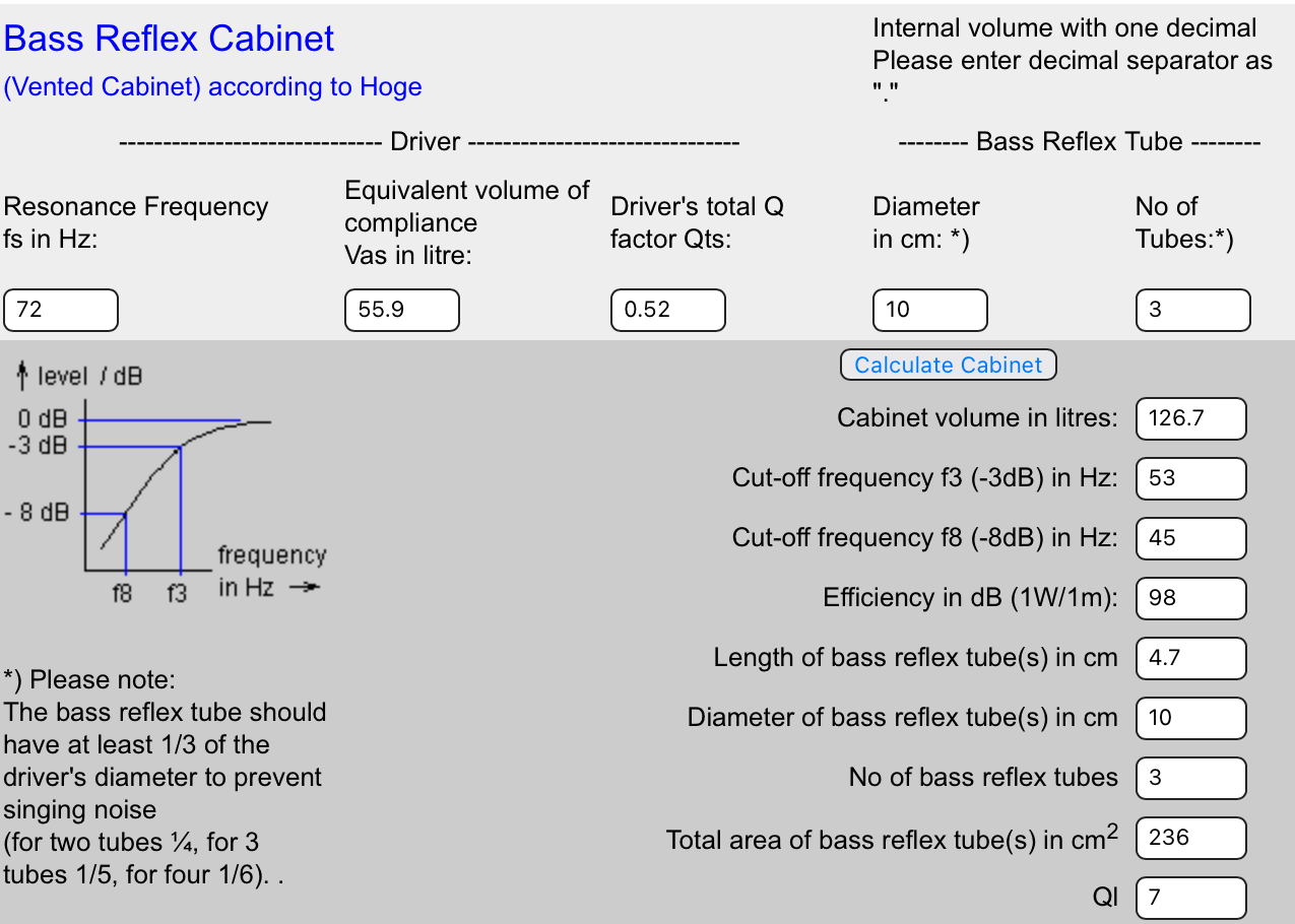

I did, i also found an online calculator, and here is the result
I understand i can now come out with the measures of the cabinet to match the volume. What i don t understand is the vent, in the result it is shown as a sort of pipe, while on the tl806 there are three chambers underneath the speaker.Re: Tl806 ported cab with different speaker

I know, with the vent cover on, the cabinet is tuned around 55hz, without it is tuned around 70hz.
One thing i don t really understand. When i do the calculation according to my speaker specifications, the cabinet volume suggested by the program is almost three times bigger than the tl806, 127 liters to be precise.
The program uses thiele-small parameters, so how did they do the calculation?
I know that an hi-fi cabinet is different and it is designed to not alter the sound.
If i enter the evm12l speaker specifications the program gives me a suggested cabinet volume that is much bigger than the tl806 too.

Is the program calculating for a ported or sealed cabinet?
Also port size is a factor, what is the port size in the program compared to the tl806 port?

Hello, yes, the program gives you parameters for open, closed and ported cabinets.
About the vents, you can only chose the diameter, so it is for pipe vented cabinets.
The result is the drawing i previously posted, 4 inches diameter.

Another program, same huge cabinet volume result.
