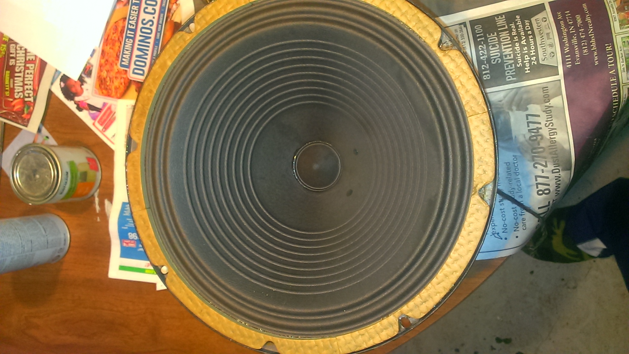

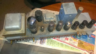

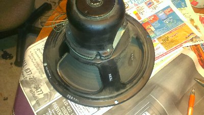

I have a Hammond PA and 12" here that someone brought to me just a couple of days ago... I don't know what it is yet. Been contemplating the Fluxtone idea for a few years now.
I'm thinking a VVR controlling the coil voltage would work just fine.
Pulling up a chair for this discussion.
Tony
Tony

Wow Tony,dorrisant wrote:I have a Hammond PA and 12" here that someone brought to me just a couple of days ago... I don't know what it is yet. Been contemplating the Fluxtone idea for a few years now.
Tony
That looks to be exactly what I'm looking for! If they actually all fire up, it would be fantastic to get some of the voltage readings, etc! If you would like to do a little collaboration on this endeavor, please feel free to PM me so that we could swap real email addresses and phone numbers. I'm fairly hot to go on this and have even joined a couple organ forums to ask some questions and "troll" for parts/components.
Thanx In Advance,
Gene
