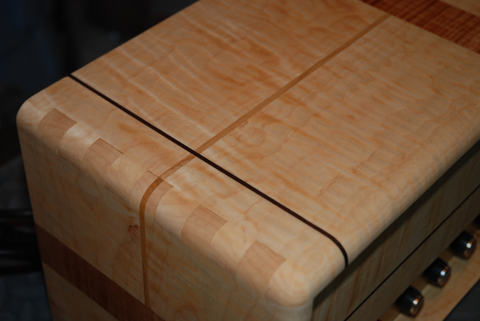

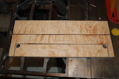

I found some wonderful [for Texas] curly maple for a 1987 that a friend built me. Walnut was used as the piping for a nice contrast. It has been a long saga as the holidays and my wood working buddy has fallen back into the hobby car - C5 ZO6 - and needed to sell of most of his equipment. Luckily I was able to purchase his dust collector and 16" drum sander without which this project would be dead in the water. The other interference was the start of my show season, 4 days in Dallas and a week in Lost Wages.
It was not without fluster clucks - used a cheap dado and one of the blades had warped and cut .030" wider [and thus narrower as well] fingers - much naughty verbiage was spewed. A decorative contrasting maple piece now split the sides and top as artful damage control. A carbide dado was acquired [my oh my, hot slippery sawing sex] which cut the best joints I've ever done.
From a lesson learned with purple heart, an amazingly sand paper resistant wood, I rounded the corners with 60 grit paper. Looks and feels like a gravel parking lot on a disk. Finish is my usual linseed / mineral spirits. The Marshall logo was primed and sprayed with the only brown I had.

Hi Boots, You gotta start somewhere - to quote my buddy who taught himself to built acoustic guitars from scratch said when asked how he was able to build such beautiful work - "Because I'm willing to f**k sh*t up on the way to getting there'. My first cabs were ugly and out of square but have xome a long way in 19 cabs to date.
I am happy to answer any questions and share the small wealth of knowledge I have accumulated or outright stole!
