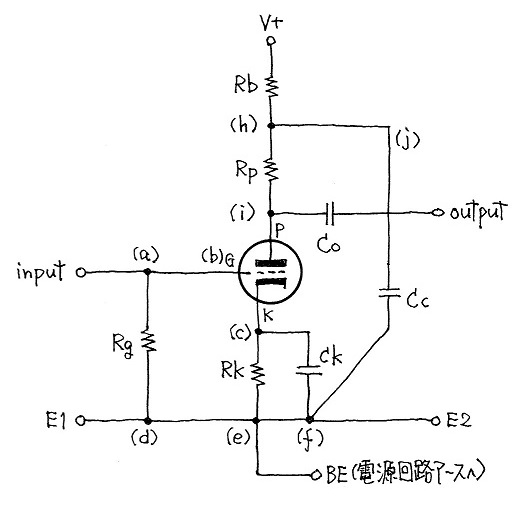

Hi all, FWIW I updated to fill in the missing diagrams (tried to link but for some reason that didn't work so had to upload them). Been meaning to do this--sorry it took so long! Hopefully the article makes more sense. Sadly Mr. Kimura passed away sometime last year from ALS (otherwise known as Motor Neuron disease or "Lou Gehrig's disease"(RIP). (Note that the original was altered since I did my translation so the final version on his site is a bit different from the one here.)

Great. I'm glad I discovered that, but am I the only one puzzled by the "separate grounding" of the caps, as per
