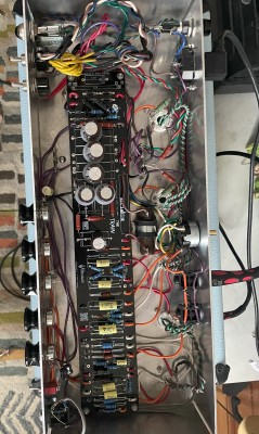

Thanks for the doc Martin. You may be able to help with somewhat related questions. How do I calculate my actual output power in RMS for both tubes in a class A/B? Or more specifically do I need to bias my tubes lower so I don't exceed my OT rating in RMS.
My actual situation is that I am running my Trainwreck Express 6V6 at about 9.5 watts per tube (approximately 180/190 Ohm, ~420Va, ~4.5Vpr). My output transformer is a Hammond 6,600 C.T. 20 watt RMS rated (1760H). How do I calculate that I am biasing within range of my OT capability?
Second question is the % power for my 6V6. I am using TunSol 6V6 GC and have seen 12 watts and 14 watts as 100%. The spec sheets I see online are not rated that high. 9.5 of 14 is around 70%, but 9.5 of 12 is around 80%. Should I be conservative and run these down at 8 watts? This amp is loud as a MF running at 9.5 watts and crossover distortion is fine down at 8-8.5 watts.
proof of build
Posts: 14057
Re: Biasing by Percentage of Maximum Plate Dissipation
Metanoisus wrote: Sun Apr 13, 2025 11:03 am How do I calculate my actual output power in RMS for both tubes in a class A/B? Or more specifically do I need to bias my tubes lower so I don't exceed my OT rating in RMS.
Output power into a resistive load is calculated using Watt's law, I^2*R or V^2/R, where I and V are RMS values and R is the dummy load resistance. For an unclipped sine wave the RMS voltage is Vpeak/sqrt(2), so you would measure peak voltage on your scope just at clipping, and calculate output power as (Vpeak/sqrt(2))^2/R = Vpeak^2/2R.
Zero-signal dissipation doesn't have much to do with the max power case. The danger to your OT is in driving the output tubes to square wave, where the RMS value is equal to the peak value. That will leave you with just Vpeak^2/R, or ~200% of the measured power at clipping.
Metanoisus wrote: Sun Apr 13, 2025 11:03 am Second question is the % power for my 6V6. I am using TunSol 6V6 GC and have seen 12 watts and 14 watts as 100%. The spec sheets I see online are not rated that high. 9.5 of 14 is around 70%, but 9.5 of 12 is around 80%. Should I be conservative and run these down at 8 watts? This amp is loud as a MF running at 9.5 watts and crossover distortion is fine down at 8-8.5 watts.
If you want to be conservative use 12W. GE's 6V6-GT data sheet from 1955 gives max plate dissipation at 12W, design center. The 1967 GE data sheet for 6V6-GTA gives design max at 14W. JJ's current production 6V6S data sheet says 14W, no information on whether that is design center or design max, but it looks more robust than the traditional 6V6GT.
