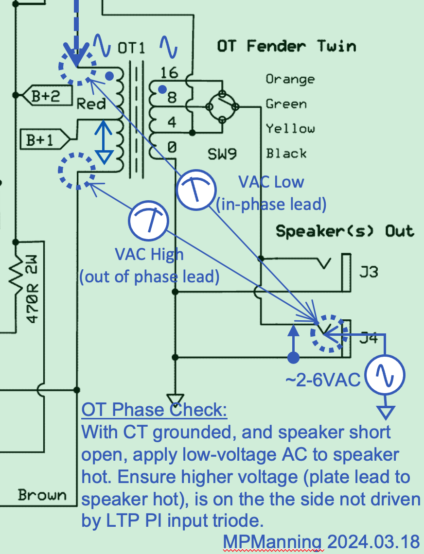

Re: OT check
Adding this alternate technique for the OT phase test that does not require desoldering the CT. It appears in another post on TAG, but this one collects all of the OT checks in one place.
In the test set up shown below, the OT CT is grounded, and therefore connected to the opposite end of the secondary coil. The in-phase lead on the primary side is then the one with the lower voltage as measured from the plate leads to the secondary hot.

Re: OT check
Oh for Geezis sake,
I discovered the whoa's of my ways. After enlarging the diagram I noticed that for this OT phase test the primary center tap needs to be grounded. I missed that and likely the reason why I was getting 7.2 volts on both ends of the coil.

- Posts: 14051
Re: OT check
Did you try it with the CT grounded? It'd be nice to actually get it to work. You should see a difference of twice the applied voltage.

Re: OT check
Ha!
If "dummie" was in the Webster dictionary, you would see a photo of me with DMM probes inside an amp chassis.
I was referencing ground and not the signal wire. That was a bit embarrassing as I know that wouldn't work.
But, all is well now, and happy to say that I won the 50% chance game, and the plate wires were already in the proper location. Awesome.
