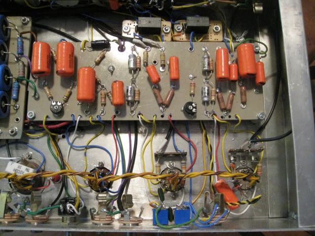

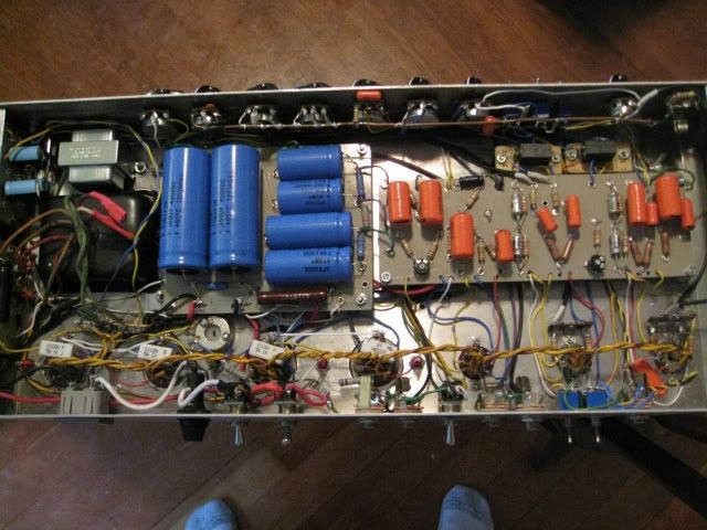

Here is my Non-HRM amp, there is nothing inventive here, this amp is based off of info provided by all the great members here. Id especially like to thank Funk, Dogears, Andy for the MM power supply tips, Tony for helpful advice, Gil and Henry for help in the past as well. Without you guys this would have never happened!
I have to open it up to get the current voltages but last I checked v1a was 188V, v2a is around 200, and v3 is around 295-305 or so.

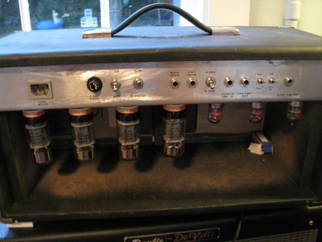

I had EH 6ca7s in there, they sounded OK but I had one short the screens and some other odd stuff. I pulled them and went with Sovtek 5881's as per Funk and Dogears suggestions. I am much happier with these.
Iron is from a musicman hd130, 1972ish that I got from CL. I got a deal cuz it didnt work and took a gamble that the trannys were OK. I checked it out and it turned out that the choke was fried. After I got the MM running I pulled the trannies and put them in this build.

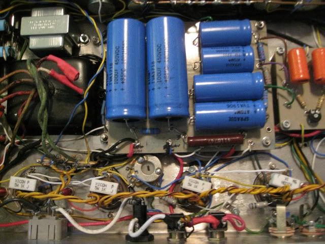

Power stage layout is the one suggested by Andy, using the zener diodes to help protect the preamp tubes. Probably not necessary since I went with a traditional power stage but I wasnt/ still not sure, if I would change that in the future. Screens are 350V. Dropping string is standard but I did have to raise the first resistor from 3K3 to 4k7 i think. There are also two 450V/100uf caps under the filter board, so filtering is set up series parallel to boost filtering. Have not hooked up the DIN for the FS yet, have a regular jack there for the time being.

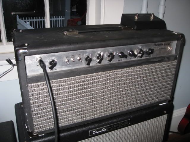

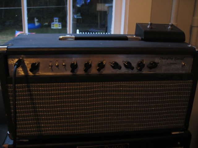

Chassis was made from 1/16" aluminum, cut bent and welded by me. Labels were made with a p-touch labler, black on clear tape. Cabinet is made of pine, mitered, and "tolexed" with 3M sprayable rubberized undercoater form the auto parts store. Makes retolexing a breeze! I need to restretch the grill cloth and I obviously need to clean up the lead dress cuz it looks like a rats nest in there, but its quiet ':lol:'. Any suggestions/criticisms are welcome!

If it's quiet, and it sounds good, no hash/fizz in OD mode, the lead dress is OK! Look at pix of real Dumbles, they don't have right angle military style lead dress either.
If the OD has some fizz I would go over each grid lead and see if they can be shortened, or at least move them around a bit..
Other than the grille cloth it looks great, especially the nice tolex job.

Is this Ampeg grill cloth?

Thanks! Good eye, that is Ampeg cloth I had laying around from an older project. The zener schemo is in this thread:
http://ampgarage.com/forum/viewtopic.php?t=2818&start=0
I wasnt sure where I should put them, but I wound up placing them on the rectifier board, and copying the MM schemo for the rest of the board. I have a type I power transformer so wiring is a little different than the more common (?) type II. The 25K resistor is the large maroon one on the filter board. Not sure if I did this right but like I said, things are quiet.

excuse me but I don't understand very well from your photos, have you wired 2x100uF 450V cap in parallel with 270K drop resistor?

Grtamp, I have a standard filter set up, I have two 100uf caps UNDER (on the opposite side of the filter board) the two in the picture. So I have two parallel 100uf caps, in series (4 caps total). I did this because I did not have 220uf caps a la the ods101 schemo, but did have some extra 100uf so I did it this way. Does that make sense?
Re: 100w ods
Not sure if this will help or confuse but this shows several ways of filter caps in series with balancing resistors.
The resistors help to balance out the voltage to each capacitor.
And as a added benefit they also bleed the voltage to ground when the power is turned off.
