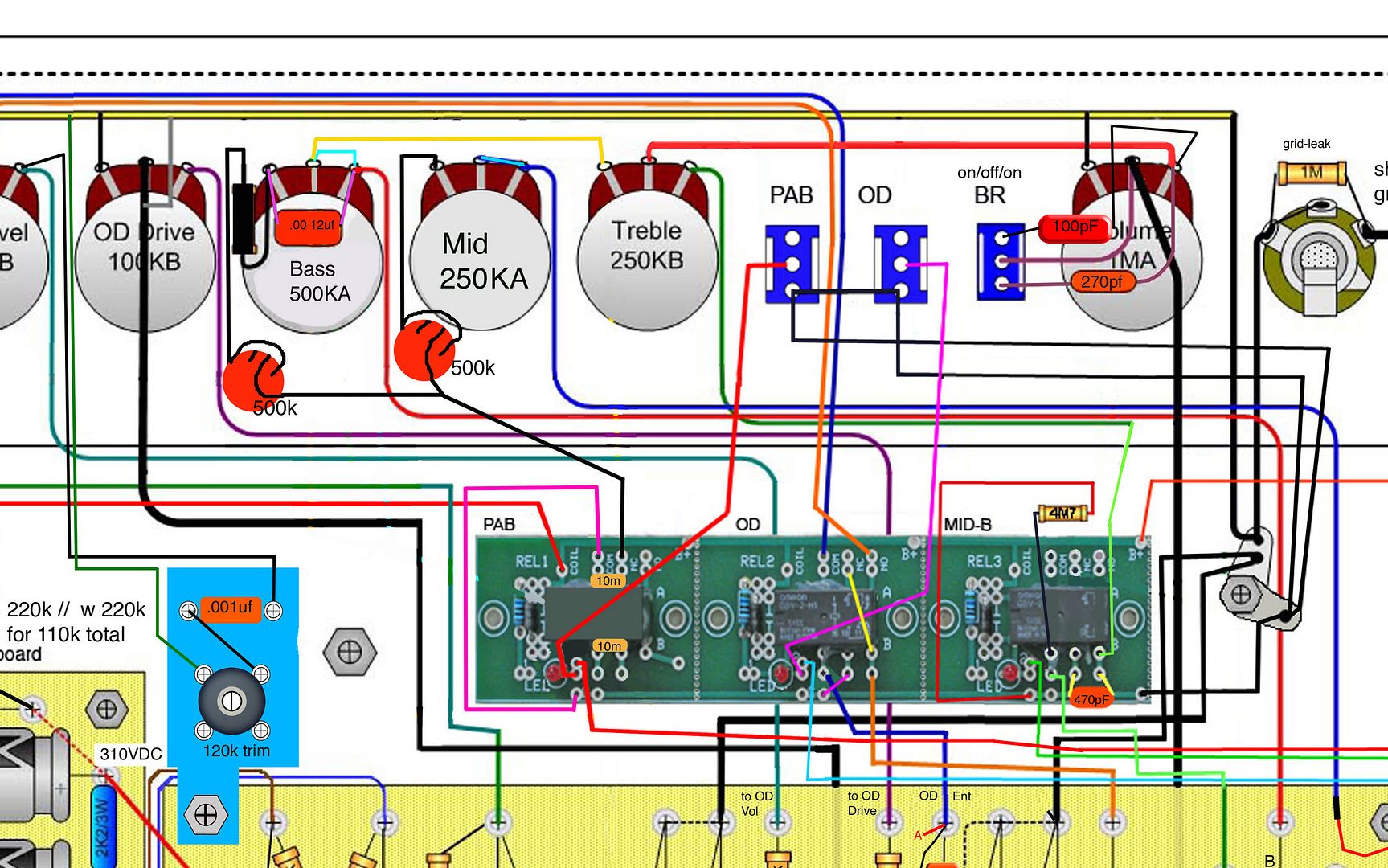

Trying it
Post by angelodp »
I think this is what you are suggesting, is this correct. I have blacked out the 10k R on the Bass pot so its not in circuit, just the two 500k pots tied together.
[IMG:2240:1401]http://i260.photobucket.com/albums/ii9/ ... F-PABa.jpg[/img]
Dr d
Posts: 281
Joined: Mon Mar 01, 2010 10:53 am
Location: UK
Re: PAB comparisons
Post by Dr d »
That looks about right. Find the values you like and sub in the nearest value resistors.

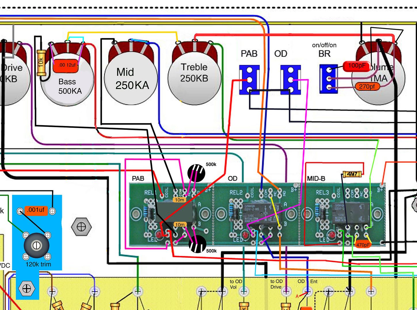

Not working
Post by angelodp »
Hi, what I have in this config is the two 500k pots affecting the clean tone but not the PAB when its engaged?
I have the output ( ground lug ) of the Bass and Mid pot running to the input of each respective 500k pot then I tied the wiper of each pot together and ran that to my relay NC.
Posts: 14064
Re: PAB comparisons
Don't you want to ground the wipers of the 500k pots and take the top of those pots separately to the relay NC's to have the pots shorted unless the relay is energized? Also, keep the 10k between the bottom of the bass pot and the top of its 500k pot.
Dr d
Posts: 281
Location: UK
Re: PAB comparisons
Post by Dr d »
Hi Ange,. i cant remember exactly what i did but you could try this. Send the ground lug connection on the mid pot to one of the relay commons. Send the bass ground lug to the other common via a 10k resistor. Tie both relay NCs to ground (earth). Finally connect one of your 500k pots between the NC and NO on one side of the relay, and the other 500k pot between the NC and NO on the other side of the relay. With the relay engaged, tune the pots to taste. Hope this clarifies!

angelodp
Posts: 2129
Joined: Tue Jan 15, 2008 2:45 am
Location: L.A.
graphic
Post by angelodp »
Sorry for the paint by numbers, just trying to get it right.

angelodp
Posts: 2129
Location: L.A.
works
Post by angelodp »
Ok this works, very cool. PAB is very good and I can dial in bass or mids. I have two big 500k pots hanging in midair right now. I must get trimmers and do it right, but it works.

trane34
Re: PAB comparisons
Post by trane34 »
angelodp, hello. what is the other mod you have on the layout that is attached to the od level pot? Thanks!
angelodp
Posts: 2129
Location: L.A.
Treble bleed
Post by angelodp »
That is a treble bleed that Gil Ayan worked out. Helps take off a little top end on the OD.
Trimmer to ground
.001uf on the input
dial to taste

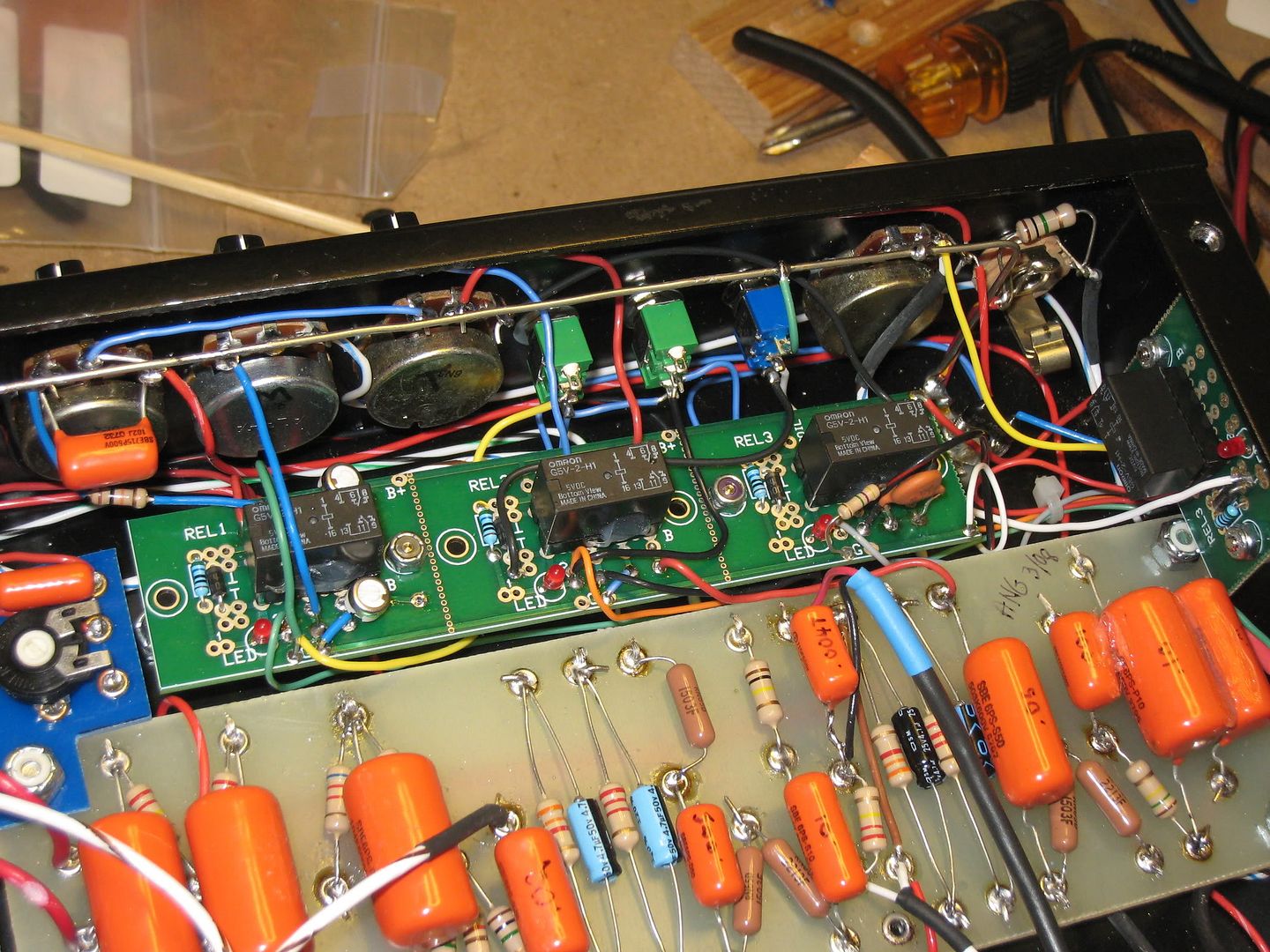

angelodp
Posts: 2129
Location: L.A.
results
Post by angelodp »
Pretty happy with this little tweak. Does allow an easy adjustment once inside. 500K trimmers are MIL spec so they should be good or the long haul.
270k on the Mid, 150k on the Bass side. PAB really shaped up nicely now. I had something in the mix that was giving me a bit of Honk on the PAB which is out of there now.
