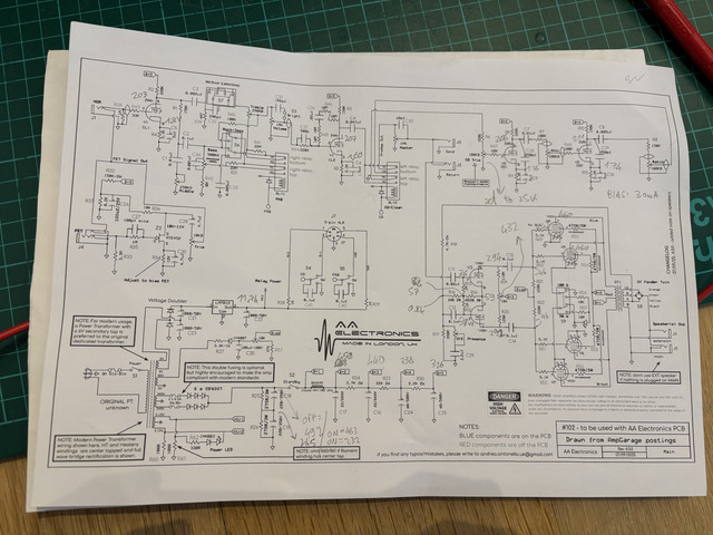

Thanks guys. I finally had some time to take voltage readings yesterday night. Here they are (also attaching the schematic with my notes):
B+ (STANDBY) = 492
With amp on:
B+1 = 463
B+2 = 459
B+3 = 440
B+4 = 334
B+3 = 326
Tubes:
V1-1 = 207
V1-3 = 1.69
V1-6 = 203
V1-8 = 1.8V
V2-1 = 211
V2-3 = 1.74
V2-6 = 206
V2-8 = 1.86V
PI node: 432
after 110k = 294
afetr 120k = 292
bias = -46V (30/32mA measured at the 1Ohm resistors)
6L6 plates = 460
LM7812 reg = 11.72
OD trim = set to 25k, measured with amp on to GND.
The FET section hasn't been set yet.
(I’m using a Fluke 289)
What do you think? anything that looks suspicious?

Re: Drastic Volume Change on Jazz/Rock Switch - Dumble ODS #102 Clone
Hi there,
With the Jazz setting you need (!) to turn up the mids and bass to get back the volume/level. That is simply how this works. I think all is fine with your rock/jazz wiring.
Best, Electron
Best, Electron
Thanks Electron.
Am I correct to assume the voltages look in line with a 102? Anything that stands out?
