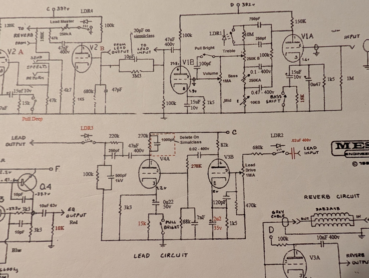

ODS HRM/ Mesa Mk IIc+ hybrid preamp?

There are some similarities between the two preamps. So what if you used the Mesa Lead Circuit but then put the HRM tone stack after the second lead stage instead of the stuff that Mesa has there? The clean would be Dumble, probably with PAB on.

That's roughly what a Mesa Badlander is, except the pre tone stack has hardwired value, and the post gain tone stack is driven by a cathode follower in traditional Marshall style (has the 33k slope and 470pF treble cap too)
