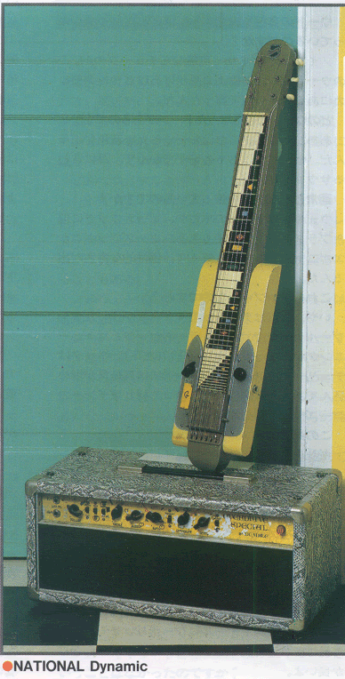

His signature Dumble tones with Browne have been using the typical solid body lap steel: [IMG:388:764]http://img.photobucket.com/albums/v83/f ... leyrig.gif[/img] Of course he also has a collection of other electric Dano's, Nationals, Teisco's, Kay's, etc.
As mentioned, the FET input is just another flavor that he obviously preferred for some tones. On my Ceriatone OTS, the FET input is a perfectly useable tone, a bit tighter and brighter, but very easy to get a good sound. The level has a trimmer, so you can set it up however you want. Amps that have an FET input simply offer another tonal option.
