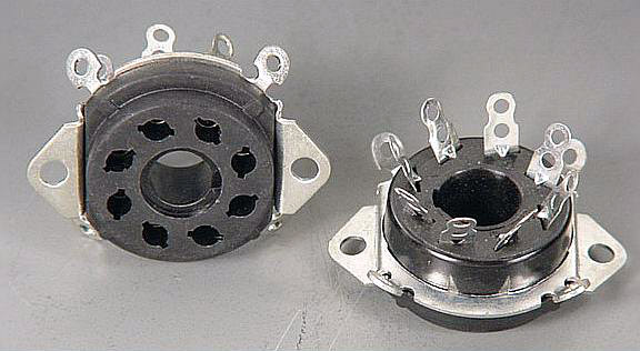

Steve asked me about this, and it seemed like he might be well-advised to tighten up the loops in the heater wiring.
Relax. It's SUPPOSED to smoke a little.
Re: Mojotone JTM45 Schematic in Emailable Form?
This is something that is troublesome to fix after the amp is built. If there is any doubt, rework it. Heaters are "funny" in that sometimes they are just fine for no rhyme or reason, and other times, you mess up just a little bit and you're sorry. I think the most important thing about heater wiring is to keep it clear of the signal wiring. There are many schools of thought on how best to do this and all of them seem to work.
Good reading here, but not the picture I'm thinking about. http://www.apexjr.com/images/8PINOCTAL4.jpg
You can always try doing it Hiwatt style http://www.performing-musician.com/pm/j ... ternal.jpg
Gabby does a nice job of showing how: http://www.youtube.com/watch?v=ZxFBid3r8aM and especially for the 12AX7 here: http://www.youtube.com/watch?v=rFghwLDOPsA&NR=1 notice how tight he wraps the brown wire to the socket.

Steven here is a good tutorial about heater wiring.
http://www.brown-note.com/heaters/
