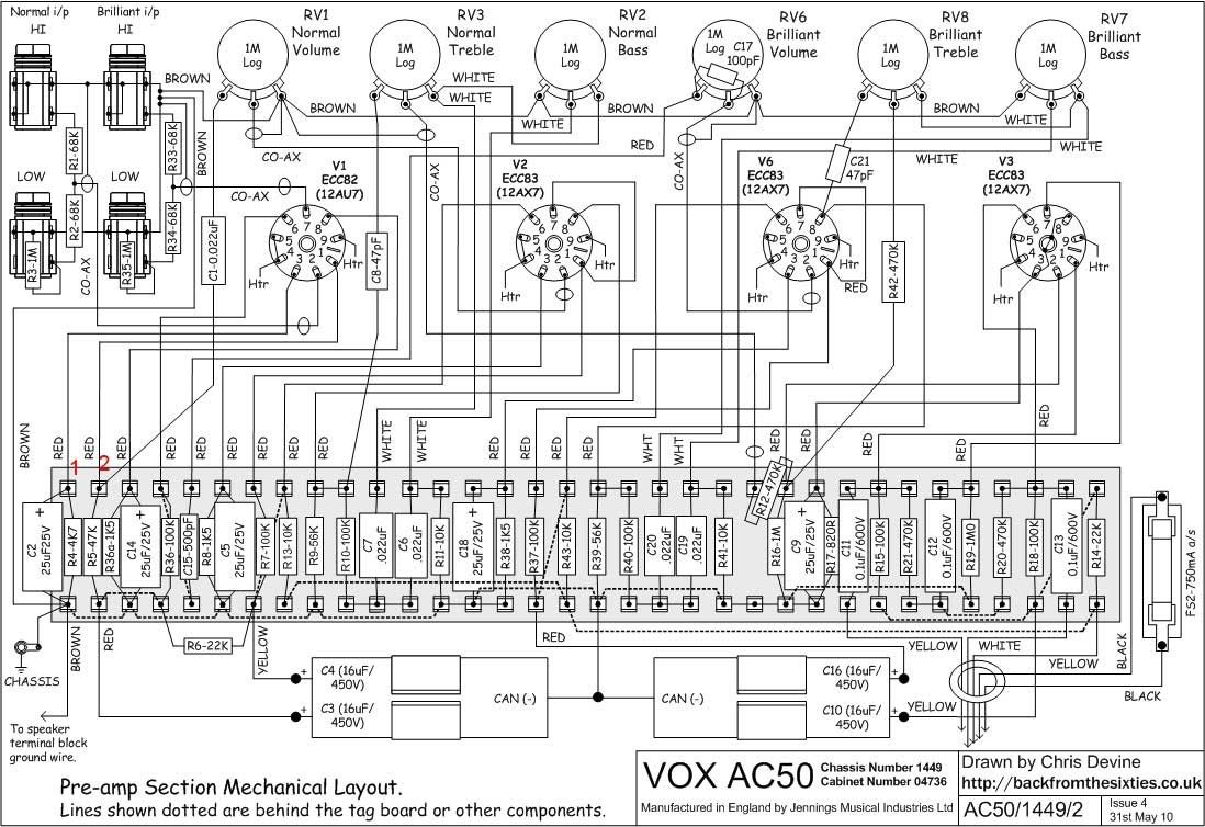

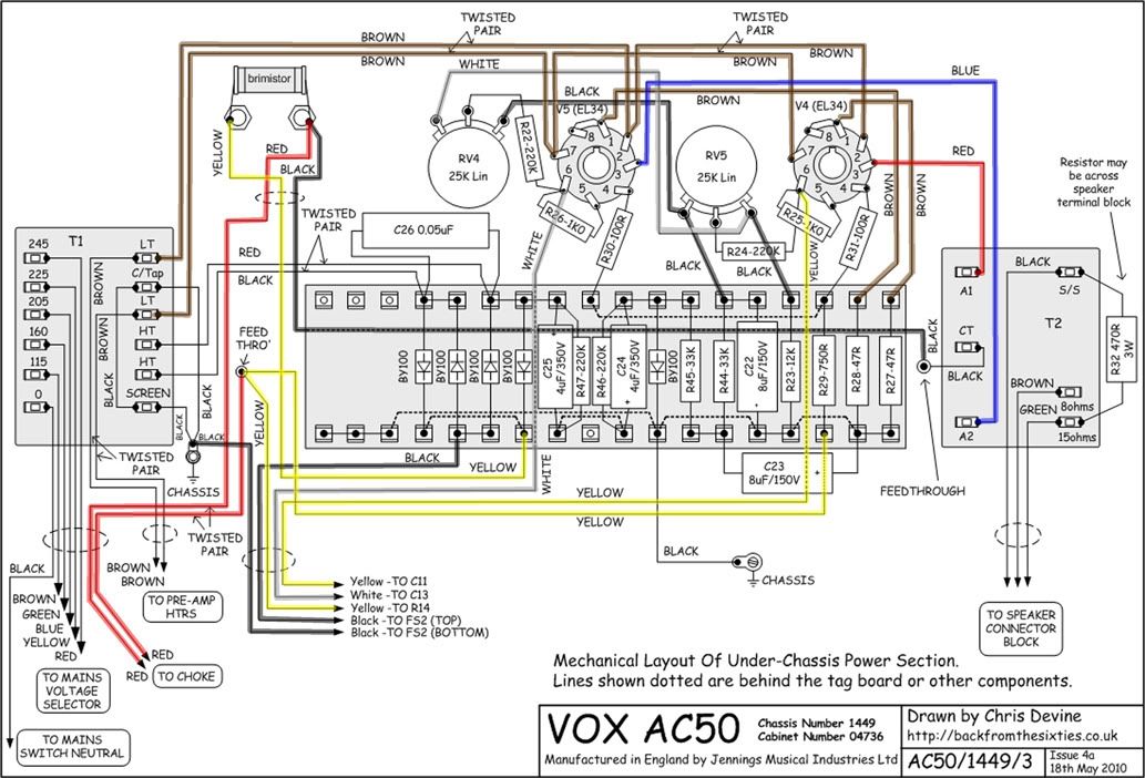

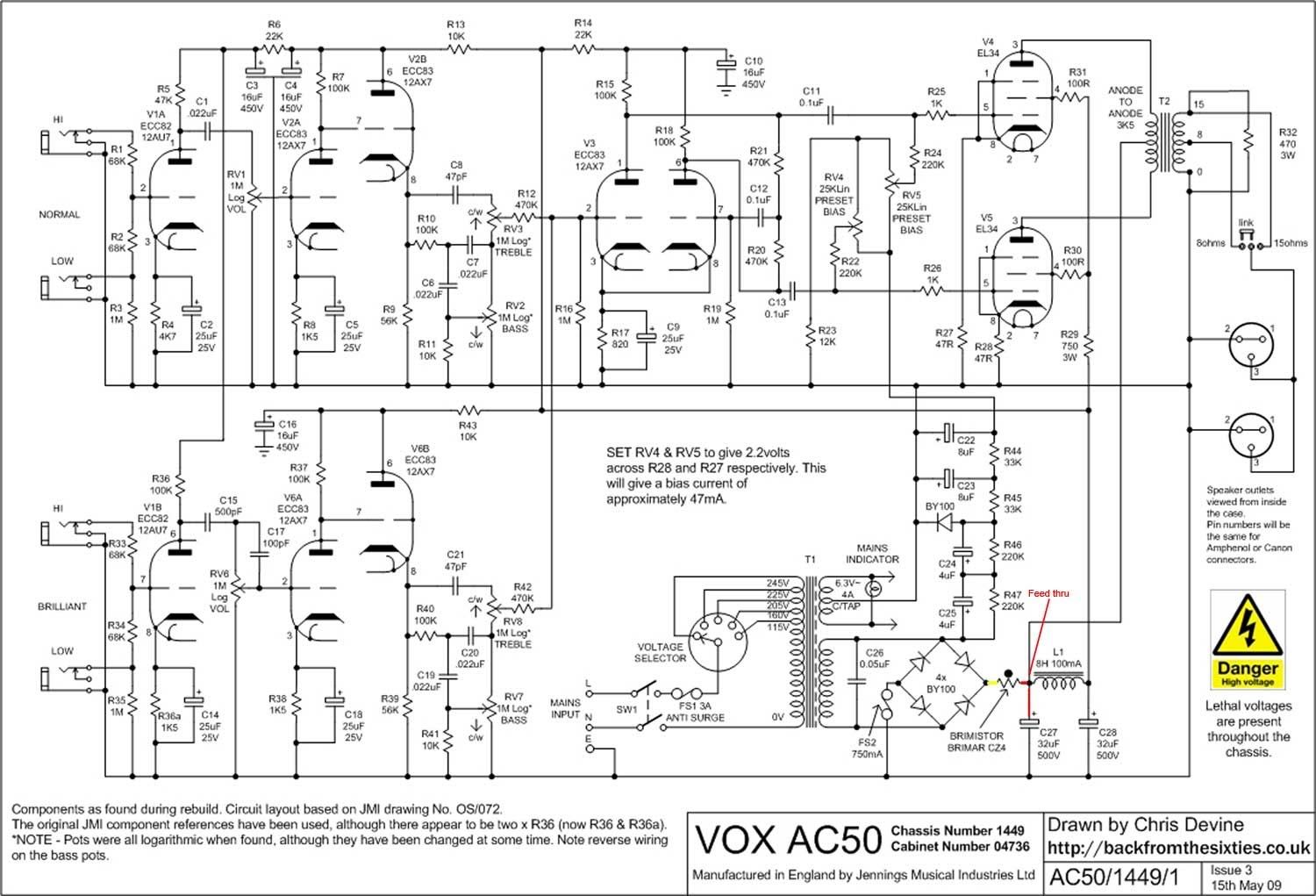

I bought an AC50 in London a few years back. Ugly recover, semi-functional condition. Well, I finally recovered it, but that was the easy part. Someone had gone to town on the amp itself, lots of wiring changes, cap changes, etc.
I've gone through it and put it back to stock (or as close to stock as I could - I put in a GE thermistor where the Brimistor would have been). However, I have two problems:
1. Low volume and hum. Volume and tone controls have an effect, but really low output and AC-derived hum.
2. Bias trouble. I can get my 2V across R27 (one of the two 47R resistors) with a functional bias pot, but it's 7V across R28, and the bias pot has minimal effect.
I've gone over the wiring a bunch of times, everything looks in order, as do all the component values in the circuit. I've obviously missed something, so I was hoping someone here with some AC50 experience might take a look and see if anything obvious comes to mind.
Here are the circuit layouts and schematic I've been using.
[IMG:1098:754]http://i115.photobucket.com/albums/n308 ... ss-4-2.jpg[/img]
[IMG:1033:702]http://i115.photobucket.com/albums/n308 ... s-4-MS.jpg[/img]
[IMG:1500:1021]http://i115.photobucket.com/albums/n308 ... iagram.jpg[/img]

That implies that V5 is biased roughly correctly ~ 47mA cathode current, but that V4 is running away: 160+mA.
Since the bias voltage is from the same supply, and V5 has a sensible value, there are very few places it could be going wrong - check around RV5 & R24 - maybe RV5 has a noisy / intermittent wiper?
There may be other problems, but it's worth sorting this out, because it looks like you're cooking V4 at the moment.

Tillydog wrote: That implies that V5 is biased roughly correctly ~ 47mA cathode current, but that V4 is running away: 160+mA.
That's what I was thinking, but it seems to work as it should (voltage divider) across full travel. But I'll check it again, as well as R24.

Tillydog wrote: Since the bias voltage is from the same supply, and V5 has a sensible value, there are very few places it could be going wrong - check around RV5 & R24 - maybe RV5 has a noisy / intermittent wiper?
If RV5 is OK, then its likely C11 is leaky - try disconnecting one end of it and see if the bias voltage then behaves.

You know, I've been making a list of things to do, and not to do, for people (me) learning to work on amps. I think the one that would probably be at the top of the list (OK, drain caps first) would be "CHECK WHAT YOU'VE DONE, STEP BY STEP, THREE TIMES" before you scream for help.
Andy, the C11 tip was really helpful, because, as you suggested, I pulled one leg. It didn't help, and there was a lot more noise, not less. But, while I was looking at C11, I checked the layout and schematic one more time, and couldn't figure out why I had two wires going into the eyelet on one end of C11 (along with the cap lead), when I should only have one. Turns out... (drum roll) I had one of the 16/16uf filter cap's positive leads going there. Misread the layout completely.
So, I put it where it's supposed to be and, son of a b&$*%, bias is adjustable, not much noise. Get everything adjusted where it's supposed to be, plug in... and it sounds great! Really nice. Louder than hell, too.
