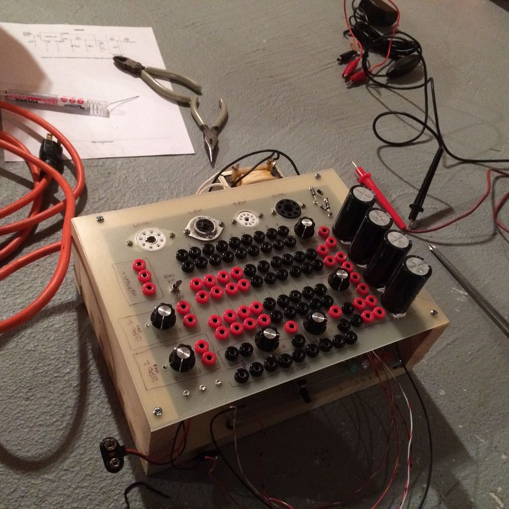

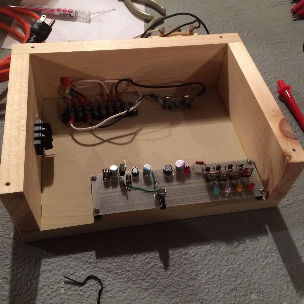

Back in the basement today - I'm working on a testing rig so I can plot curves for my heptodes (and some small signal pentodes for my radio amp).
Sadly the uTracer doesn't support multiple grids, so I'm making this out of spare junk I've got laying around. I had a ton of banana jack sockets in another project that I disassembled, and I'll use my variac to power the high voltage supply through an isolation transformer. Filament voltage will be provided by an adjustable buck converter powered by a pedal wall-wart (so up to 9v filaments, fine for the tubes I've got), and grid voltage will be provided by a pair of 9v batteries.
Anyhow here's a shot of the filament supply and LEDs that indicate when the big high voltage caps discharge (they stay lit until 10v or so using constant current sources). The bright LEDs are BRIGHT even using just a 1ma current source. Hooray for science.

And here's all the banana jacks and so forth. It's mostly wired up now, and I'll stick some common-value resistors and capacitors across the central bunch of jacks so I can build circuits easily just using jumper cables.
