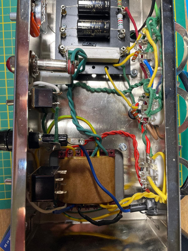

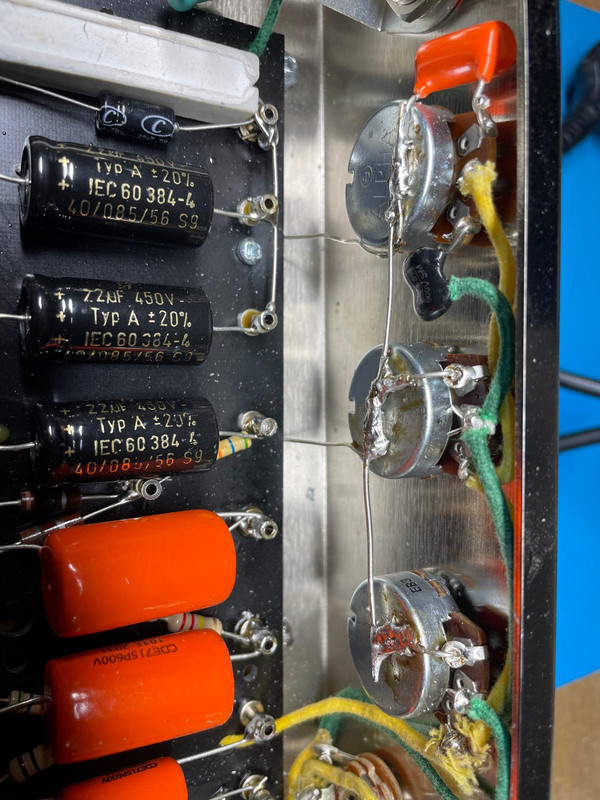

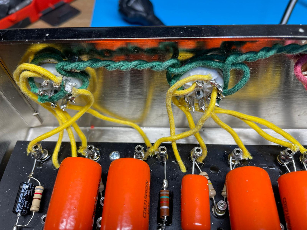

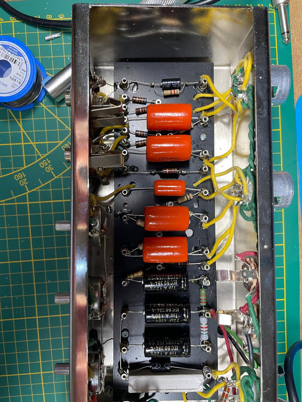

Below are updated pictures of the works for your approval. The dull solder here and there is not from cold joints but I suspect from mixing copper, lead and tin.
As for the sound, there is now. It's just not loud. Rather quiet actually. Library volume.
The preamp tubes show no glow. I tested the filament and got a perfect 6.5V without tubes or 5.2V with tubes installed (is that voltage drop normal?). Pot 1 is mostly unresponsive. Tone doesn't seem to be doing much of anything either, but it's hard to tell.
Bigges problem, methinks, is the voltage on B1. My multimeter does something completely new there. It switches continuously between 123.12 and 12.312. I'm not sure what it's trying to tell me. I don't suspect these are actual voltage modulations.
That's where I called it a day. Tomorrow I have an appointment with an upholsterer for my cabinet. I won't even attempt doing that myself. A man has to know his limitations.
Not sure when my next round will be, but any of your wisdom in matters of the current status will be greatly appreciated as always.

With no tubes in the amp when you read across pins 2 and 7 on either output tube you should read well over 7 volts.
With all the tubes in the amp you should not read less then 6.1 vac.

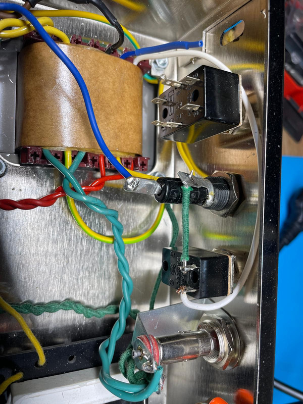

I can’t tell from your pictures, but where is that green / yellow wire from the secondary of the power transformer going?
It should be bolted or soldered to the chassis to get its needed ground connection if it’s the center tap of the 6.3 volt filament winding.

Why would I have 7 volts on the filament? The trafo only delivers 6.3V.Stevem wrote: ↑Mon Jun 02, 2025 7:54 pm With no tubes in the amp when you read across pins 2 and 7 on either output tube you should read well over 7 volts.
It is grounded. It's lugged to the transformerfoot/chassis just behind the fuse.

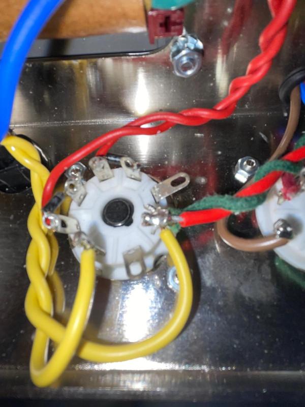

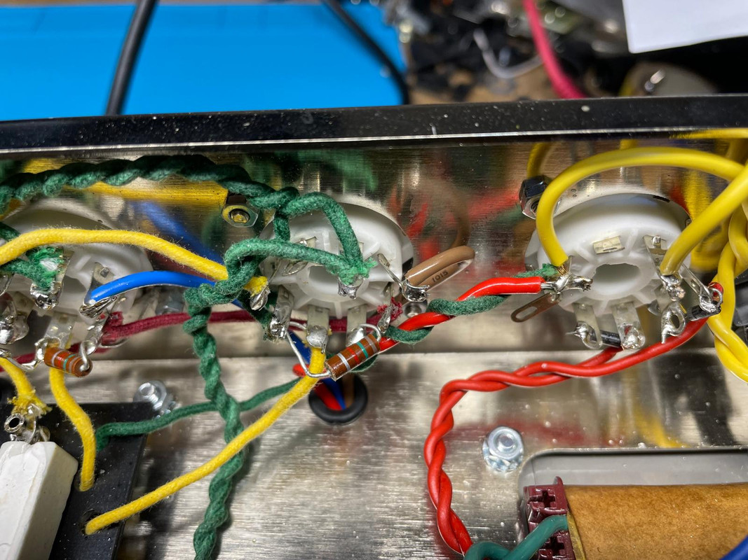

Check the blue plate wire, doesn't look like it's connected well. Next to it is the screen, looks like you have the 1k5 grid stopper going to the screen grid instead of the control grid.
Edit: never mind, camera trick. Solder joint on the grid does look kinda iffy.

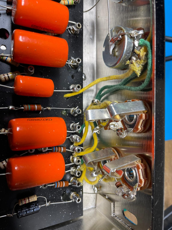

Are you using two shorting type speaker jacks it looks like.
Also as someone mentioned your output tube socket wiring does not look right from what I can make out.
Can you take more of a downward photo of them instead of a sideways?
That would be really helpful for us.

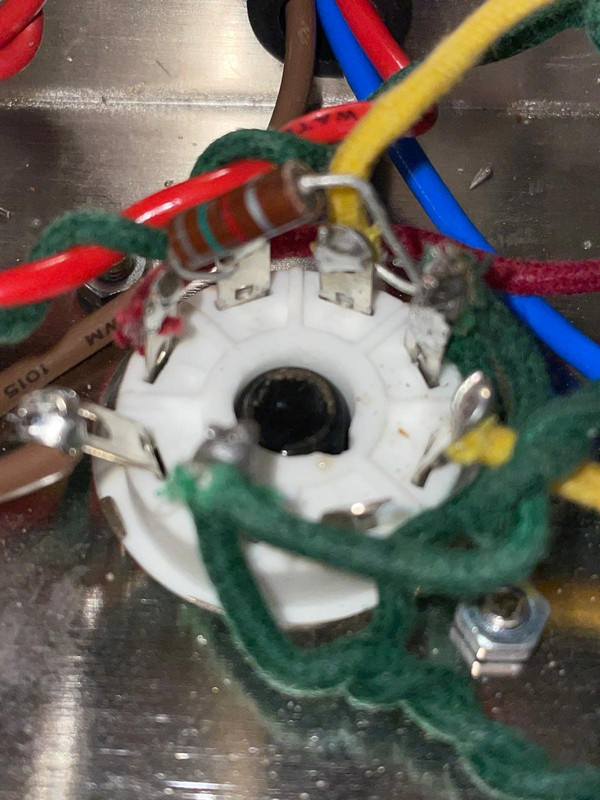

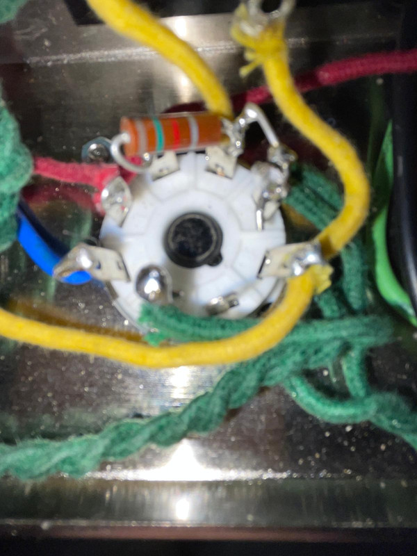

The kit came with only one type of jack. The shortening type.Stevem wrote: ↑Mon Jun 02, 2025 11:08 pm Are you using two shorting type speaker jacks it looks like.
(It also came with one type of noval socket. The wrong type)
Hope these will do. My phone isn't too happy with little distance and lots of flash.
Re: 5E3 - First build, first dud
None of the pins on the output tube sockets should be touching each other. That resistor shouldn't come close to touching anything but the two pins it is connected to.

It’s still hard to tell, but in that last photograph of the output tube socket it looks like pin 6 side of that 1.5k resistor is touching pin 7.

Don't know what got into me there. Think it was one of Rob Robinette's wiring diagrams with a lead color that didn't come out clearly from my printer, bad basement lighting and... oh yea, color blindness. Anyway, I intentionally wired the resistor leg on pins 6 and 7.
I was sure you nailed the issue there since I essentially placed a resistor on the filament. So I played hooky for an hour and fixed it in full anticipation of a sound hurricane.
Sadly it only made a minor difference. Little bit louder and the tone is working now.
