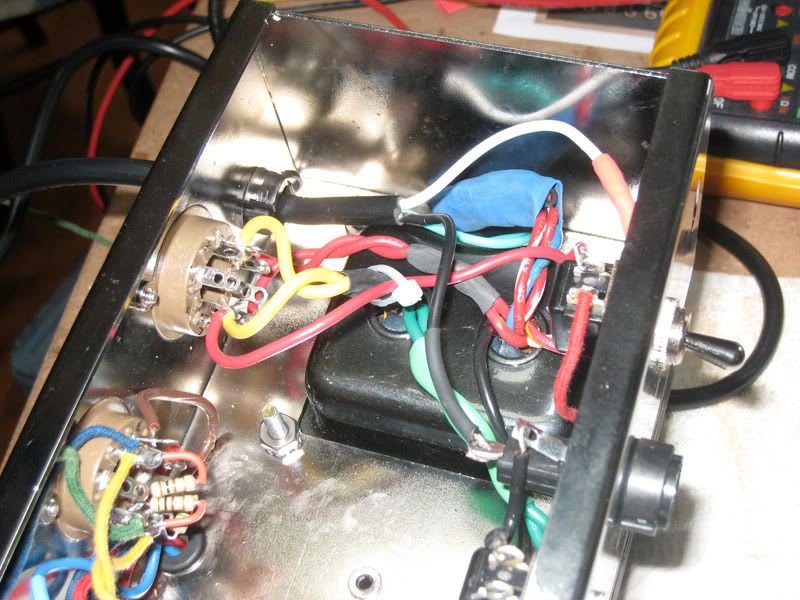

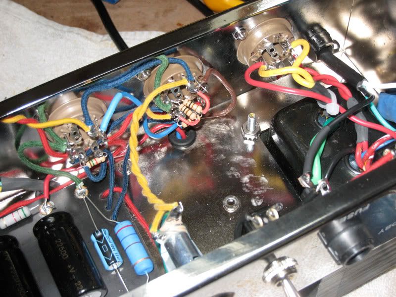

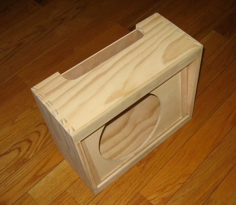

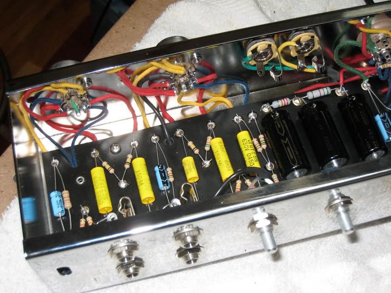

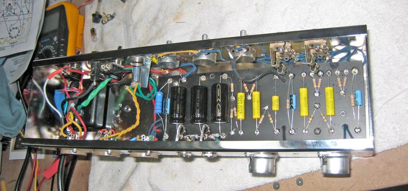

Ok been experimenting and just love this amp.... its got a lot of tonal possibilities, and I am getting into the jumper mode as well.
cool thanks guys. Cab almost done.
PS next build??
