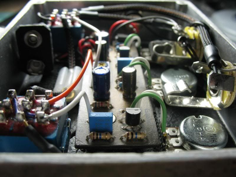

GGG EA Trem
Here are a couple shots of my battle worn (5 years now) but still working great GGG EA Trem stomp box.
LOL!! Just noticed that GGG has posted up a number of drill templates suitable for this build. One of them includes a larger enclosure that puts the boost only function on a footswitch. Mine is on a toggle which can be a minor annoyance if I forget to set it the way I want it before starting a song.
http://www.generalguitargadgets.com/com ... gory_id=42
Anyway....hope that this helps Ange! Don't hestitate to give me a shout if there are any questions.
