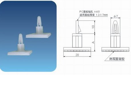

Just getting started into this pedal stuff. My son and I are starting with an AMZ mini Boost. Just got our stuff from Mammoth Thurs.
One quick question - how are the PCBs mounted within enclosures? Is there a typical approach used here? The gut shots here look very impressive (not to mention davent's artwork - "Made in Canada in the basement", what a hoot!), but I am unable to determine how best to secure the "innards".

Most just float on the wires with no firm connection to the enclosure. Always wise to cover the backs of the pots with something non-conductive. Mammoth sells "pot condoms" in a couple of different colors just for that.

You can use some thicker double sided tape.
Put cut pieces on the pots and then stick the board to them.
Some other kit makers have holes drilled in the board and then plastic
standoffs are stuck on the pots, which then snap into the holes.
[img:457:329]http://img.alibaba.com/img/pb/674/006/2 ... 4_1065.jpg[/img]

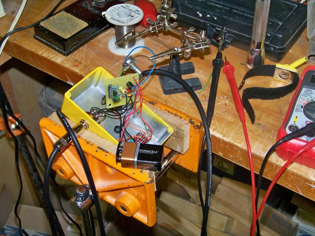

I'm working with vero board - 1st time build, not a printed circuit, so I've got some room here, if I plan for it ahead of time. I think I'll get some standoffs and JB Weld - epoxy. Something like that.

Have mercy, does this little guy have some oomph!
[img:1024:768]http://i165.photobucket.com/albums/u76/ ... b298bb.jpg[/img]
Just finished trying this puppy out. Awesome. Even the wife is impressed. Used an off shore LP copy into the mini Booster, then into a clone 1987 head (channels jumpered) and 4 x 10" cab - my ears are ringing!
A little blatty on the neck pickup, but on the bridge - great. My son tried it out with his Ibanez - EMG 81/85 PUs. Neck PU has more clarity than mine (Duncan Jazz). Definitely a great way to start with effects.
I found soldering the JFETs (J201) isn't too smart, so I got some sockets for them this morning. Still have 8 left over for another few builds.
