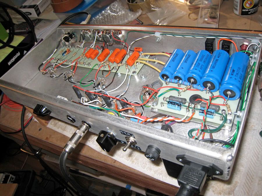

Here's what the amp looks like to start with ...
[img:639:478]http://i104.photobucket.com/albums/m168 ... CN1099.jpg[/img]

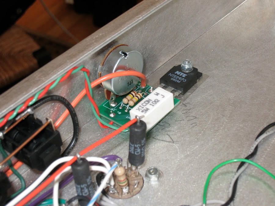

Step 1: Drill a hole in the back panel ... mount the POT/BOARD ASSEMBLY. Be sure to protect all the amp parts from shavings ... I used aluminum foil and tape. Made it easy to collect all of the shavings once done.
[img:639:478]http://i104.photobucket.com/albums/m168 ... ed01-1.jpg[/img]

Step 11: Drill a hole in the chassis to attach MOSFET. (IMPORTANT: Must use silicon insulator (see the trasnparent square beneath the MOSFET in the picure) and this one can use a regular nut/bolt. Protect the amp once again ... this ones a bit easier ... vacuum to be sure.
[img:478:639]http://i104.photobucket.com/albums/m168 ... weed02.jpg[/img]

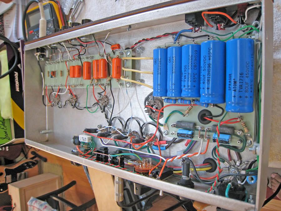

Step 12: One "chicken head" knob controls the whole amp level. For those familiar with the tweed 2-4-6-8-10 5E3 volume control settings, this is where I've been running this amp all day long ... with really good sounds.
[IMG:639:478]http://i104.photobucket.com/albums/m168 ... CN1125.jpg[/img]
Now one problem that Dana mentioned ... when you dial the amp back (mine at about 30%) you begin to get scratchy guitar pots as the voltage drops. There are a couple of resistor and cap adjustments you can make that will correct this. I wanted to leave the amp as close to standard as I could. While playing today, I discovered that as long as there is ONE pedal that is NOT true bypass (in other words ... with buffer), the scratchy pot disappears throughout the entire VVR range. It doesn't matter if that pedal is engaged or not ... mine is a TS9. I will run a couple of drive pedals in front of this rig so ... no issue for me. Works great ... really saisfied ... if I were not planning on running any pedals, I'd have a bit more work to do to get the scratchy pots adjusted but all of those adjustments are explained in Dana's VVR instructions.
Also, not related to the VVR but while I had the hood up, I changed the .1uf/600v caps in the pre-amp to .022uf/600v for normal channel and .047uf/600v for bright channel. Sara thought this might de-emphasize the bass a little with my humbuckers ... the standard 5E3 can be a little bassy. It also allows me to vary the bass a bit when mixing the two interactive volume controls. And ... with the extra headroom of the 30w 6L6 format in the Supra-Luxe, I've found that I like the 12AX7 in V1 ... changed that early on.
I can't tell how much help both Sara (Richter Amps) and Dana (Hall Amplification) have been as I've learned about this subject and this amp. Great to put up with all my questions.

OK I fixed the scratchy pot deal on the VVR by:
[img:639:478]http://i104.photobucket.com/albums/m168 ... atchy2.jpg[/img]
Step 2: Disconnect the leads to pins 2 & 7 of preamp tube and pin 2 of phase inverter. Then add the 1meg resistors. They are grounded to the socket base through the terminal strips.
[img:639:478]http://i104.photobucket.com/albums/m168 ... atchy4.jpg[/img]
Step 3: Attach the wires to the terminals ... then caps to the pins on the tubes ... .022uf for the pre-amp ... .047uf for the phase inverter. These are the same values I replaced on the board ... replacing the .1uf all four were originally.
[img:639:478]http://i104.photobucket.com/albums/m168 ... atchy1.jpg[/img]
Scratchy pots are gone ... hopefully I haven't trashed the look of Sara's amp too much. But I'm happy with it. The VVR is wonderful too. The Supra-Luxe is far less bassy and more to my taste plus I can dial it down to nothing with the VVR without changing the tone.
