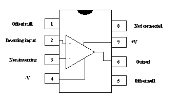

What is a chopper?
Is that a chopped down B3 cabinet?
I think Vibratoking's idea has some merit.
If you can figure out the pinout, it will go a long way to identify them.
For example a TL071 is a single opamp.
[img:351:195]http://www.synthdiy.com/files/2004/tl071a.gif[/img]
Where as a TL072 or 4558 is a dually.
[img:377:352]http://www.media.supplyframe.com/produc ... pinout.jpg[/img]

Yes, a chopper is a portable B3 made from a normal B3.
THANKS TOM! That makes so sense even caveman do it! I am pretty sure they are singles because of neaky spicions, but nice to have a ref of what the heck look at, unga..
