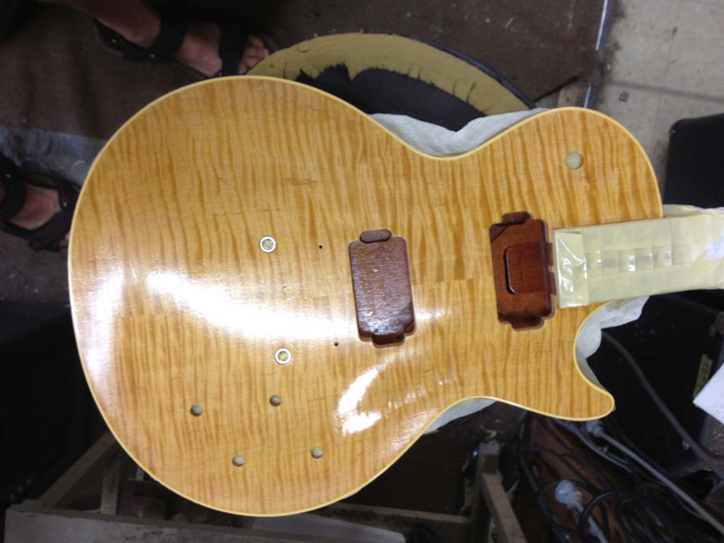

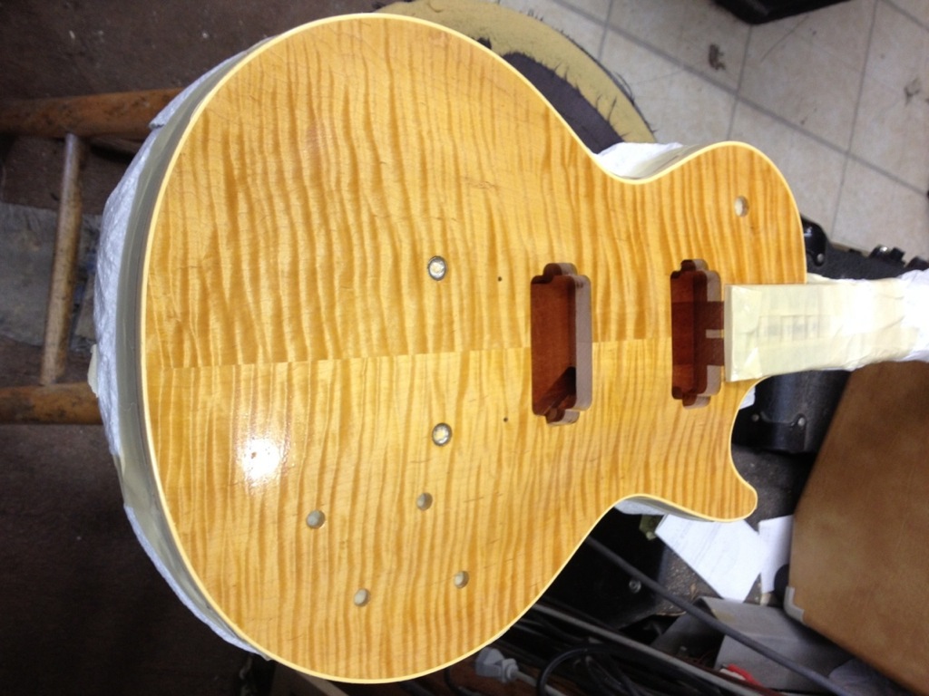

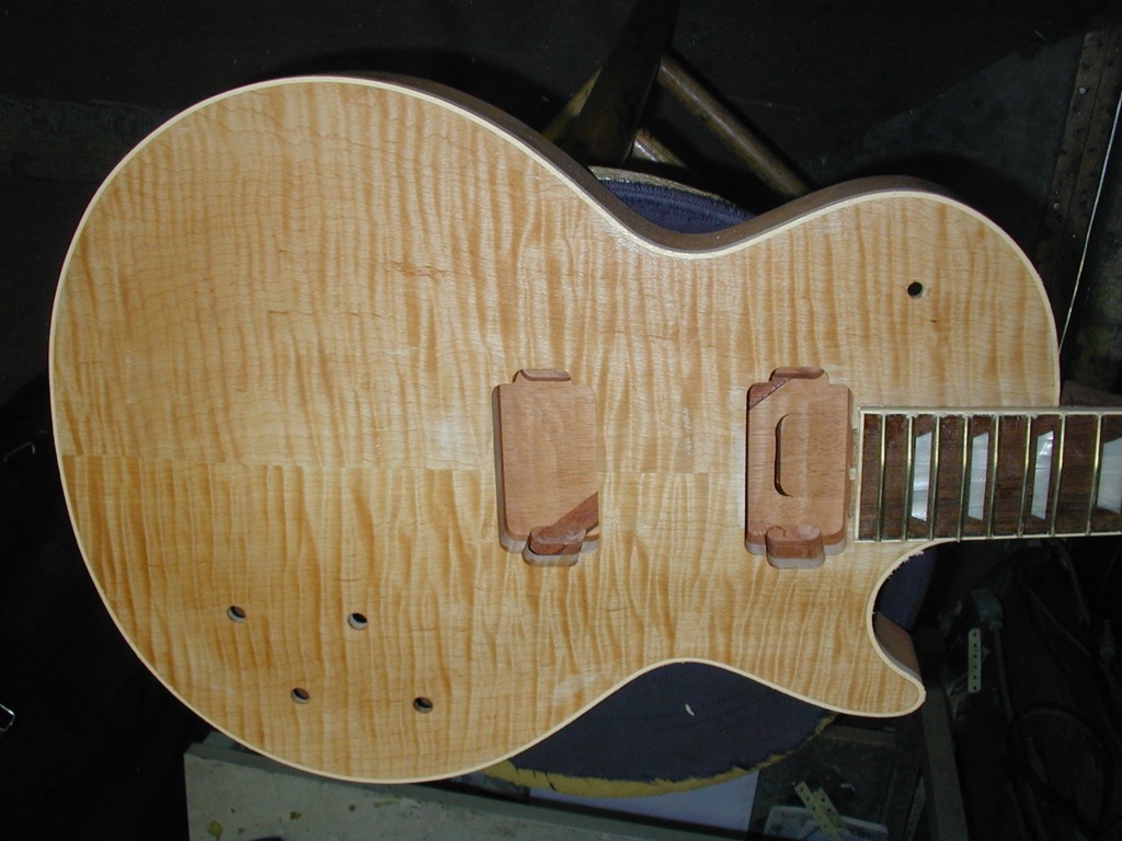

I've had a 59 Les Paul burst replica in the building stage for years and it's finally nearing completion. I sourced some 80 year old mahogany wood from Larry Wysocki for the body, and the top is an eastern flame maple. It's got the repro Historic Makeover inlays, Brazilian Rosewood fretboard. It's built with the long neck tenon, and hide glue was used to put it together.
I decided to go with an "unburst" lemon finish so it will just have hints of red/brown around the edges of the top (that's the next painting step this weekend).
The electronics in the guitar are two Gibson PAF pickups (real ones), .015/.033 Sprague Bumble Bees, with 500k CTS pots (old spec w/brass shaft, etc) and wired to 50's wiring specs. Finishing out the guitar will be a bone nut, no wire ABR-1 bridge, a lightweight aluminum stop bar tailpiece with the longer bushings and steel studs for the stop bar, as well as patent pending Grover machine heads from the 50's. The neck profile was duplicated from my 1959 Les Paul Junior.
Been a long time coming (and paying for this beast!), but I should have it in my hands early next month after the nitro cellulose lacquer has finished drying/curing. Some Iphone pics...I'll post more when it's about to be assembled/wired, and after it's done. I'm not divulging the builder's name, so please don't ask.

That's looking mighty fine! All the right stuff in it too... Was the top bought already carved or did you shape it? Very complex geometry in those guitars as compared to slab-like Fenders.

Gents, thanks for the kind words. No, I'm not building/carving it. I don't have those skills. I'll tell you this much, it's being built in the same shop that Slash's Derrig LP replica was built in the 80's with the same jigs/etc as Slash's.
If that tells you who's building it, great, but don't post that information online, please. This one is going to be era/build/logo/parts correct, but it will have my custom serial # on it so it can't be mistaken for a real Burst.
