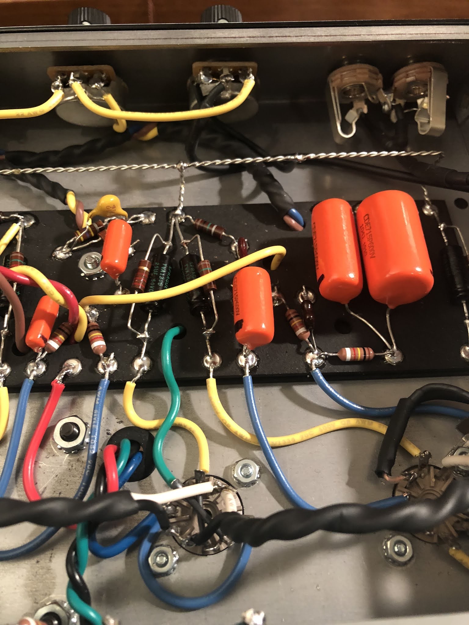

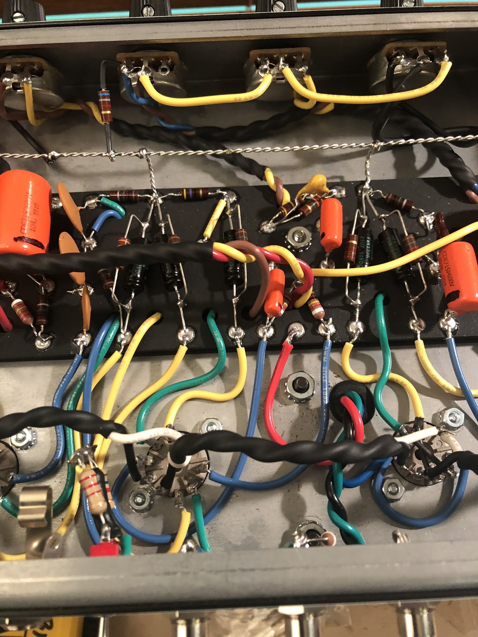

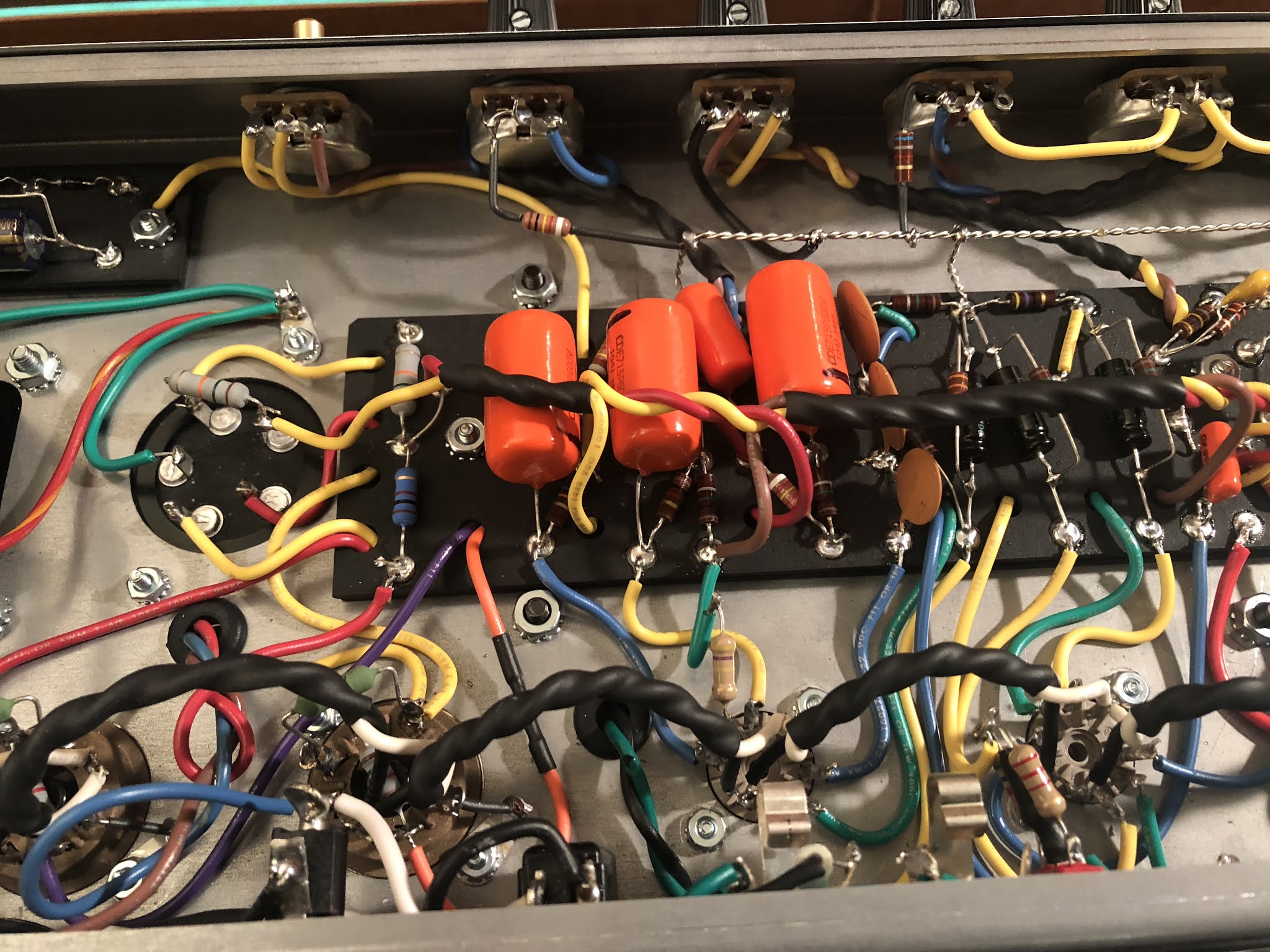

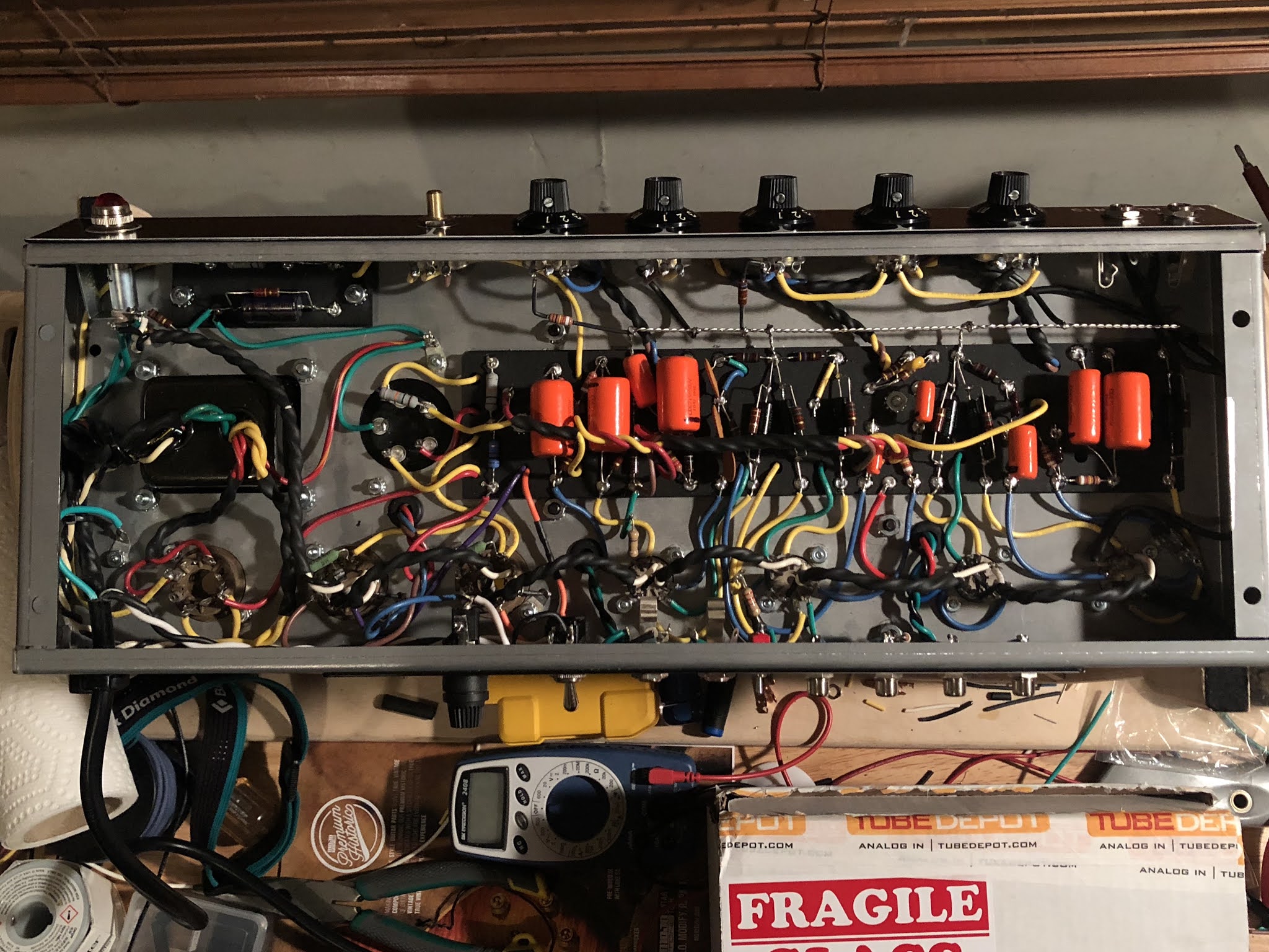

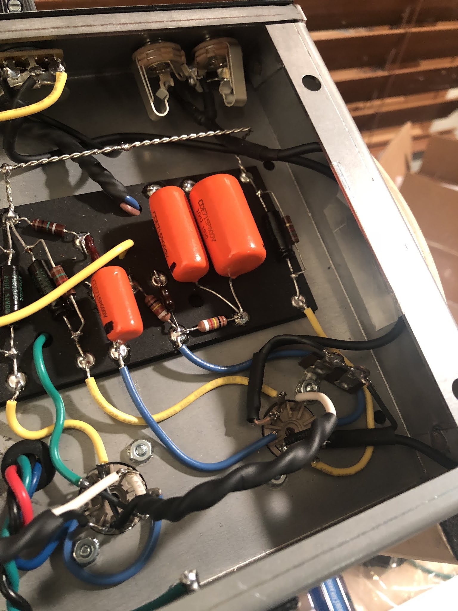

Post by ViperDoc »

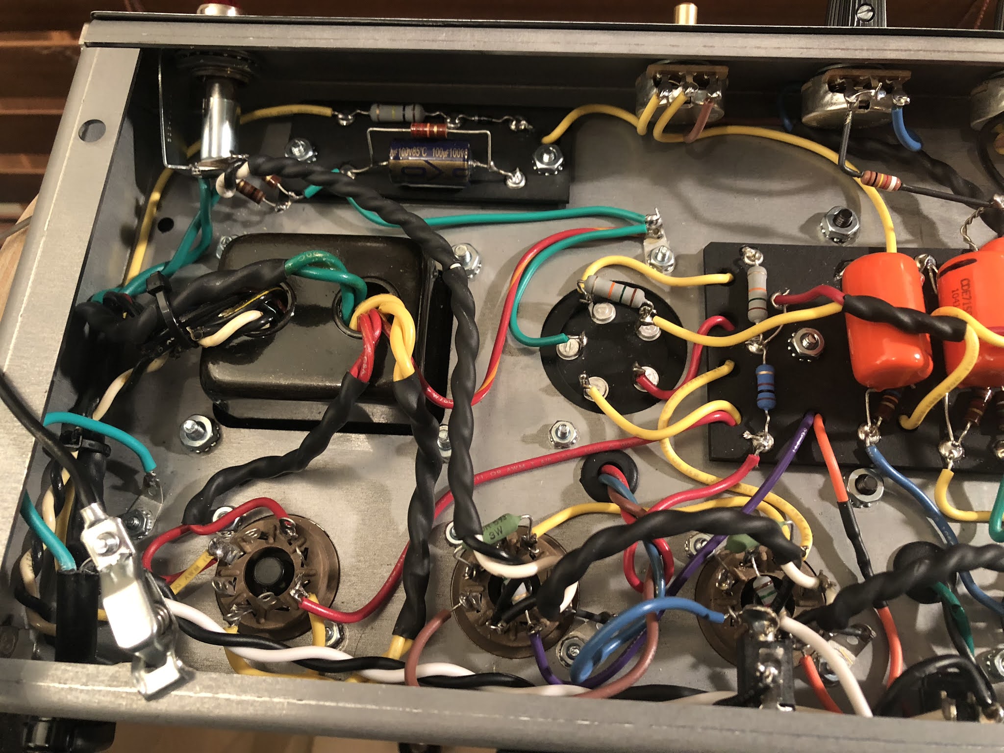

So I "finished" wiring up my Princeton. It's a Mojo kit with a very few modifications, namely 3-way adjustable NFB, a buss wire on the board, a 0.001 uF cap off of V3B plate for a 12-inch speaker, a 470R PI grid stop resistor, 1.5K grid leak resistors and 470R screen resistors on the power tubes, and a ground switch delete. OK, maybe more than a few, but I thought I'd give Rob Robinette's upgrades a nod on this build.
I powered up the chassis and found the following:
1) bulb limiter test passed.
2) Full 121VAC power-up shows 6.3 VAC across all heaters, 350VAC on the PT secondary without tubes
3) Power-up with rectifier tube shows no red-plating.
4) Power-up with preamp tubes shows errant voltages.
5) Power-up with Preamp and power tubes shows 35 VAC on the V1A cathode pin. V1A plate is supposed to be 150 VDC, but it's just over 300. I stopped reading voltages and turned the amp off.
Obviously I've wired something wrong, at least. Here are some gut shots:
The original layout is posted above.
Just plug it in, man.
ViperDoc
Posts: 1247
Joined: Tue Dec 24, 2019 2:21 am
Location: Idaho
Re: Princeton Reverb and Adjustable NFB placement/routing
Post by ViperDoc »
I think I just found my problem...
Regardless of how much effort one takes to install a grounding scheme, unless it's actually *grounded*, well...
I wired up my inputs last and forgot to ground the buss wire to the jack. I wired the buss up to the jack and problem solved! The amp sounds pretty good!
I still have to wire up and install my reverb tank.
I notice the tremolo sound is a) incredibly fast, and b) barely noticeable even when the intensity is cranked. I don't mind a mellow tremolo sound, but this particular version out of my hands doesn't sound all that useable.

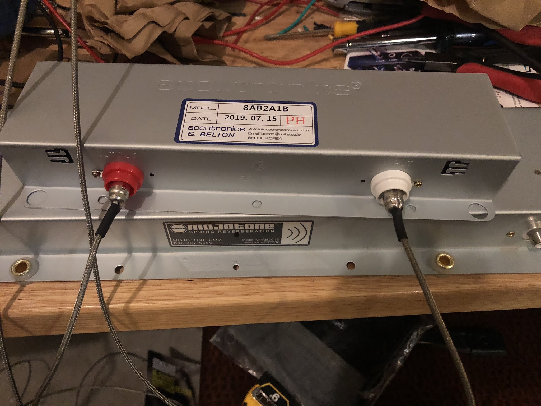

ViperDoc
Posts: 1247
Location: Idaho
Post by ViperDoc »
I just bench tested the two reverb tanks I picked up: the stock 4AB3C1B long, 2-spring tank and an alternative 8AB2A1B short 3-spring tank. All I can say is WOW. Tube reverb, who knew! The short, 3-spring tank is going in the combo, no doubt. The long tank becomes aquatic after about 2.5 on the knob, and while the short 3-spring can get there, it sounds much more musical even in the higher ranges. What a great sounding reverb. I've been testing it through a Warehouse ET-65 1x12 extension cab and it sounds really good.
I can also say this amp is utterly and completely silent except for a bit of noise when dimed. I've marked the foil end on the orange drops on my last three builds and they're all silent. I learned that from some of you here, so thank you for the hot tip. It works.
