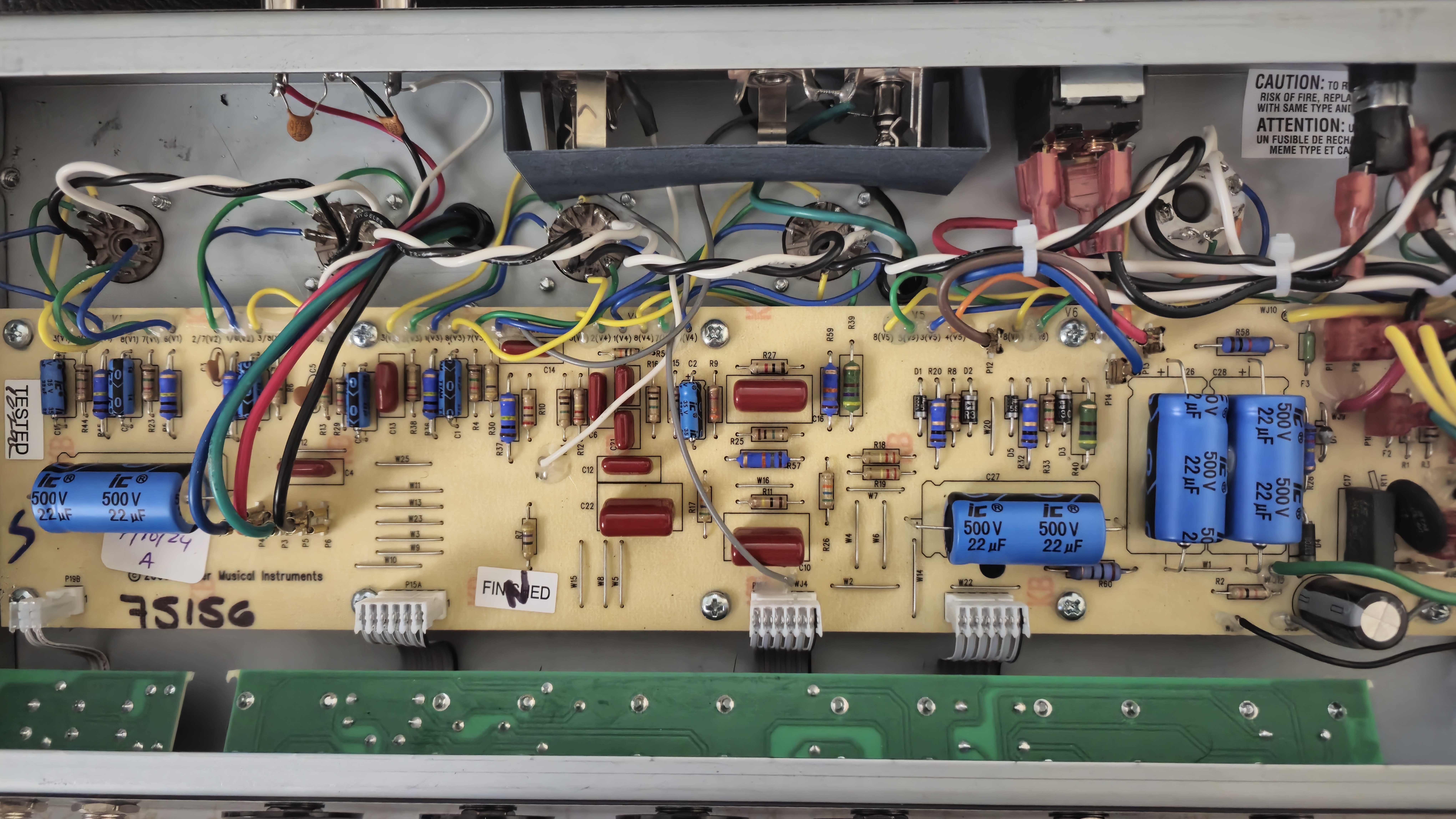

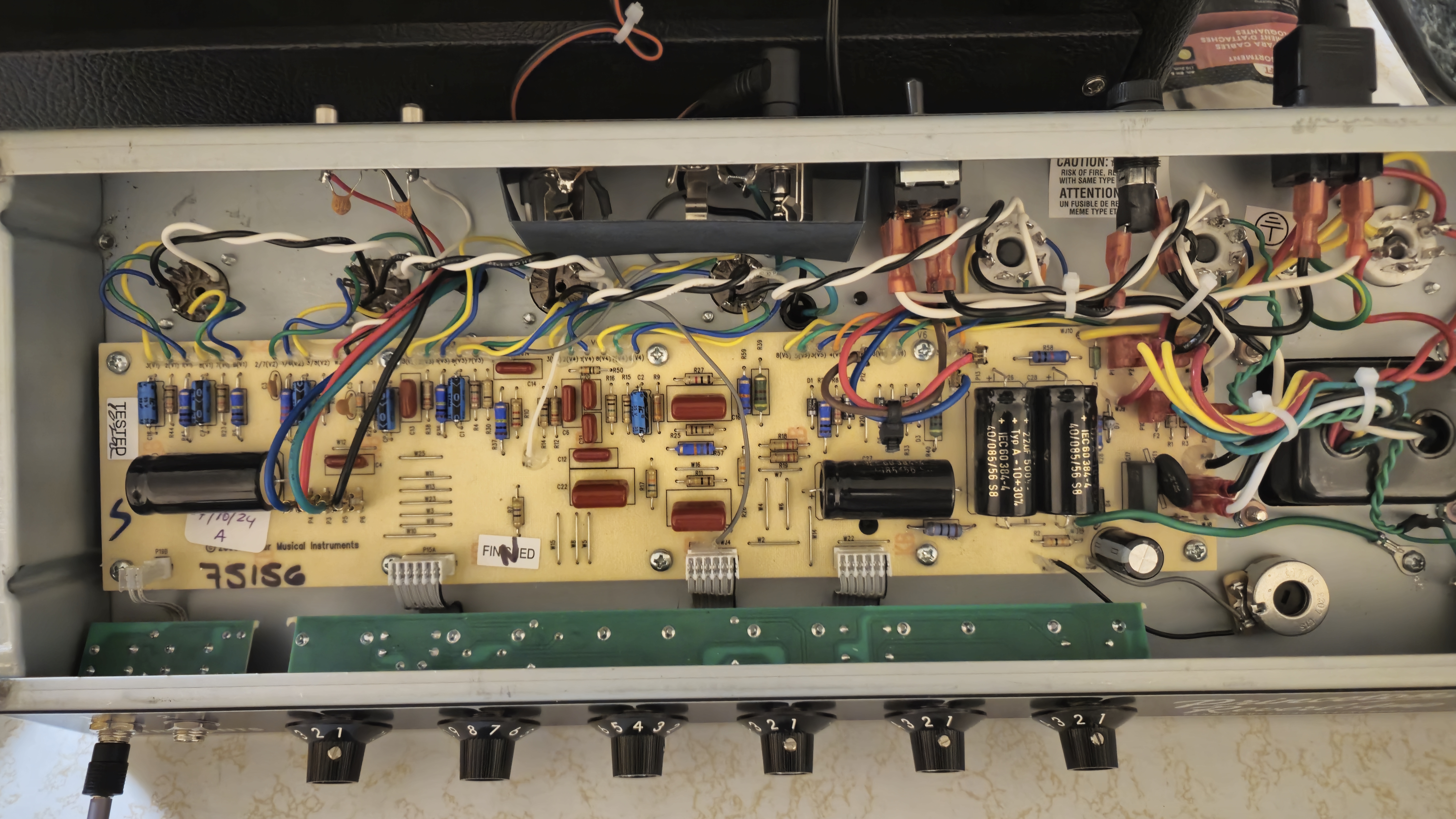

As for lead dressing, here are the before cap job and after cap job pics of the PCB. Things look pretty tight in there... but there may be something obvious I'm simply overlooking.
Before:
After:

You can improve the lead dress in this amp. For each of the preamp sockets, the wires running to pins 1,2,3 can be grouped together, and 6,7,8 also, but try to keep these two groups away from each other.
The grey wire running across the PCB is your NFB wire, I think, but what is the white wire it's wrapped around?
And it looks like the OT primaries (red/brown/blue) are zip tied to the heater wires!! Def separate those from each other. Also try to improve the path of the green OT secondary wire--looks like it's brushing the PI socket and PI pin 3 (yellow).

I attempted to improve the lead dress by following your suggestions, xtian. The grey and white wires running across the PCB are for the footswitch jack. I made a go at untwisting them. I also seperated the OT primaries from the heater wires and moved the OT secondary wire away from pin 3 of the PI socket.xtian wrote: ↑Tue Jan 28, 2025 9:33 pm Right about cap testing. Most meters do not use high voltage to test, and some caps fail only under the stress of operating conditions.
