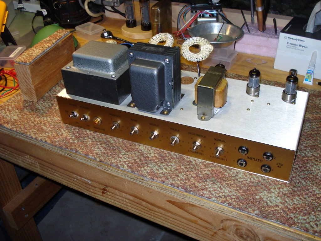

+1000 on the marstran transformers. I used his Radiospares clone and it was the best cleans I have ever gotten. I wired the multiple primaries to the voltage and impedance switches so I could experiment the effect of using different primaries with different tubes. I tried the 6k6,8k, and 9k with 5881, el34, and 6L6. It was surprising to me how subtle the change in tone was between them. If I had to choose a favorite it was the 6k6 primary with SED 6L6. Mustards are actually worth the hype and sound better to me than the sozos. Wish I still had this build but in a fit of wanting to build another I sold it north of the border.

Now that's a Marshall clone! Gorgeous, original looking cab - BB tweed and brown cloth and piping!!!
