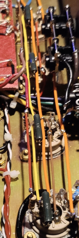

Just fired up the plexi-style build that the generous members here helped me design (https://ampgarage.com/forum/viewtopic.php?f=6&t=36339). Still needs tweaking, but I'm overall very excited that most things seemed to work as-planned. I ended up making a 1968-9 lead spec 50W with some changes to help with versatility. Namely, it has a switch for 33k or 66k slope resistors, bright cap (100pf or 4700pf), and 0.68uf or 2.38uf cathode bypass resistor at V2. I almost never jumpered channels on any of the 4-holers I've had, so V1 is wired permanently in parallel with similar values as a typical lead-spec bright channel (56k plate resistor). One of the switches on the input jacks was wired to take a 1.5uf cathode bypass cap in and out depending on which input you select (sort of like having a "fat" channel and a "bright" channel). Getting rid of one of the channels let me put an Orange-style FAC knob so I can pick from 47nf, 24nf, 16nf, 9nf, 4.7nf or 2.2nf coupling capacitors at V1. It also has a 3-way switch for screens and reservoir cap values (16uf or 32uf and 50uf or 100uf, respectively). The last signal path changes are adjustable negative feedback using a 250KL pot in series with a 33k NFB resistor and a 470nf presence cap (typo when ordering parts led me to be short one 100nf cap, so it's what I had on-hand. Still going to give a try for kicks). I also used a Fender-style bias circuit since those tiny trimmers make me nervous (plus the chassis mount ones look cleaner to my eye), and the B+ rail has a 10K dropping resistor in place of the usual 20K (or series 10K's) to get preamp B+ higher per the advice in the other thread. Overall very happy with the outcome.
Played it some this morning and one of the KT88s red plated (thankfully caught it early, and it seems to be working fine and still biases closely to its counterpart). The bias circuit took a lot of fine-tuning to get the right values for a usable range compatible with KT88s, but all the tweaking led me to forget to solder one of the legs of the feed resistor. Thankfully I crimped it pretty well to the post so I had good bias while testing, but I'll need to actually solder that :oops:. There's not a lot of headroom, and while I was playing it after resetting the bias it made a crackling sound after I started testing the filter cap switch. It's now really low on gain (clean and quiet all the way up, whereas it had more gain than I wanted on 4/10 before the incident). So I'll need to track down what happened there and fix that. Thankfully no burning smell or burnt-looking components, so that's a start. Then I need to figure out how to get more headroom. Target number one is V1's plate resistor -- going to try 47k rather than 56k to see if that gets me where I'd like to be. If that doesn't do it, I currently have a 1k cathode resistor on the V2 gain stage feeding the cathode follower; I might try 1.5k to after that. If I need to keep going from there, I'll need to think through next steps, since I'm not sure how best to get more headroom.
The "fat" channel is very dark and quiet, so I suspect I'll need to revisit how I wired my input jacks to switch that cathode bypass cap in and out (might end up using maxkracht's "cloacal" input jack trick using a stereo jack. I suspect some weirdness is happening with signal getting bled to ground there. I am slightly frustrated that my B+ seems lower than I anticipated with 440V at the plates. I used a Mojotone-spec JTM45 power transformer, which I originally anticipated would put me closer to 490V, but I'm going to give this one a shot before I consider swapping the PT. The big OT in the picture is a 1202-132 style unit with adjusted secondary ratios to let me present a 3.4k load (basically made the 8 ohm setting 16 ohms, the 4 ohm setting 8 ohms, etc.). Phil at Heyboer was great at helping me get this transformer built.

Your lead dress is nice, Mike! But many of your solder connections look dodgy. Make sure you apply enough heat to the turret FIRST to get solder flowing (wicking) to it, then apply heat to the component lead(s) also, and fill those turrets with solder. Same for the pots, and other points of connection.

xtian wrote: Fri Oct 27, 2023 12:34 am Your lead dress is nice, Mike! But many of your solder connections look dodgy. Make sure you apply enough heat to the turret FIRST to get solder flowing (wicking) to it, then apply heat to the component lead(s) also, and fill those turrets with solder. Same for the pots, and other points of connection.
Thanks! And I appreciate the tip -- this was my first time working with split turrets (thought it'd be easier trying to thread my wires through the perfboard). I had a heck of a time finding what's an appropriate amount of solder for them -- glad I learned something today! I'll go back and fill those turrets up when I get back working on it. Here's hoping all that crackling was just a cold joint!

Cool amp! I've built/modded a few Marshalls and a Super Lead is my favorite amp. I agree with above about the solder joints. But be careful not to overheat the wires or the insulation will melt and look like crap. Put the tip of your iron on the turret (or whatever the most massive piece is) not the wire and let the turret heat the wire last if that makes sense.
I think building these 'All access' Marshalls with switches for everything is great to hear the difference all these tweeks can make. There is no substitute for hearing it for yourself. But having done all that, my last and favorite build was a 'mostly' stock '69-spec Super Lead with some EVH tweeks and that's it. I was going for the EVH 12-series thing and a one-trick pony. Push-pull Bright (4700pF) on Bright Volume and push-pull Boost on Normal Volume so it looks stock. The boost is just a 330uF fat cap on V2 820R cathode resistor. In other words, once you get it all up and running perfectly I think you'll find that many of the switches will have one favorite position and you won't need that switch anymore. But you'd never know for sure without hearing it first.

Also, I just noticed that it looks like you have the power tube grid stoppers mounted on the board. Is that correct? If so then I don't think they actually serve the purpose intended. They have to be mounted on the socket in order to work as intended. They should help prevent oscillation. Many Marshalls have as high as 5k6 there. I think I used 4k7 in mine because I was out of 5k6.
EDIT: Here’s one way to do the grid stoppers (red and brown wires to pin 5). These resistors have pretty fat leads so it’s quite rigid.

Thanks so much! I'd love to hear some clips of that '69 build. What iron did you end up using? I think you're right about the "all access" build piece. I almost always run my amps to sound pretty similar, but you're exactly right that I wanted to hear what the different iterations of the circuit sound like. Really fun learning experience. Ironically, I think it's unlikely I'll end up using the push/pulls (bright switch, v2 cathode bypass) or the NFB knob very much after a brief use. I mainly play either rock or country and I do record from time to time, so having the mid cut and variable tightness does seem like it'll be useful.
I'm learning a bunch with my goofs on this build -- I had no idea the grid stoppers needed to be mounted at the socket. They are indeed mounted on the board -- good catch. Thanks! How does the different placement impact their function?

cdemike wrote: Fri Oct 27, 2023 12:27 pm Thanks so much! I'd love to hear some clips of that '69 build. What iron did you end up using? I think you're right about the "all access" build piece. I almost always run my amps to sound pretty similar, but you're exactly right that I wanted to hear what the different iterations of the circuit sound like. Really fun learning experience. Ironically, I think it's unlikely I'll end up using the push/pulls (bright switch, v2 cathode bypass) or the NFB knob very much after a brief use. I mainly play either rock or country and I do record from time to time, so having the mid cut and variable tightness does seem like it'll be useful.
It's a beast. Its the best Marshall or clone I've ever played. I've built others but this one is just special. I used Mercury iron with laydown PT. The B+ is just over 500vdc when plugged into 120vac but I always run it with a variac, I built it with that intention in mind. The OT is their fatter stack version of their typical plexi clone OT. I had to clock the OT as shown because it was too close to the power tubes the other (tenchnically 'correct') way.
IME, if you run a .68uF presence cap like many 70's Marshalls had stock then that's essentially a NFB control. I like that sometimes too but slightly prefer the 100nF cap.
