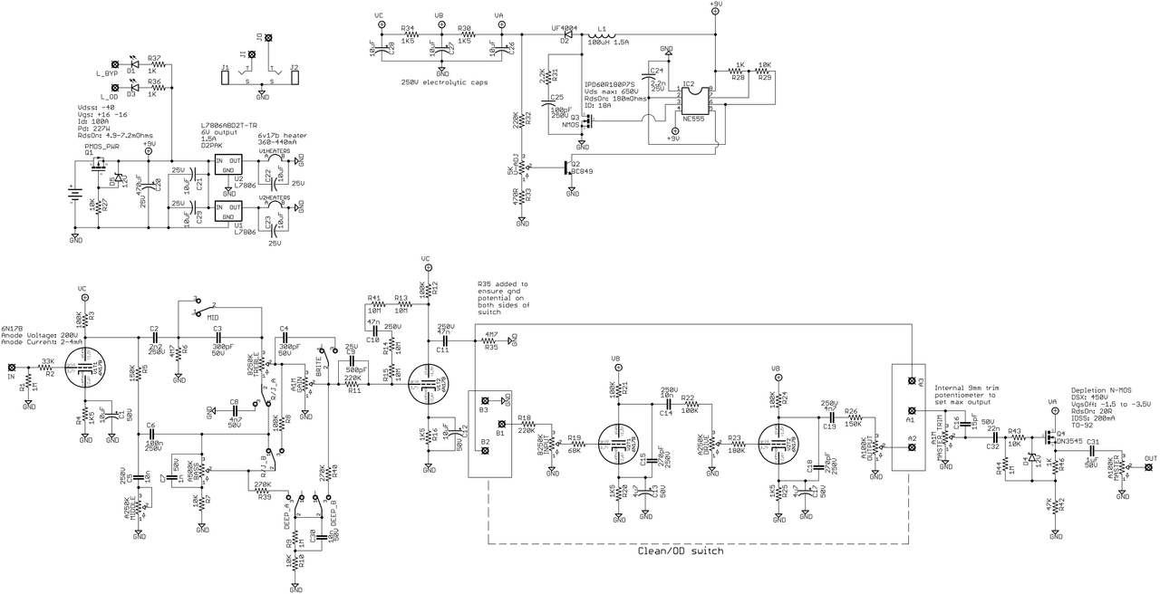

Howdy, guys. I've been thinking about making an ODS preamp in a small pedal format, mostly for use with a cab sim (wife working from home doesn't appreciate the noise).
I'm not really that familiar with Dumbles and the resources here are amazing. I've made a couple tube pedals in the past and was able to put this schematic together thanks to the work done here. Really just looking for any tips, suggestions or picking out mistakes I might have made.
Anyway, the rundown:
Using 6N17B russian submini tubes
Switch mode power supply for HV from 9V OneSpot plug (1.7A)
6V regulators for the heaters (Thought about running the two tubes in series but I think this will be more stable and reliable)
Output Dumbleator-inspired buffer. My idea here is to use an internal trim pot as the 'Master' control, which feeds the buffer with the Master control that will be on the control panel. I figure if I ever need to push a tube power amp with it, I can just open it up and turn up the internal 'Master.'
Thanks!

jubal81 wrote: Thu Jan 07, 2021 4:04 amI've made a couple tube pedals in the past...
Have you successfully run four cascaded stages plus a buffer without any decoupling?

Still learning about the different versions, so I'll definitely check those out. I'm thinking I'd prefer something on the cleaner side, with minimal fizz.
I'm also going to have to recalculate the plate and cathode resistors to account for the lower voltages and gain of the submini tube. The datasheet puts them between 60-88, whereas the 12AX7 is about 100.

martin manning wrote: Thu Jan 07, 2021 12:17 pm
Ah, good catch!
Something more like this?

jubal81 wrote: Thu Jan 07, 2021 3:52 pmSomething more like this?
That's better ;^) A couple of people have asked about this concept recently, so there will be interest in how it works out.
Looking at the data sheet, 6N17P are similar to 12AX7's (mu is lower, though, ~65 where you are operating them), and in my experience the boost converter circuit will produce around 280V, so you will also have plate voltages lower than ODS levels. Probably the typical Ra and Rk range seen in ODS variants (100k/1k5 to 220k/3k3) will be ok, though.
I would agree with the above comments on ventilation. For each 400 mA heater you have 2.5W plus 1.2W from the regulator, and 0.3W from each plate. That's almost 9W for the two tubes, plus whatever the source follower and boost converter generate; maybe 10W total? I think I'd put some vents in the bottom (and use rubber feet to raise it up a bit), and a few on each side near the top of the enclosure to get some convection going. Placement would be determined by the internal layout. Regarding the vents, Alkuz1961 has a very good point, if they are on the top and you are going to step on the stomp switches you will be dropping dirt into them.

Bear in mind, these sub-mini tubes are not going to sound the same as 12AX7's. I strongly suggest you breadboard it, so you don't waste time, money and materials and not be pleased with the tone.
I have not tried this, but have spoken with those who have, and these tubes have proven to sound (particularly when in overdrive) substantially different than a more traditional tube type.

Good point on the ventilation, guys. I'll add some ventilation on the sides, at least. I'd thought about protecting the interior from dirt and dust (we have 3 dogs), which is why I've been considering using grill cloth on the vents.
FUCHSAUDIO wrote: Mon Jan 11, 2021 4:27 pm Cool concept, I like the layout.
Oh, that's interesting. Hadn't heard that before. My only previous experience with these tubes was using them for a Matchless Chieftain preamp in a 125B pedal format. I had to use a boost to get it to distort, but I didn't notice it sounded different that what I expected from tube distortion. Though I've never done a true apples-to-apples test.
Looking at this project as an experiment to tinker around with at home. If I can't get it sounding good enough with subminis, I'll switch gears. Thanks for the heads-up, though.

Also, when using the sub-mini tubes, your plate resistor values will probably have to change as opposed to values for the 12AX7s.
