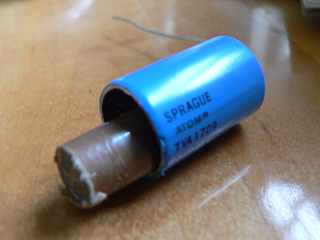

I have heard that before about what is inside of a Atom cap.
Anybody have a picture of that?

Re: Inexpensive Electrolytic Capacitors
Post by jelle »
A cap half the physical size in that nice and shiny big blue housing. :?
Sure:
[img:320:240]http://www.tjadamowicz.com/amps/gallery/SpragueAtom.jpg[/img]

Many times I have heard people complain that the Atoms won't fit under a dog house on a Fender amp.
Most fit. But why bother? There are much better caps at lower prices.
So it doesn't need to be that big of a diameter, why do they do that?
Because old caps were bulky... The TVA line is supposed to "emulate" old-style caps.

BTW, other caps have small innards too. Apparently these caps expand when they heat up.
Quality caps are filled to the case, as proper coupling between the innards and the aluminum can is required for proper thermal dissipation. That's why TVA caps are only rated for 65 or 85°C.
