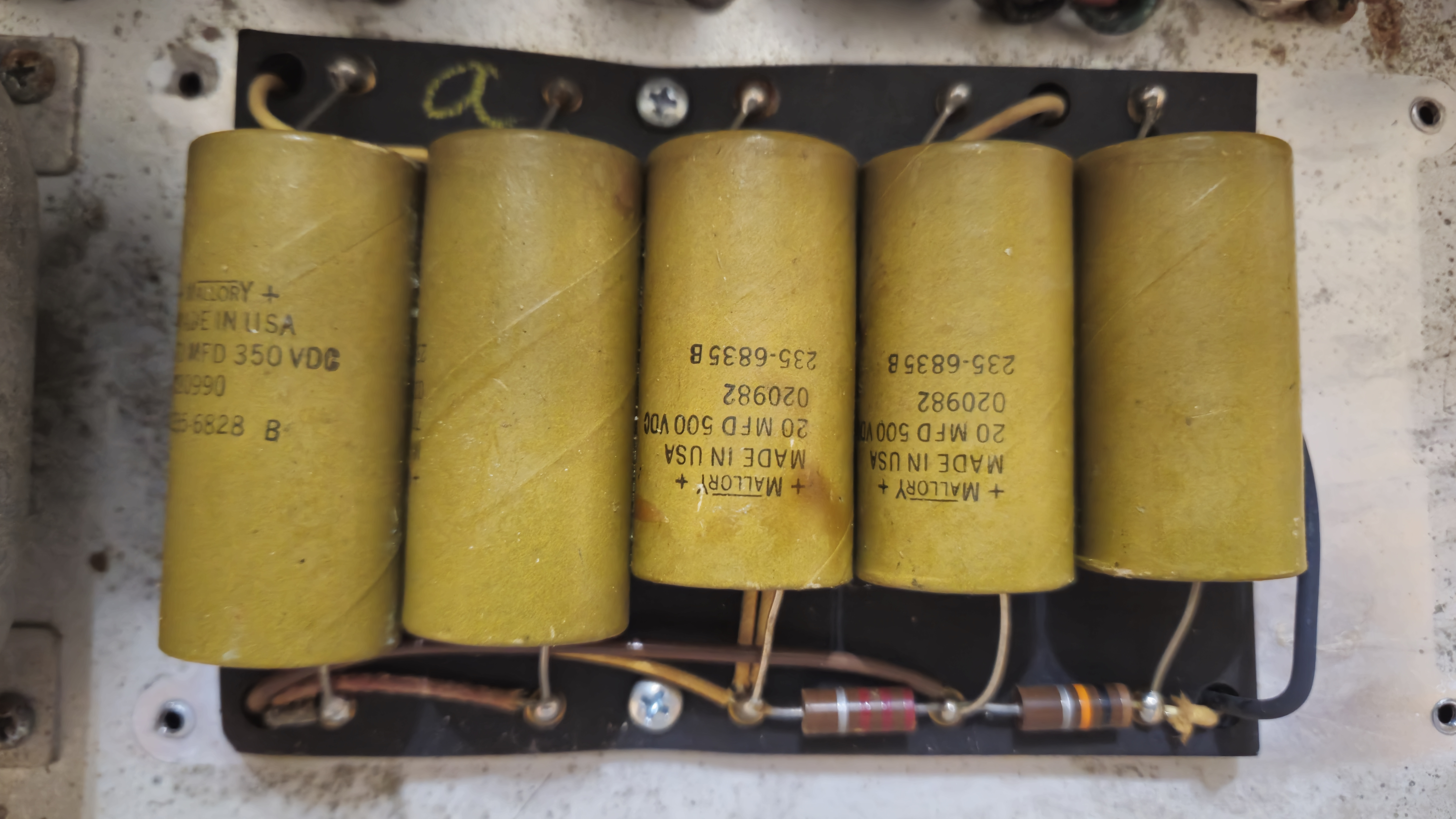

Smitty wrote: Tue Feb 25, 2025 4:14 pm Do you have a method for checking for leakage?
I do NOT have an easy or simple method to check for cap leakage - as far as I know, I have to remove the doghouse, discharge the caps, disconnect a cap lead and test the cap for leakage. I'm sure there's a simpler way I'm unaware of. Your knowledge here would be GREATLY appreciated, again, sir.

That's the way I do it. I use a 1K resistor on the negative lead and convert volts to milliamps. You could probably live with a mA of leakage if you were desperate for vintage mojo.
If you've got the preamp tubes out you can measure the leakage of the last two caps across the dropping resistors. I suppose you could do the same across the choke. Math is your friend.

AC568 Definitely Needs New AC Filter Caps
Post by sssmoka »
Opened the doghouse this morning. It's time for caps...
At least one is leaking electrolyte! As such, I'm rather sure it, and possibly others, are leaking current, as well...
I'll report back once I get those nice, new F&Ts in there.

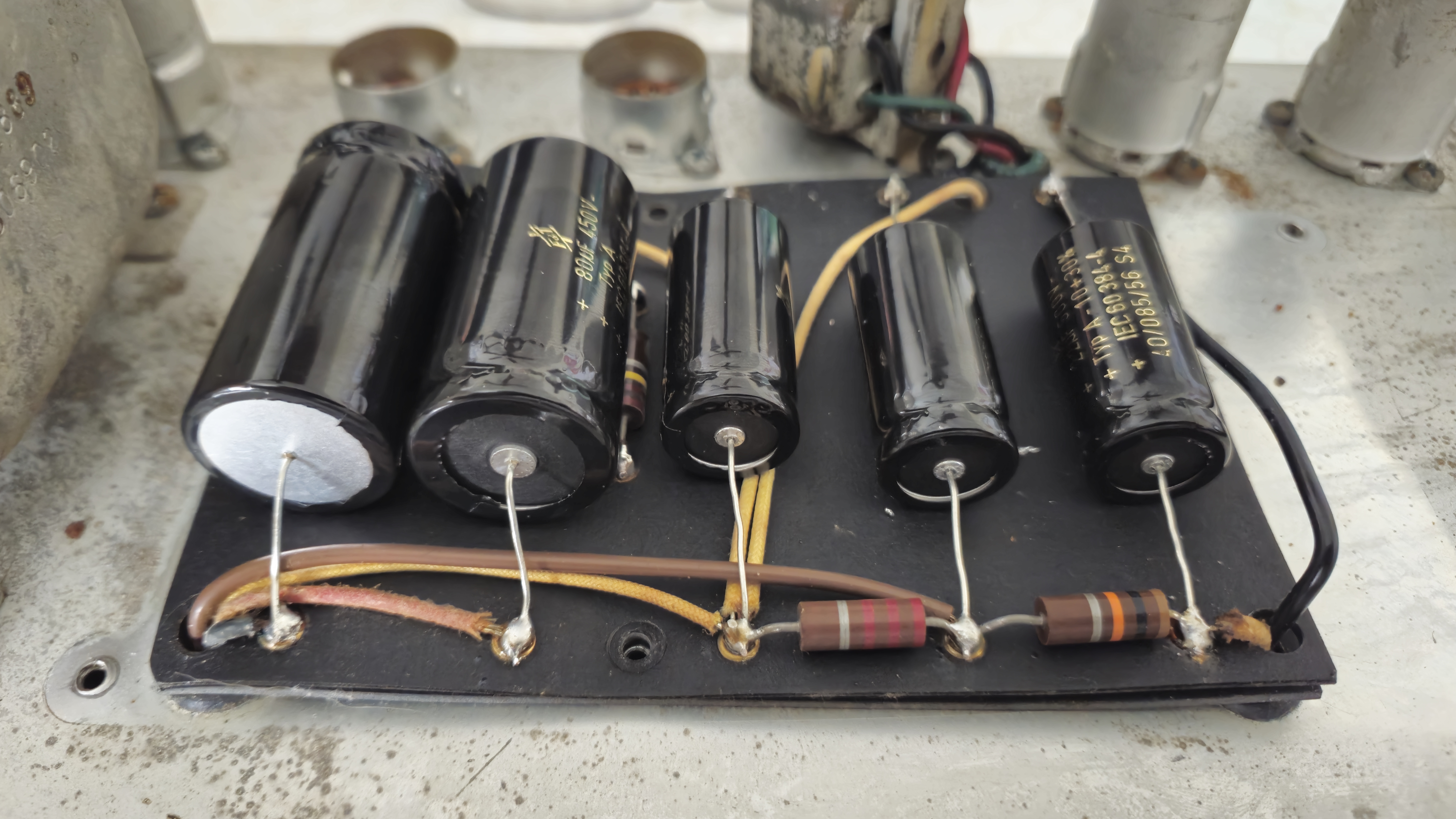

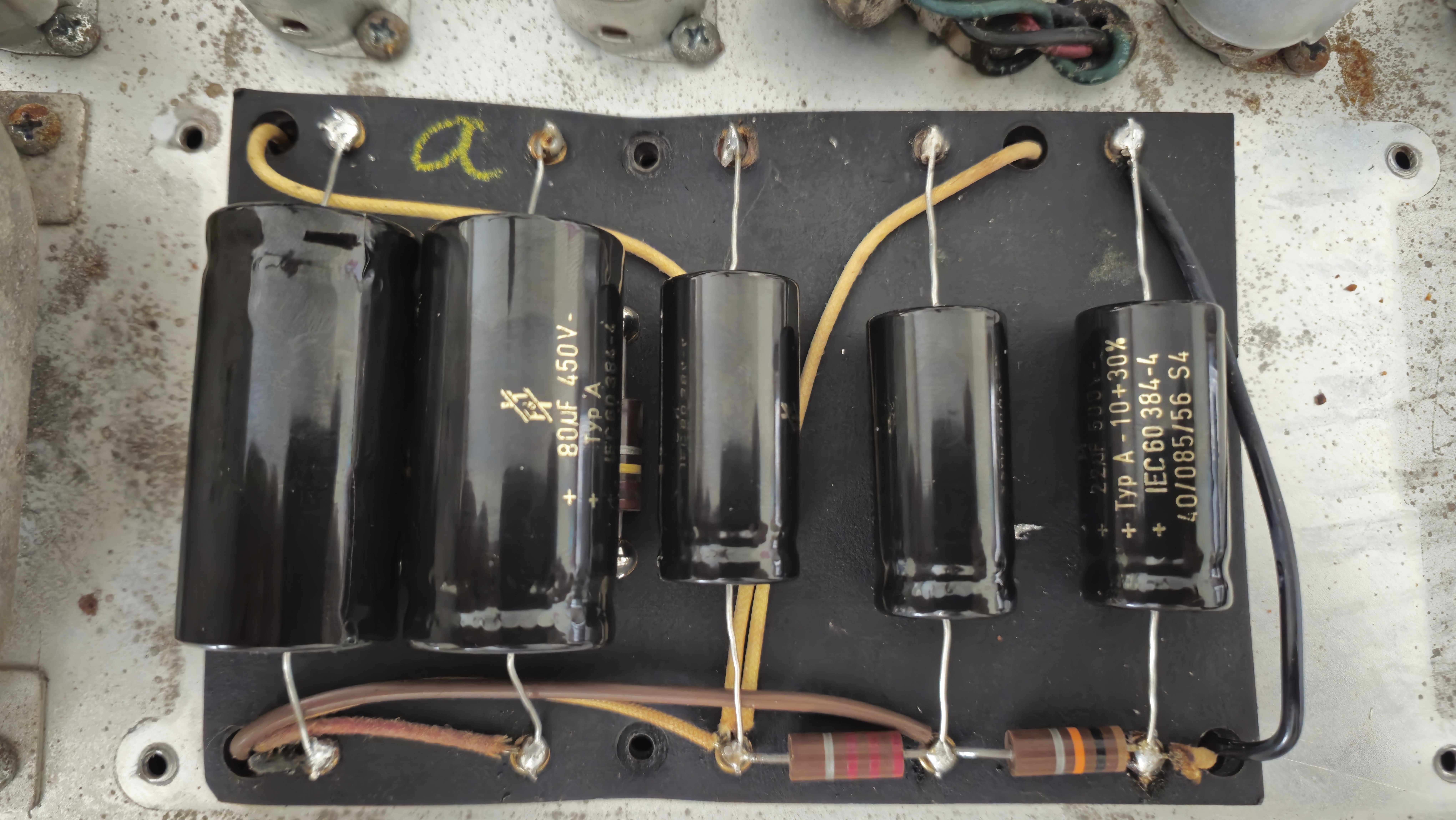

New F&T AC Filter Caps Installed
Post by sssmoka »
F&T AC Filter capacitors installed.
- sssmoka

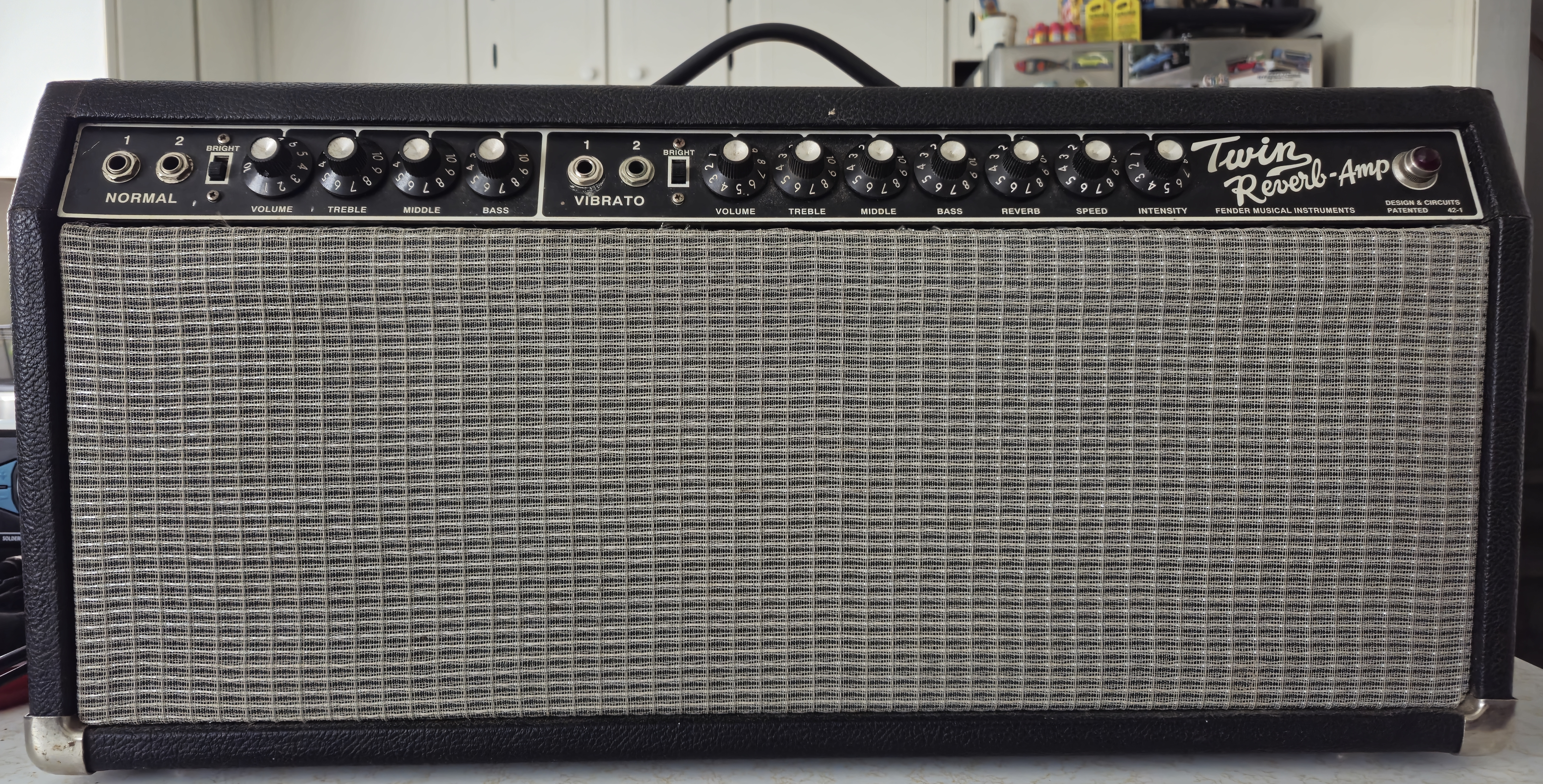

D'oh! I sent the Twin Reverb Amp head home with its owner, only to discover the Reverb control acting like a Master Volume control. My first thought is Reverb Tank - but I have no idea. Does anybody have any knowledge as to what's causing this? Reverb driver? Reverb recovery? How do I fix it? Thanks all. I appreciate the assistance.
- sssmoka
Smitty
Posts: 295
Joined: Thu Mar 16, 2006 3:35 pm
Location: St Louis
Re: Bringing life back to a 1969 AB763 Twin Reverb Amp
Post by Smitty »
Have you validated this condition or is this what the owner is reporting? Your last pic of the chassis does not show that the reverb mixer has been modified. I can't see the pot, but if it is connected according to the schematic it would be very difficult for it to act as a master volume--even if it failed.
