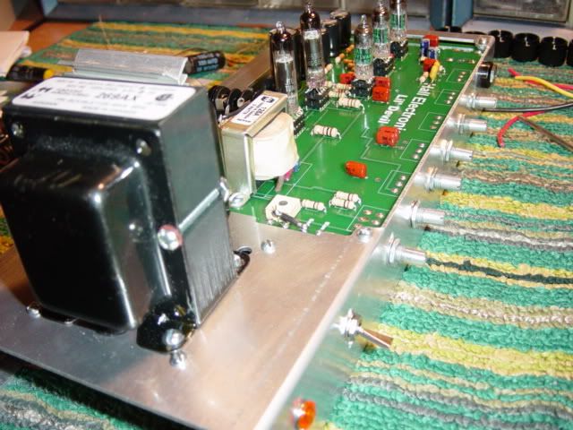

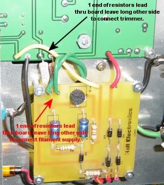

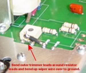

Here is what I did with Dana's help.
The 1.5 ohm resistors are not needed if your filament voltage is OK.
Mine was up at 7.1v with the original Hammond PT so I had to drop it with the 1.5 ohm resistors Mouser Pt#:
660-MOSX3CT631RR15J 2@$0.36
The trimmer pot is a 200ohm single turn Mouser Pt#:
594-63X201 $2.37
The trimmer is across the filament wires/wiper to ground.
[IMG:336:378]http://i405.photobucket.com/albums/pp13 ... wiring.jpg[/img]
[IMG:300:253]http://i405.photobucket.com/albums/pp13 ... erside.jpg[/img]
[IMG:640:480]http://i405.photobucket.com/albums/pp13 ... C01649.jpg[/img]
Hope this helps. :)
Gary
