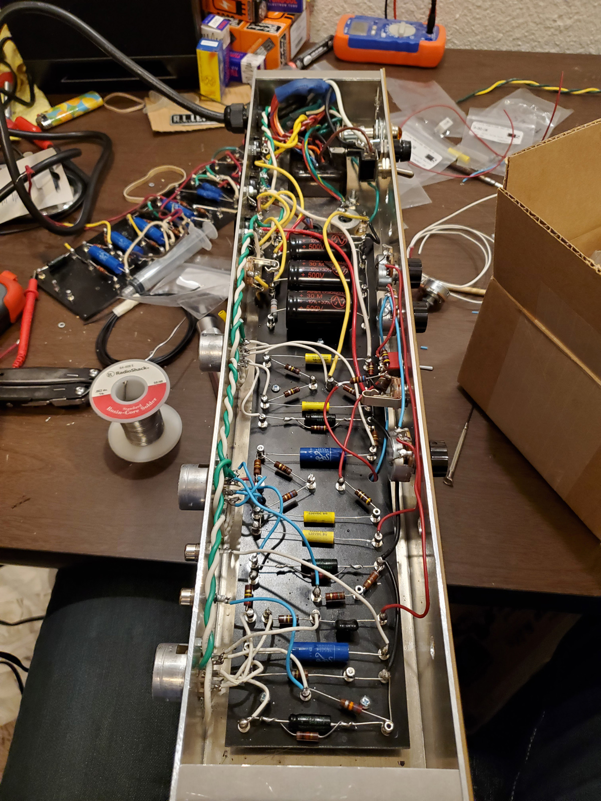

I had the amp back again to double check the power supply, and I did trace it wrong. The 10k is from the B node, not the A node as on the schematic.
Pic of the pre amp.
Aaron
BobL
Posts: 36
Joined: Thu Feb 04, 2021 3:17 pm
Re: Benson Monarch
Post by BobL »
Aaron wrote: Tue Feb 16, 2021 11:17 am I had the amp back again to double check the power supply, and I did trace it wrong. The 10k is from the B node, not the A node as on the schematic.
Pic of the pre amp.
Aaron
This, correct?

Got my board based build up and running - really nice sounding circuit! Has a really nice natural compression when clean - I find that most amps clean I need some sort of low drive over them to compress a little and keep them from being too punchy and spikey, but I think this would do great on its own. I think I'll move the input down to the end, but otherwise pretty happy with it.

I went with the transformers I had already gotten to build the 6G3 - Classictone 40-18028 PT and 40-18090 OT, which are a bit overpowered vs what was here, but worked well. I used a 5Y3 (non GT) on the 300V leads from the PT and I was nailing voltages vs the schematic pretty dang close. The amp is maybe a little on the dirty side, but sounds really nice...

Hi Dan,
Power transformer was a Mercury Magnets Tweed Deluxe
Output was Classictone? Tweed Deluxe.
Thanks,
