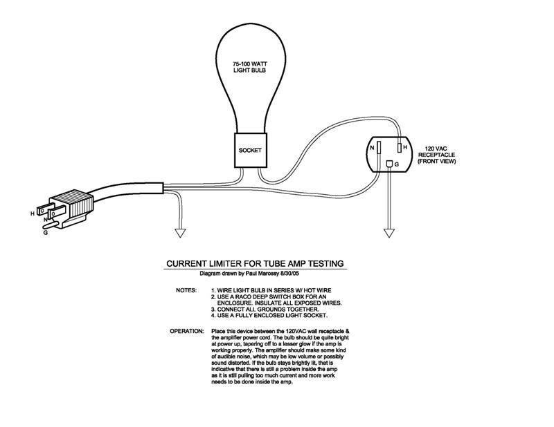

Double and triple checked everything and it looks good. any comments as to what I should do before I fire up this bad boy?
Re: My first build, What should I do before thuning it on?
Are you going to use bulb limiter or variac? Just take it slow and easy.
i don't have either.any sugestions?

Above is the address to the Build guide in the Trainwreck files section of this forum. Start at page 44 and read on. It will explain how to build a bulb limiter and how to use it properly. I wouldn't suggest throwing the switch without using this method unless you are a gambler and don't mind losing some tranformers and / or caps.

Build one of these and start with a 25w light bulb.
[IMG:800:618]http://i23.photobucket.com/albums/b392/ ... imiter.jpg[/img]
If it passes the first step, install a 75 w bulb and try it again.
If it passes that, plug it into the wall and make some noise.
Be sure to always have a speaker connected to an amp if it has power tubes installed.

P.S. After you install the tubes and hook up the speaker cabinet, when you go to check your voltages again with the standby on, touching your tester to some pins of the pre-amp tubes induces a fairly loud "buzzing" noise through the speaker. I always place the amp in standby, then put the tester on the pin and then flip the standby back on. This helps with the "flinch" factor when working around high voltages.
