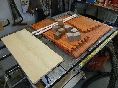

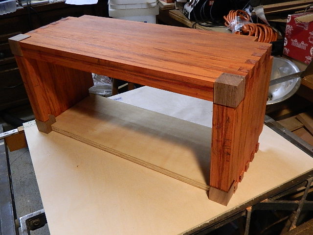

After two days at the Dallas guitar show [bought nothing - thought I was safe] I foolishly ventured into a Sam Ash and saw a model 4210 Marshall. More foolish - I plugged into it. I always wanted a JCM 800 head but the aircraft carrier width always turned me off. The store knocked money off the asking price and like a total fool in love with it's tone I took it home. All 56lb of it - yikes.
Head cab time. I found some padauk and began to plan. I decided to make the head with the same geometry as Marshall used - 1" round overs on the leading edges. Instead of plastic corners these will be walnut, the piping maple.
Here are some progress pics - I expect to start planing, shaping and sanding tomorrow.

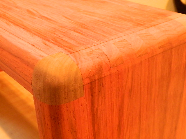

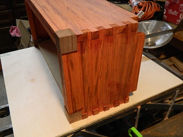

Edge/corner work. After sanding the fingers and corners pieces to a flat plane it was time to start the round over process. Cutting a 45 degree bevel with a table saw was contemplated but screw ups tend to be catastrophic - same for routers. A 1/2" with a hand plane is not all that hard but a 1" was too much. Orbital sander and 80 grit disks to the rescue. Here is the first corner roughed in.
I tried to get some close ups but my camera didn't know what to do with all of the orange but make it neon bright.

Did you cut the bottom ply fingers short and put in individual blocks to show paduk finger joints on the bottom of the sides?
The corner blocks are a good idea. Looks good and using harder material gives corner protection if using a softer body wood. I want to remember that trick.

Thank you for the compliments! I started doing fingers on the bottom ply as it hurts me to 'waste' good wood on the unseen bottom. Plus it is two sets less fingers to cut.

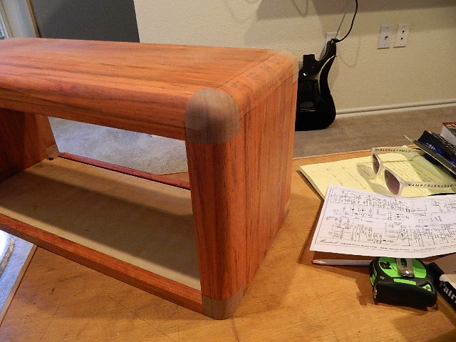

Here is the first slurry sand with 320. I'll work on the face plate tomorrow. I was thinking of leaving the maple 'piping' flat with the face but now I am concocting a blade to shave the bead in and have it stand proud like the normal plastic piping. Some for looks, some as the padauk will stain EVERYTHING.

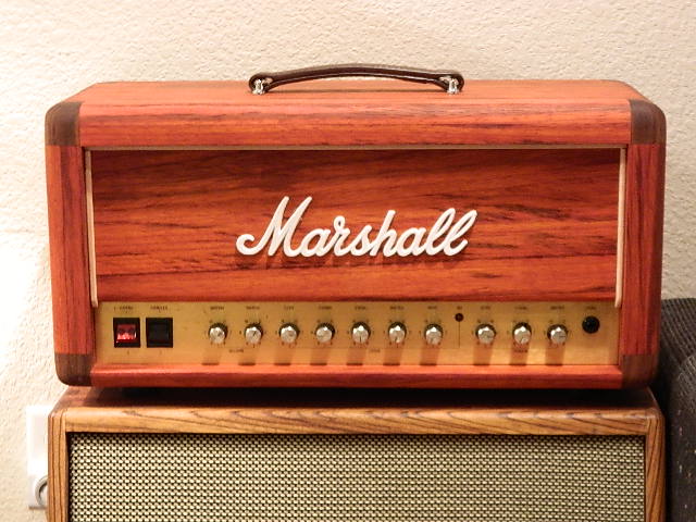

God Bless national holidays and days off! Face plate and 'piping' channels cut. Now to cut the bead into the piping and reduce the face plate to 1/2".

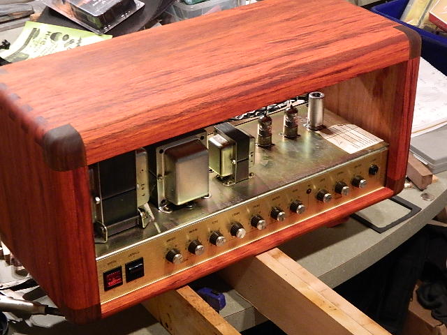

Finished except for the back plate. The scary part is now I'm contemplating a 4x12 after all of the years running away from them.
Happy 4th!

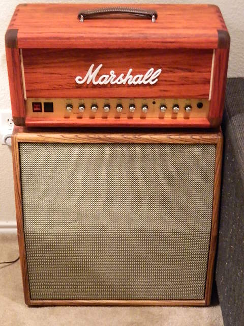

Better Picture.
