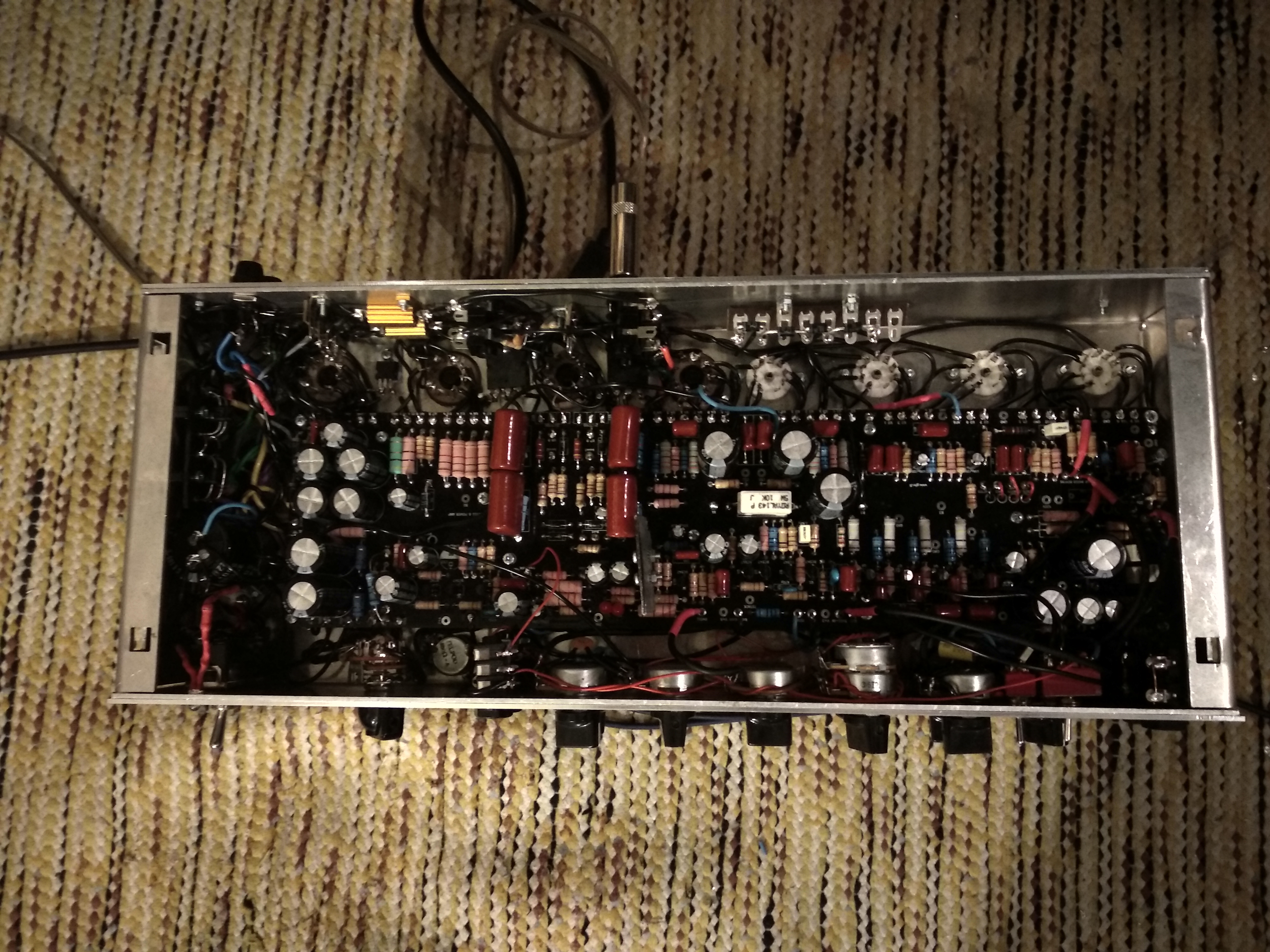

You know...I'm a new builder (hobbyist mostly). I don't know which camp I'd be in, honestly. My Bassman build may look as bad as the Jim Kelly amp to some of you, but I was proud of it as my first amp. I'm very green admittedly, so I don't know everything I should about lead dress, grounding, etc.
To be honest, I don't consider myself to be OCD by any stretch about it. My first goal was to make an amp that worked #1, and sounds good #2. Time will tell. I'm more about function than anything, and consequently I am drawn to simpler amps. Thinking about wiring up a feature laden amp with 12 knobs has no appeal. I think I'll end up being neater because I like simple things.
Here's a shot of the amp I made. I can admit that it looks to be on the sloppy side, but I do hope to improve over time. As a side note, the amp sounds fantastic!

Yeah but everyone has a learning curve fevzay, and even I still think mine are pretty shitty looking and I've made about 10 amps so far, I still notice improvements with each build. OTOH that pedal does look pretty sloppy.
I think the problem is that if people don't know it's that bad inside, and think it's 'great' because it sounds good, they'll buy them and then when the 200$ pedal dies due to cold solder joints or other messy workmanship they won't know why.

Take a look inside some of the old amps. Not very neat at all. Some you wonder how they ever worked.

Case in point. That Jim Kelly amp sounds really really good.
Re: building etiquette
Exactly. Some of the old amps that are coveted the most look like a total rats nest. Of course, they weren't generating the kind of distortion modern amps do, but still.

Some thoughts about aesthetics:
If everything else is the same, it's better to be neat and tidy, both aesthetically and because it's easier to service.
Of course, everything else is never all the same. Aesthetics aside, neatness may or may not affect circuit performance; this is the legend of "tiny parasitic capacitances from wire to wire". The legend holds that bundled and parallel-routed wires can wildly affect sound. This is true - it can. But it's a little like "don't run with scissors". Don't parallel bundle your wires where you have a high voltage or high current signal next to your high impedance wires, notably grid-connection wires. Your amp can oscillate itself to death if you do this. The subtler forms are minor resonances at odd places in the audio range, and an odd "voice" for the amp.
Worse, since it's impossible to be equally and consistently messy, every amp will come out different, even if they have the same super cork-sniffing components, wires and connectors.
This is one area that PCB construction shines. Since all, every one, 100% of amps made with a PCB will have very nearly EXACTLY the same parasitics and so on, every PCB amp will come out about equally good or bad sounding, depending only on the quality of the DESIGN of the PCB, and then component quality, etc. You can still screw up a PCB design, and/or put in low quality parts, but you'll get consistency,.
And neatness.
There is a huge argument to be made for PCB construction in amps; however, they are not easy to hack and modify, and gets the juices going for every DIY amp builder who thinks they can rule the world by using unobtainium resistors and polishing the wires with Armor-All, or whatever. Boutique amp makers hate PCBs because they come up with their gems the same way the DIY builders do, and in general don't have the ability to turn around test PCBs easily and quickly, nor the volume to justify PCBs. Techs don't like PCB construction because frankly, most of the PCBs they've had to work on were designed by PCB designers that have no clue what a guitar amp's life is like. They have dealt mostly with BAD PCB designs, not good ones.
