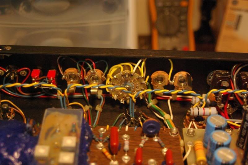

I'm pretty sure this is how to wire the Electroswitch DG40303N
[IMG:800:799]http://i205.photobucket.com/albums/bb17 ... Wiring.jpg[/img]
Anyone see anything weird?

Actually, no.
This is the exact switch used in many recent Dumble amps, like this one:
[IMG:800:535]http://i205.photobucket.com/albums/bb17 ... lector.jpg[/img]
If a connection goes bad on the switch you are talking about, your output transformer is left hanging without a load (ouch!!!). Not so with the wiring accomplished with this switch.

Re: Electroswitch Wiring Diagram
This is a 3-pole switch, so wired this way it is triple-redundant, and if all three contacts are functioning the current rating (per the data sheet) is 1.5A for each contact x 3 = 4.5A @ 28VDC. Even this is cutting it close though, since 100W into 4 Ohms is 5A (at 20V).
This seems to be a common theme from a fail-safe point of view, as you can see in the #124 pictures the PAB and OD DPDT slide switches are wired as two SPDT's in parallel.
Yeah, but thankfully the Hoffman (NKK) switch has massive blades for each section. They'll glow for awhile before buckling and taking out your OT iron.
Assuming the 4-Ohm setting is CCW, something like this?ic-racer wrote:Excellent, thanks for posting I have been wondering about it for my HRM layout. Maybe there is some way I can show this on the HRM schematic.
Without the switch in hand, I was unable to figure that switch out based on the switches datasheet.
MPM
I have been using the NKK in several amps for over ten years, no failures. Better rating also, 6A @ 125V ac.
for guys whos use a switch with just four terminals is there somehing we could put into the circuit to protect our trannys in the event of a switch going bad?
