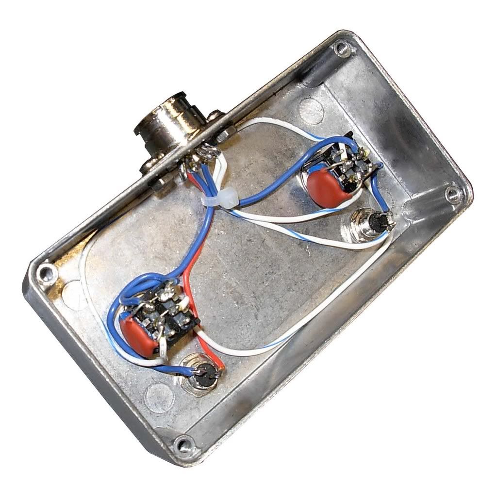

UltraHookedOnPhonix
Posts: 414
Joined: Thu Dec 15, 2005 9:32 pm
Location: Dumbleland
Re: Complete #124 with footswitch
Post by UltraHookedOnPhonix »
I initially posted about the footswitch in this here: http://ampgarage.com/forum/viewtopic.ph ... t=5pin+din, asking essentially how it’s done properly and Gil posted a gut shot of his own. Then, I drew a layout which was verified by Gil.
The Schematic note about no current midi cable working is incorrect, unless I'm reading the note wrong. I've been using HOSA MID-4XX (410, 425 extc.). It has metal ends and all pins are connected.
Oh, it works fine! I subbed the 240-degree 5-pin DIN jack on my Overtone for a 180-degree one so that a MIDI cable works for backups sake. Works great, the cable I’ve tried is a HOSA by the way. I’ve wired up my FTSW just the way described in the original thread with no problems at all. However, if you are building this switch for your Overtone, you’ll have to rewire the OD relay as it is wired backwards! (thanks ic-racer)
Shouldn't that be N/C "Normally Closed"
I originally drew that up, it means “not connected”. Sorry for the confusion.
Here's a pic of my FTSW:
[IMG:1024:1024]http://i205.photobucket.com/albums/bb17 ... n/FTSW.jpg[/img]
